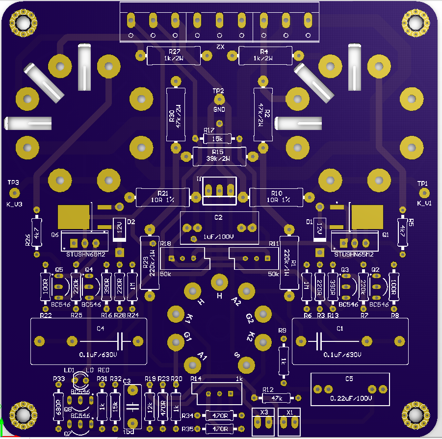

hello guys,
I am noob with tubes so i don't have too much knowledge about this but somehow i designed my own PCB for baby huey amplifier
the winter is coming
) Still remains to design a pcb for power supply and some delay for HV and after that i will send the gerbers to factory. And i need to continue to do more research about tubes amplifiers
This is first revision, still i need to do some optimization.
