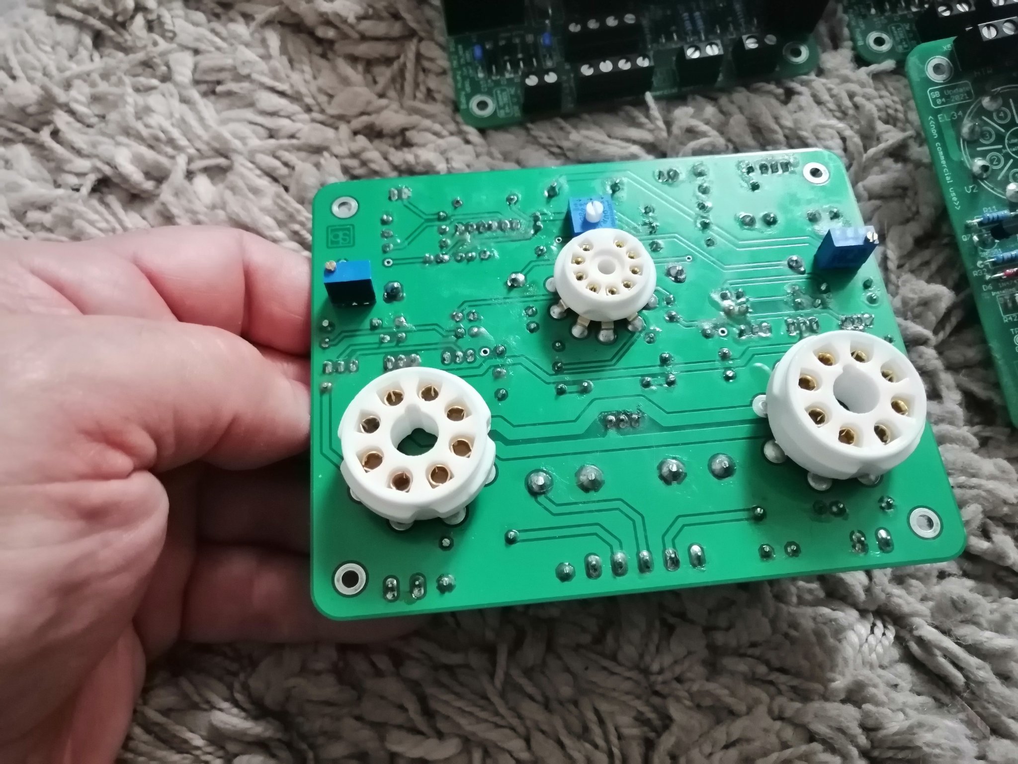

Hi everyone, wanted to ask for a bit of advice on completing the boards. The set I purchased were mostly populated save for the tube sockets. The big capacitors were mounted on the underside of the board.
My concern with that is adjusting the boards later. It would not be accessible from underside of board, I guess small holes would need to be drilled in top cover to accommodate, but don't know if this is practical. I'm thinking to move the big capacitors to top of boards, solder tube sockets on underside. Mount the boards upside down from top cover - tubes on top all other parts on bottom. The transformers for hv and 50v ( two separate) as well as ac-dc heater supplies I think would be mounted on bottom plate. If need to adjust, unscrew bottom plate, tilt back top of amp, adjust. I don't have a chassis yet picked out. Any tips would be appreciated.

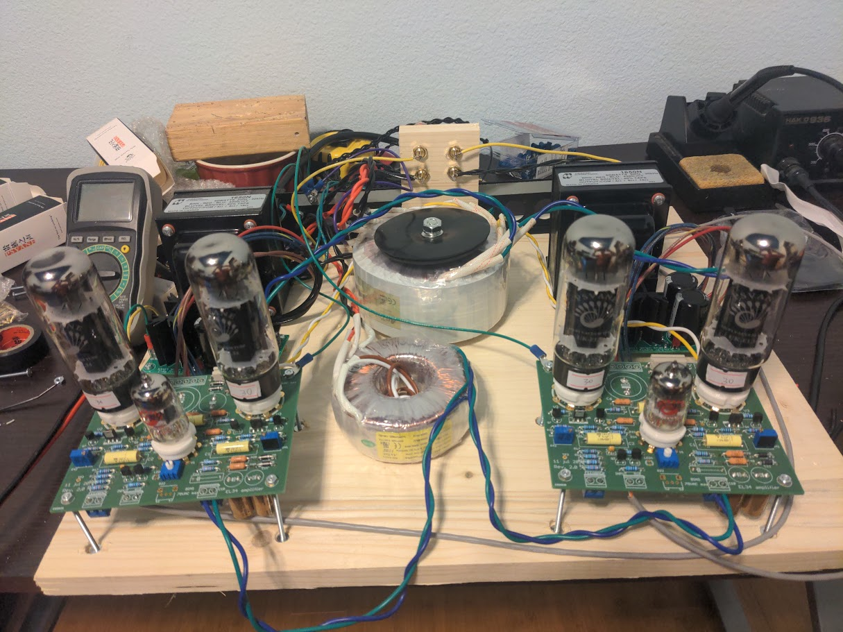

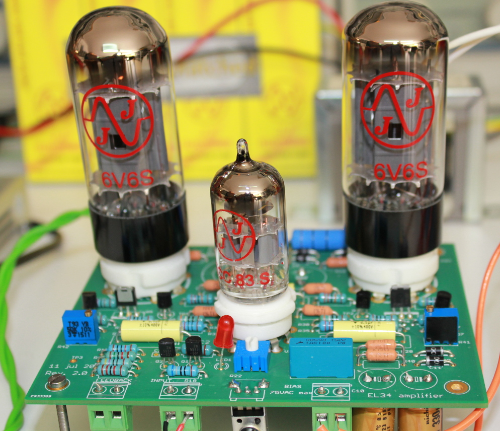

Hi Everyone,
Making some progress on this project. I'm having some trouble getting bias down low enough. V2 & V3 on both amp board hovering in range of 600-700mv. R27 reading 10.6ohms, though I know multimeters are less accurate with lower value resistors such as this. Adjusting trimpots will not get values any lower, I would like to get bias down to ~500-550mv. Using El34 tubes. Any tips on troubleshooting would be most welcome 🙂
Also not successful with the next step, adjusting P5 to get 0V between "inner" leads of C1 & C2, I'm getting ~130V dc.
377VDC across C27, 58V ac at bias input. 6.25v dc at heaters.
Reactions: zoom777
With 370 Vdc on the plates of the EL34 you are fine around 53 mA, so 530 mV across cathode resistors.
Does it change depending on the point you touch the pcb? If so, consider it 10 Ohm in your calculations.
You need to lower the value of the resistor between the diode and the bias trimpot, to have a more negative range available. What voltages do you have now on the negative nodes of the bias?
Set P5 in the middle and report the voltages on both sides of each capacitor.
Reactions: arteom and felixx
Thanks for your guidance, Zintolo. Please see below for my findings.
Yes, between 10.3 and 10.7 ohms.
Would this be the measurement between ground (tp3) and C12? The measurement I got for this is -22V.
C2 - 2.5V
C1 - 123V
My guess is that R8 or R10 have an incorrect value.
After going through all the resistors indeed I found R9, R10 had incorrect values. On the board are 30k resistors, where BOM calls for 47k. Also R13 is 27k, where BOM calls for 39k.
The measurements I posted for R10 and R8 were with multimeter probes clipped on either side of the resistor. Sorry I guess I misunderstood. Measuring against gnd (tp3) for each resistor, I get following readings for either side of each resistor. Sorry if still incorrect.
R10, 307V, 368v
R8 - 307v, 25v
I will get an order going for correct value resistors. I also wanted to ask about CX1, BOM calls for 10nf or 100nf 1000V cap here, what's on the board is unmarked. Should I swap this out?
