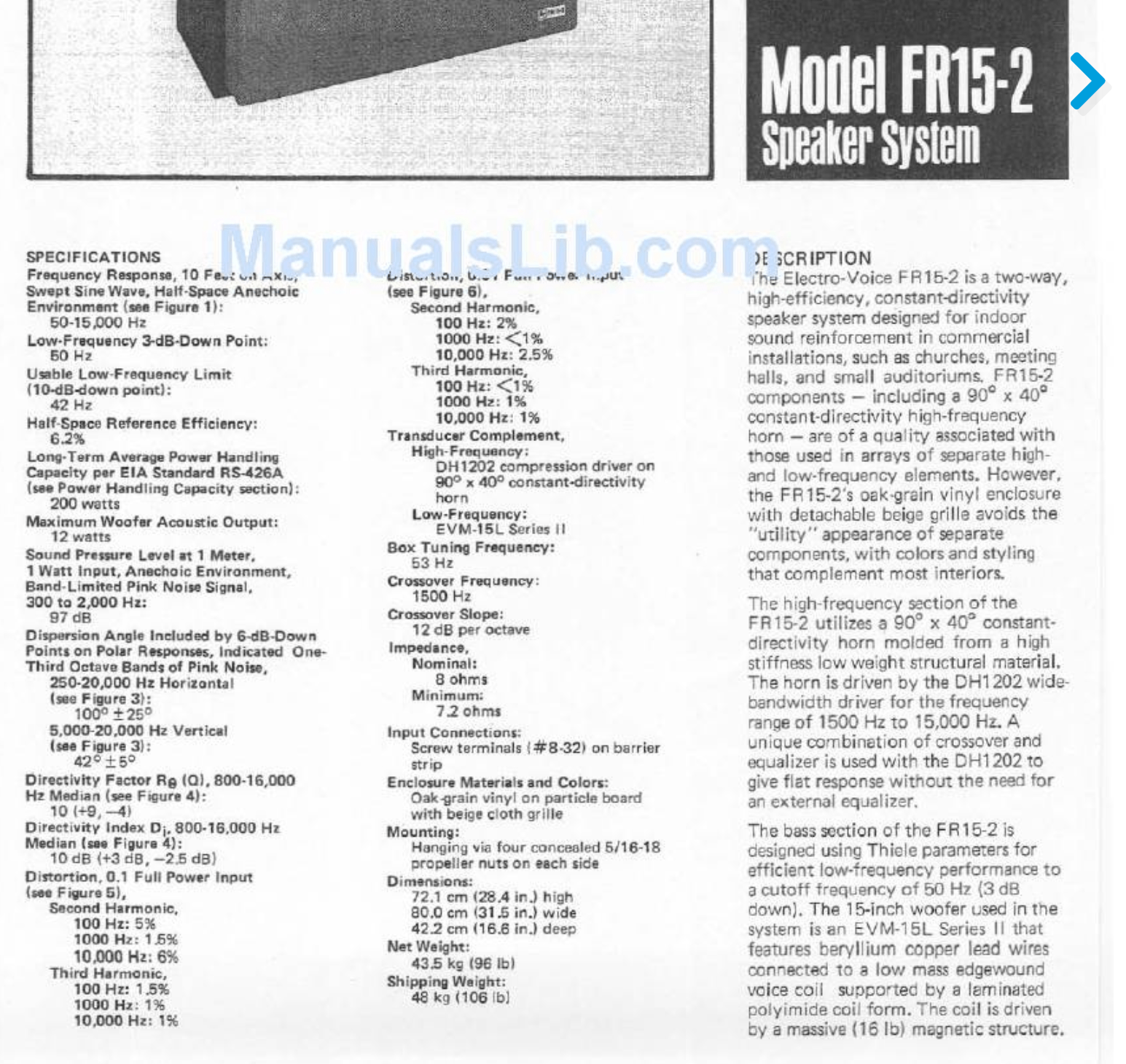

I happen to be running a pair of EV 15W drivers from 60 hz to about 900hz. The EVM-15L looks like the 15W as far as specs go. Just likely the newer version. The 3.3mm Xmax might upset some but it means there is a lot of force and lower moving mass. Good for vocals.
Before the existing setup I tried to go with lower efficiency speakers and just could not make it work.
I think you would need some good horn midrange to match the EVM-15L. The EVM-15L would not reach 2K gracefully to cross to the DH-3 horn. 800 to 1K would be a good crossover point.
As far as amplifier you would want something like a 10 watt class A amplifier for the EVM-15L and horn drivers. You would need to be pushing pretty loud to need more than 10 watts.

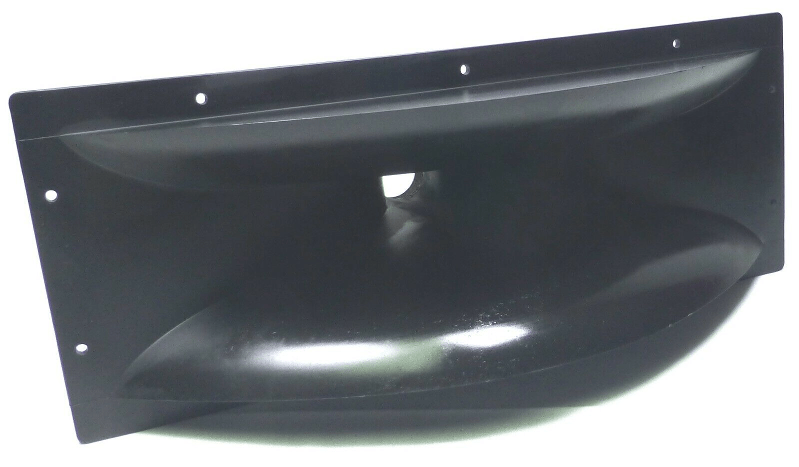

The DH3 horns are similar to this:
Know the dimensions of that horn or the expected cutoff?
Also wondering the size of the room where they will be used?

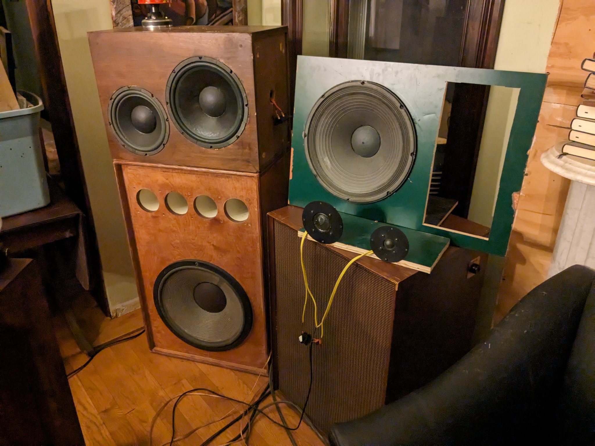

@daqvin_carter I'm all for open baffle. The room is quite small by USA standards, maybe 15x15 (?) feet with 12 ft ceiling. There is an open 6ft x 8ft door to the dining room, which is 15 x 20 ft.
I don't have anyone to bother about sizing . The subwoofers are already 37x24x24 inches, with another 24x14x14 box on top of it. And the horns and some open baffle tweeters on top.

I ran the Karlson gamut but the more I listen to "modern" speakers, the more I';m disappointed. Will likely take the University 312-200 speakers out and open baffle them. Matching them to a modern speaker will of course be quite daunting.
I would choose open baffle if you could keep it three feet from the wall. Otherwise just some truncated sealed box.
If you have he parts for a third order at 1500 hz I would give that a try. You would want about a 7db pad for the DH3. If you are really looking for perfect sound you may want to look into using a tapped inductor on the high pass to keep the dampening factor high.
The room gets close to a cube which could make for some problems around 40HZ or so. Hope the dining room door can be kept open.
