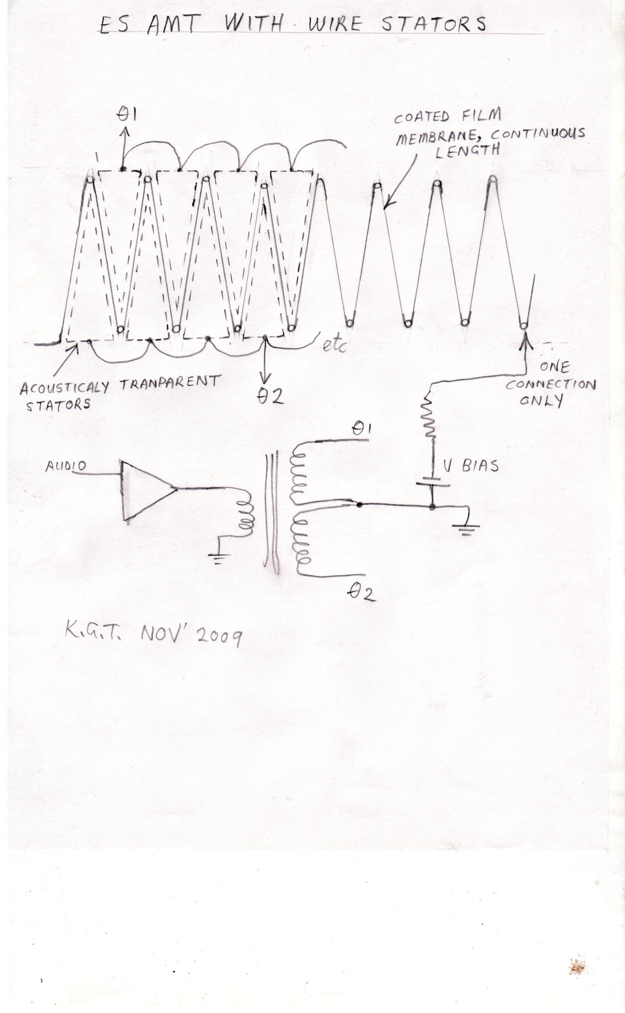

Finally got around to earthing the transformer CT and found the bias stopped arcing over. It later started arcing again which was probably more to do with the weather, today being warmer and dryer than yesterday.
Keith PS, I have a 1.7 ohm resistor in series with the transformer primary to make the amp a bit more abuse proof. I was surprised at the ammount of signal being dropped across it.

One idea I had was . . .

Micheal, thanks for your efforts at putting some numbers to aspects of the project. Maybe you have the available forces quantified but the load they have to move seems the hard part. We are applying the forces to two opposite sides of what Beranek (Acoustics) calls a "box of air". The "box" has one (smaller) side open to the surrounding air and the forces are applied equally to the two larger sides. From what Heil suggests in the AMT patent your high frequency cutoff at lambda/4 seems rather pessimistic and may be based on the idea that there can be a quarter wavelength pressure gradient in the pleat that cannot escape before the audio changes sign, and cancels it.
On the other hand your SPL predictions seem extremely optimistic. What distance are these figures to be measured at? Sorry to be pedantic, but the "T" in AMT is for Transformer, not transducer. I wish I could be more engaged with your work, but as well as not being particularly mathematically inclined, I find myself challenged using/understanding spreadsheets.

Michael, with my construction, where membrane contact is via the posts adjustment of tension is not something I have much control over. If tension is too small we loose contact and it stops working. I would not disagree that your spreadsheet is in need of some debugging. I could be missing something, but when I reduce the audio voltage to zero we are still getting a huge SPL figure!
An AMT tutorial
In the electro magnetic version the pleats are arrayed parallel to one another in space. That space has a magnetic field, where the flux is running parallel to the pleats. Any forces, and subsequent motion due to current being passed through conductors on the pleats will be at 90 degrees to the field. The thing to realise is that each pleat is subject to forces quite independantly of conditions in neighboring pleats. To do any useful work (move air) three sides of the pleats have to be sealed to the neigthboring pleats such that the opening alternates between front and rear. The seal can be as floppy as you like because it does not have to perform any "station Keeping" function for the pleats.
In an ES AMT things are quite different in that the forces are between adjacent pleats, and, in the case of bias; exist continuously whether audio is being applied or not. OK, we know that in the perfectly centred case bias induced forces will cancel. It is just that we cannot rely on it and have to resort to tension. Apart from the necessity of tension the inter-pleat spacing method prevents us from achieving the the air displacement that a floppy seal allows. There are pockets of "dead air" abutting the posts.
A new idea
In the drawing is depicted a stator type ES AMT where the stator has a special shape, and is acousticaly transparent. It could be perforated metal, wire or wire mesh. The membrane pattern is zig zag but the forces over the pleats are more even than if the stators were flat. There should be a lower percentage of air that cannot be moved compared to parallel pleats.
We come to the question of how to view it acousticaly. One way is to note that our "box of air" has become a "wedge of air", where for a given ammount of motion we have a pressure gradient in the pleat opening. For the situation where motor force is marginal perhaps we have a "half way house" between a flat radiator and a pleated one. It could also be viewed as a micro horn. The shape of the stator could mimic the catenary? curve that the pleats may assume to supply higher forces at the edges.
I figure that if you were to put some water in a bath and provide a flat surface below the water you could do the following--. Tape a pair of flat boards (wooden rulers) together at one end and lay them on the underwater surface. Add a polystyrene ball as an indication of fluid motion and move the boards. I think we should see the transformation from high velocity at the apex to a reduced velocity at the exit. Likewise the pressure should be transformed if we had seals top and bottom.
It won't have the acoustic energy per area of a parallel pleated design but breaks the nexus between pleat spacing and motor force? If we look at what is happening at the narrow end of the pleat opening during a compression the motor is not burdened with being a vacuum pump as well as a pressure pump to the degree it would be in a normal AMT. Construction should be simpler than the all moving design with some interesting scope for varying the spacing by bodily moving the stator triangles and altering tension without loosing membrane contact. It seems to lend itself to a more midrange design.

A new idea
Keith
