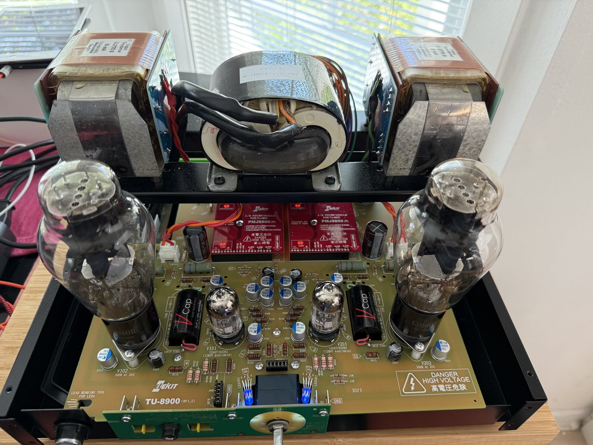

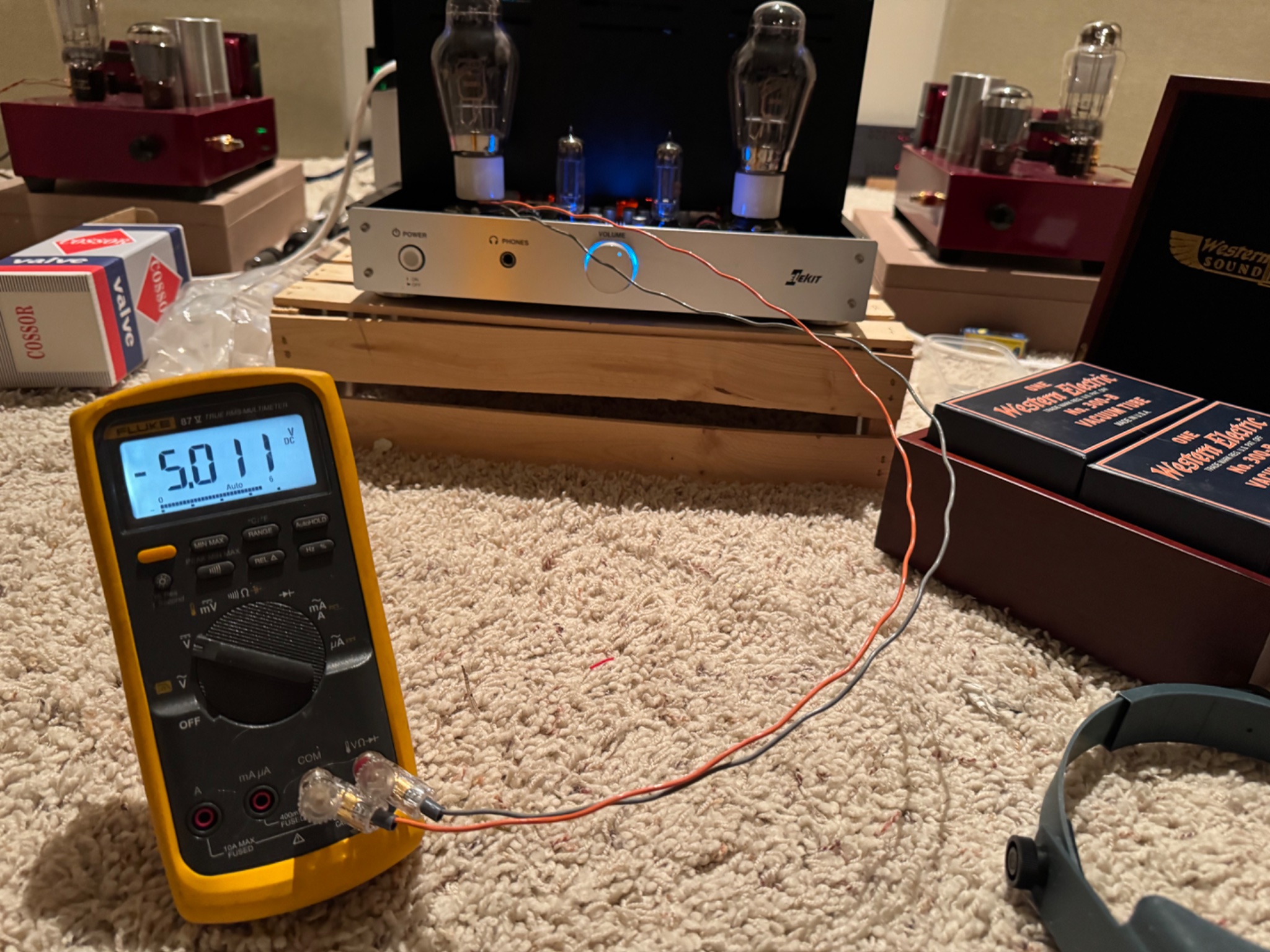

Being anal, I was concerned about our high mains voltage (124V) and how it might affect the filament voltage on pricey 300B/2A3 tubes.
Proper filament voltage is critical to tube life.
Of course, the 8900 has a sophisticated power supply, but I still had to know for sure. I did mention that I’m anal.
The common standard for filament voltage is +/-5%. This was OK when tubes were plentiful and cheap, but far from ideal. EML has an excellent article about this on their website. if you look at the graphs there, you can see that the best longevity from your expensive tubes is attained at -0 to +1% filament voltage.
I measured the 8900s filament voltage (directly at the tube pins) while plugged directly into the wall at 124 V, and then again plugged into bucking transformer at 117 V. The 8900 didn’t flinch at the voltage changes, maintaining the filament voltage rock steady at exactly 5.01 V! Perfect!

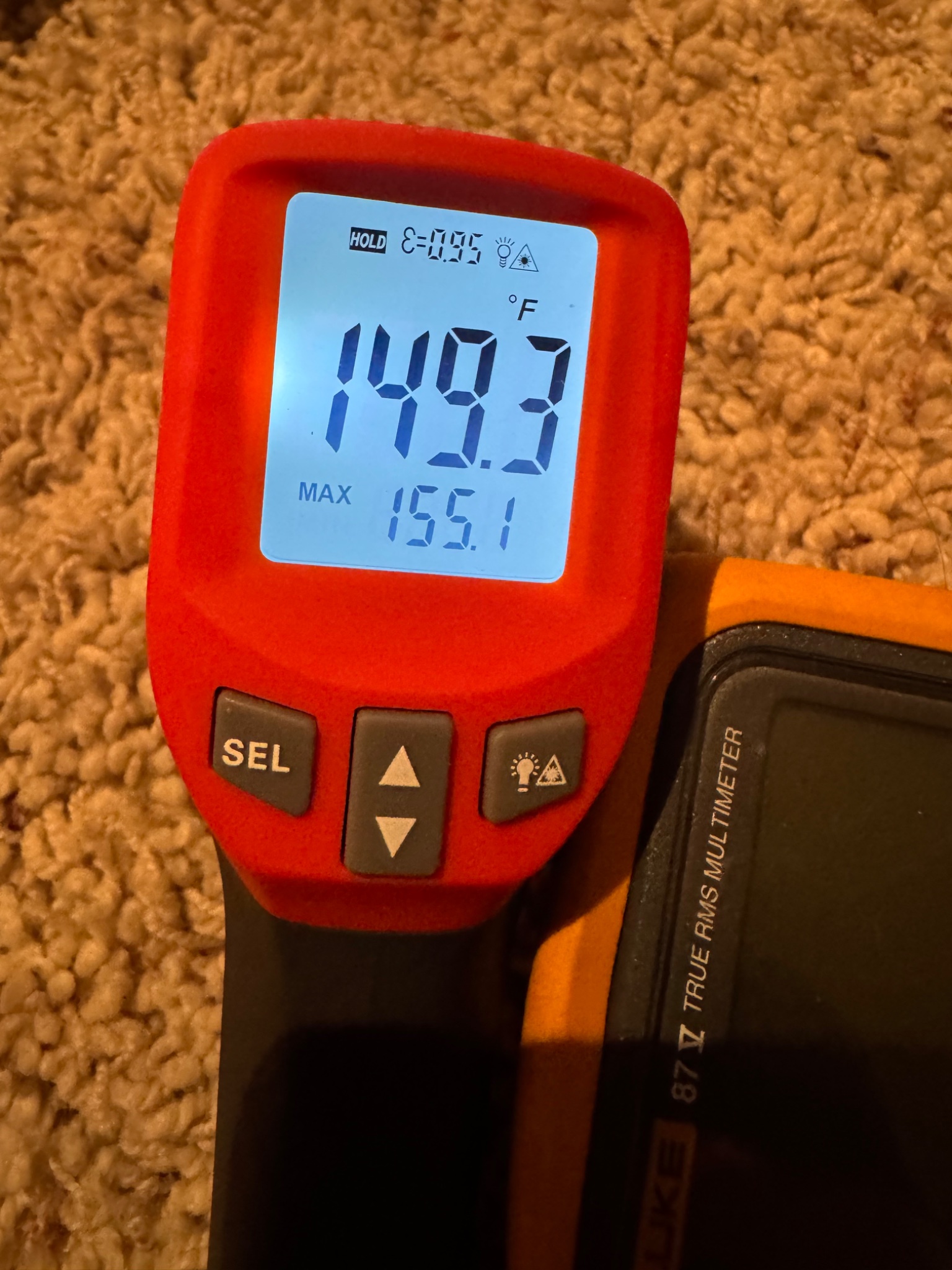

(I will note that, based on my extremely crude and likely inaccurate measurements, the temperature on the power boards increased 2.5°C at the higher wall voltage, but was still well below any reasonable limits for electronic components at 68°C. Photo is in Fahrenheit)
I can now relax and enjoy the music while running my expensive western electrics, and soon to be acquired EML tubes…Well done Elekit!!!
