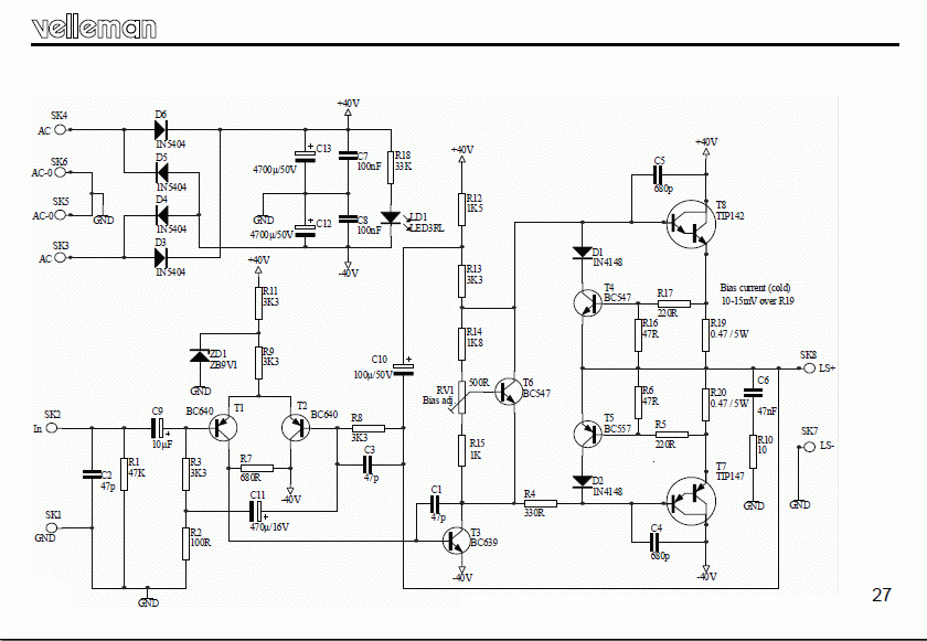

Interestingly the cheapest module (Velleman VM100, Class-ab discreet, 50Euro) has the best signal to noise ratio (100db) compared to the Coldamp BP4078 with mere 79db (120Euro). The Coldamp is much more powerful nevertheless...

Here the schematic of the Velleman VM100 (copied from the UserManual, available on the Velleman site):
