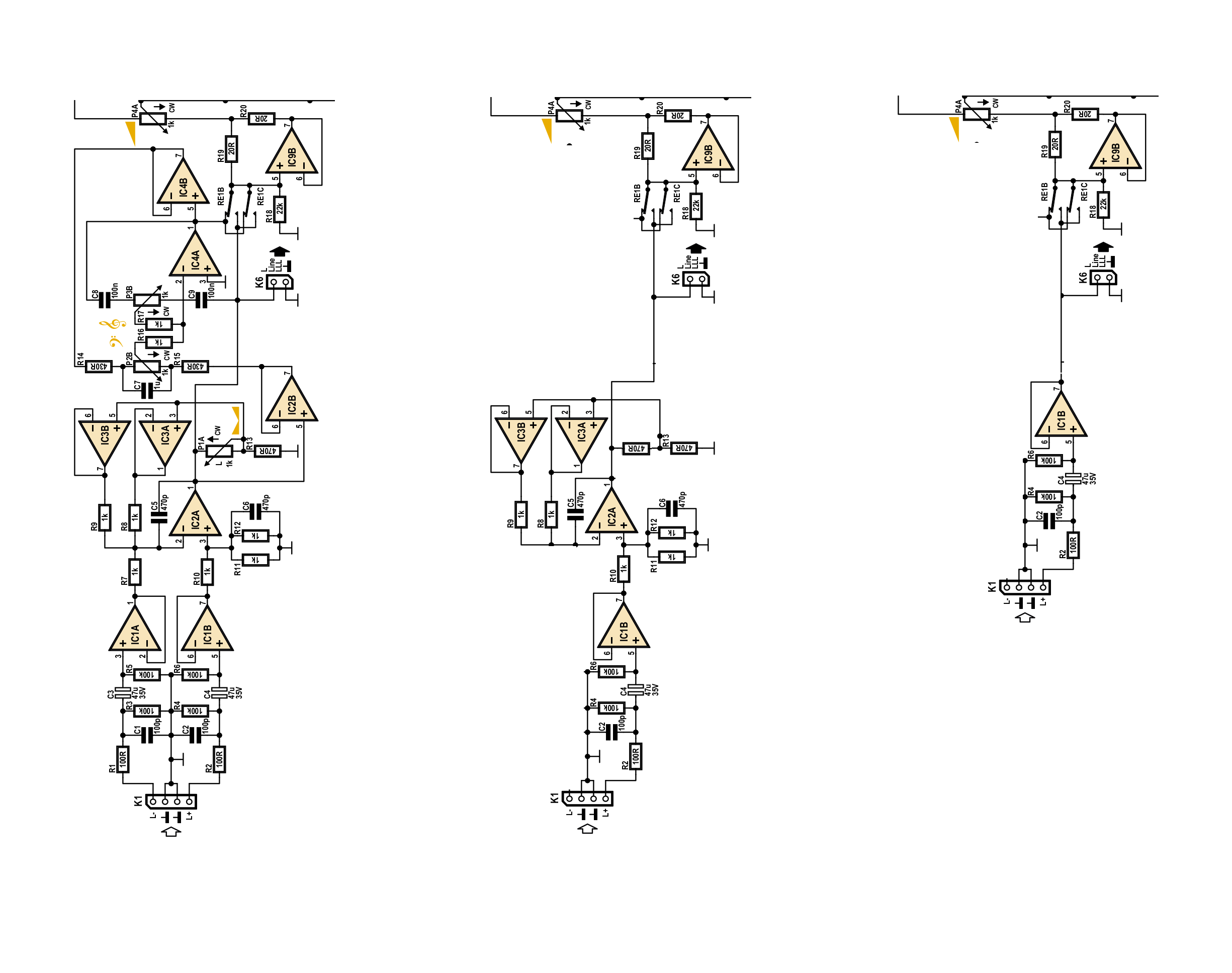

Is there any sense in making the amp-circuit simpler? Less components = less noise?
Suppose I do not have balanced signals, never adjust bass or treble, and am happy with 2 mono volume-pots so I do not need a balance-pot. What all can be left out?
For treble and bass that is obvious: just leave-out all components that are no longer in the audio path if the tonedefeat switch is activated. (middle circuit)
For the balance this is less obvious: what is the shortest quality-audio path from the input opamp to the volume-pot? Is that as in the 3rd circuit or had I better keep some of those "balance-components" in?

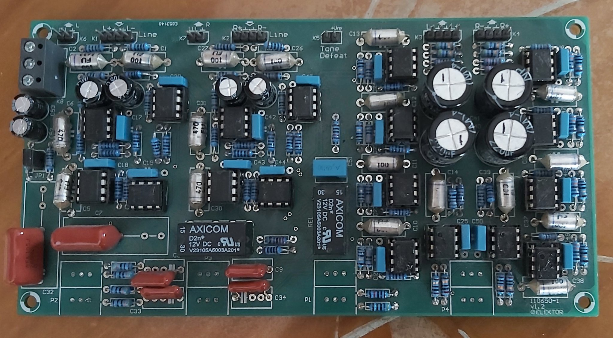

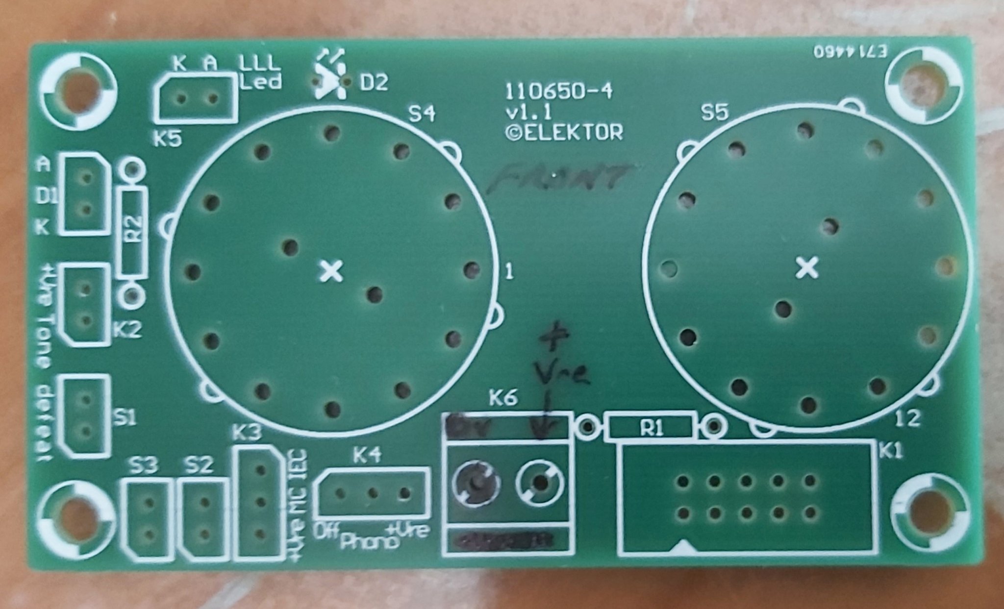

I have new 110650-5, 110650-6, 110650-4.
I also have a 110650-1, components all mounted, but it has a problem, never got round to checking out the problem.

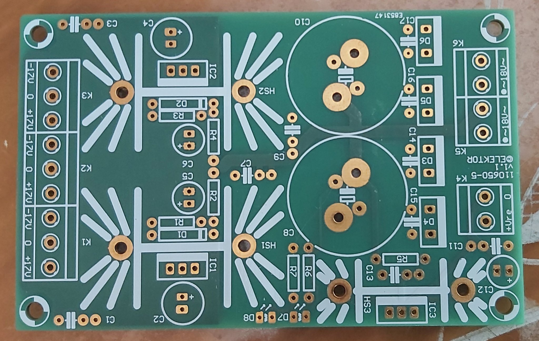

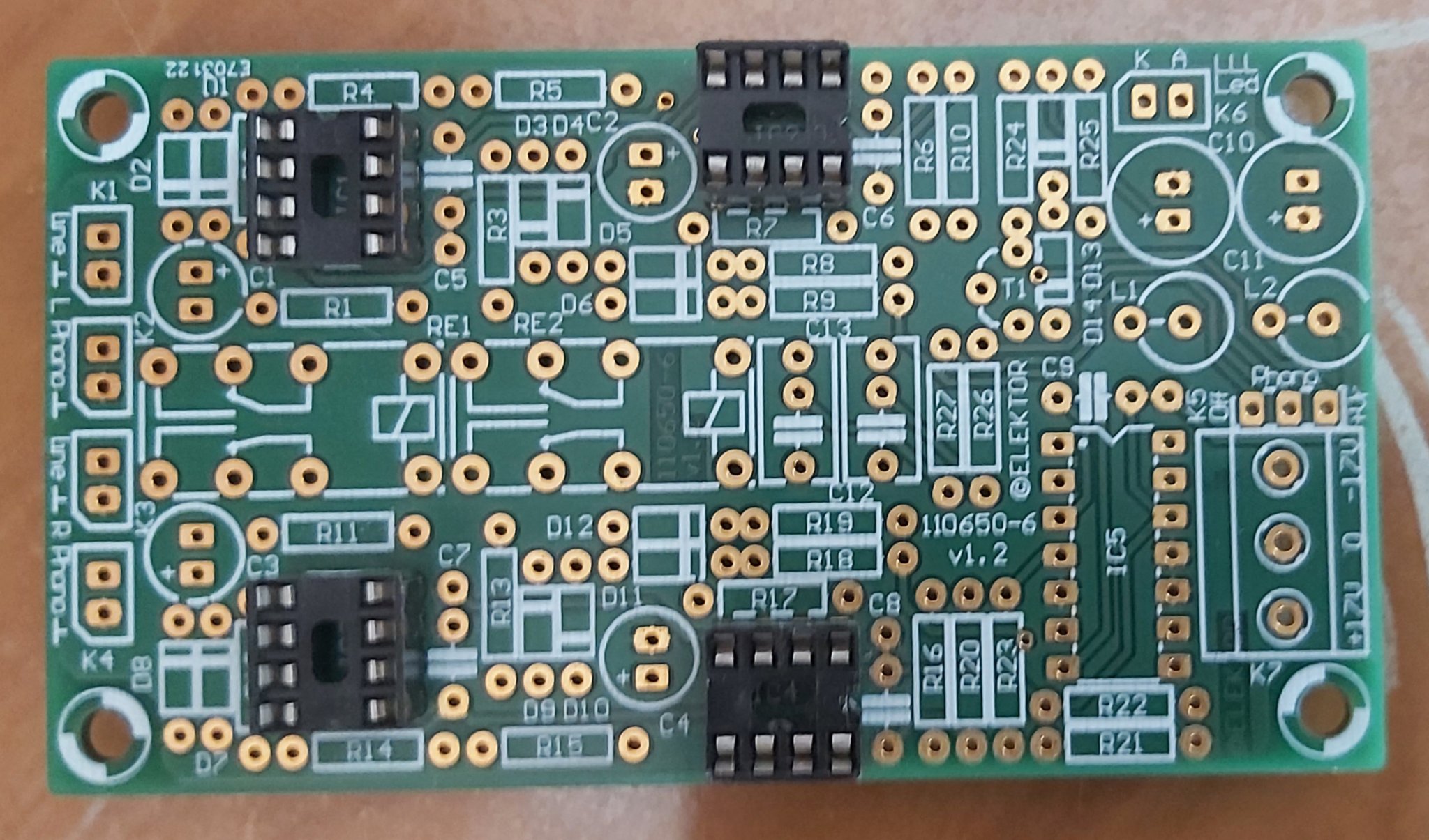

Decided to build this Preamp, I tried to get the PCBs from ELEKTOR, which are currenly (and I guess in future) not available.
Since I'm working a lot with KiCAD, I decided to "reverse engineer" the PCBs.
They might not be perfect, but it's a good beginning with and all my PCBs (seven) are working.
Inside the archive you will find the sources for KiCAD ( at least 9.01) - there might be still bugs, so please check them before ordering.
In the ibom folder you will find the html-BOMs for placing and sourcing the parts.
The BOM for the parts is a bit messy, I will correct that later. But you can generate your own BOM from the iboms.
Unfortunately the files are too big (90 MB in total) to attach them here, so please leave a message, when you are interested and we'll find a way to host them.
