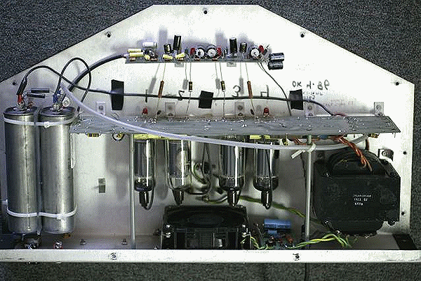

I once built a direct-drive amplifier for a DIY electrostatic speaker built by a then colleague. With its 2660 V supply capable of supplying more than enough current to cause cardiac problems, it was by far the most dangerous circuit I ever built. Its peak output voltage was 2 kV, which turned out to be insufficient to play anything but background music. See https://home.kpn.nl/verwa255/esl/amp.zip and Elektrostatic Loudspeakers
I know Lampie519 from this forum has a more efficient and more successful direct-drive amplifier. He uses SRPP output stages and a custom-wound transformer for the high-voltage supply. That's far more efficient (and even more dangerous) than what I did.
