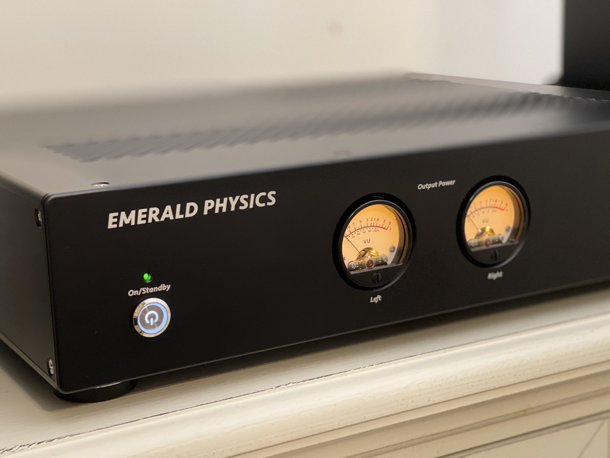

It has been a long road designing the Emerald Physics 600.2SE amp, but what we have finally achieved is totally worth it and an amazing sounding amp. This amp has enough power to satisfy any speaker one could imagine or need. I want to thank Jan Hofland for his help on this project as he designed the HyperSET tube buffer that feeds the 600w class D amp the audio signal. We are now finally starting production of this hybrid amp - a 600wpc Class D amp with a SET tube buffer (E88CC or NOS 6N1P). Accepts balanced or SE inputs. Selector switch for tube or SS buffer. The sound is powerful, smooth and clean with just the right secret sauce of a SET goodness. The grip on the bass is incredible. Built in integrated logic controller for graceful startup and shutdown to allow proper tube warmup and no thump. Chassis is satin finish bead blasted and black anodized CNC’d aluminum with a luxurious feel and heft (5mm thick panels all around). Real galavanometer VU meters to show power levels and quality Neutrik XLR/TRS connectors and premium Viborg pure solid copper binding posts.

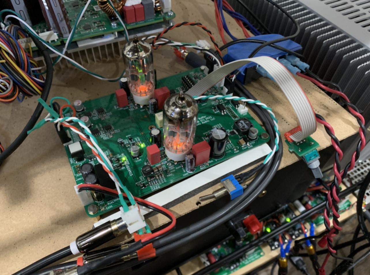

This was an early prototype of it:
Later versions have some logic control to allow graceful startup of the 1200AS2 after the tubes have warmed up:

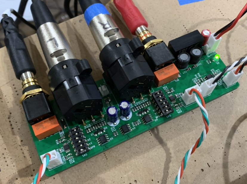

If you are willing to have a balanced buffer without the tube stage (all superb OPA1656 opamps and OPA1637 balanced driver) you can get the BTSB Panel Mount buffer. There is a group buy for it. IMO, it sounds just as nice as the HyperSET.

I have been contemplating offering HyperSET as a DIY board. Are you talking about building if from unpopulated PCB or a RTR offering? It’s got about 200-300 components so not a walk in the park.
Current version has a Wurth IDC ribbon cable connector for optional panel mounted volume pot and also open collector logic for ensuring graceful startup and shutdown of an amp that it is connected to. Oh, and there is a switch that allows the tube stage to be bypassed for purely solid state operation.

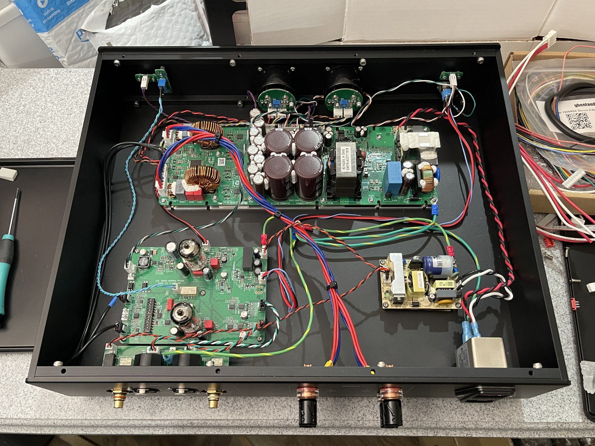

Yes, I designed the overall amp and specified the IcePower 1200AS2 as the class D core.
The HyperSET buffer was custom designed by Jhofland for this amp and is based on the BTSB buffer but with an E88CC SE Class A tube stage in between to provide the sonic character of a clean low distortion tube amp with dominant second harmonic profile and yet low THD of 0.002%.
There is custom designed logic to provide smooth startup and shutdown.
