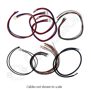

The modules are available from various sources. Profusion for example:
https://www.profusionplc.com/parts/icepower1200as2
Make sure you get the cable kit that comes with it. Datasheet is here too.
https://www.profusionplc.com/parts/icepower1200as2#data_anch
$23 is a great price for the cables from this site.

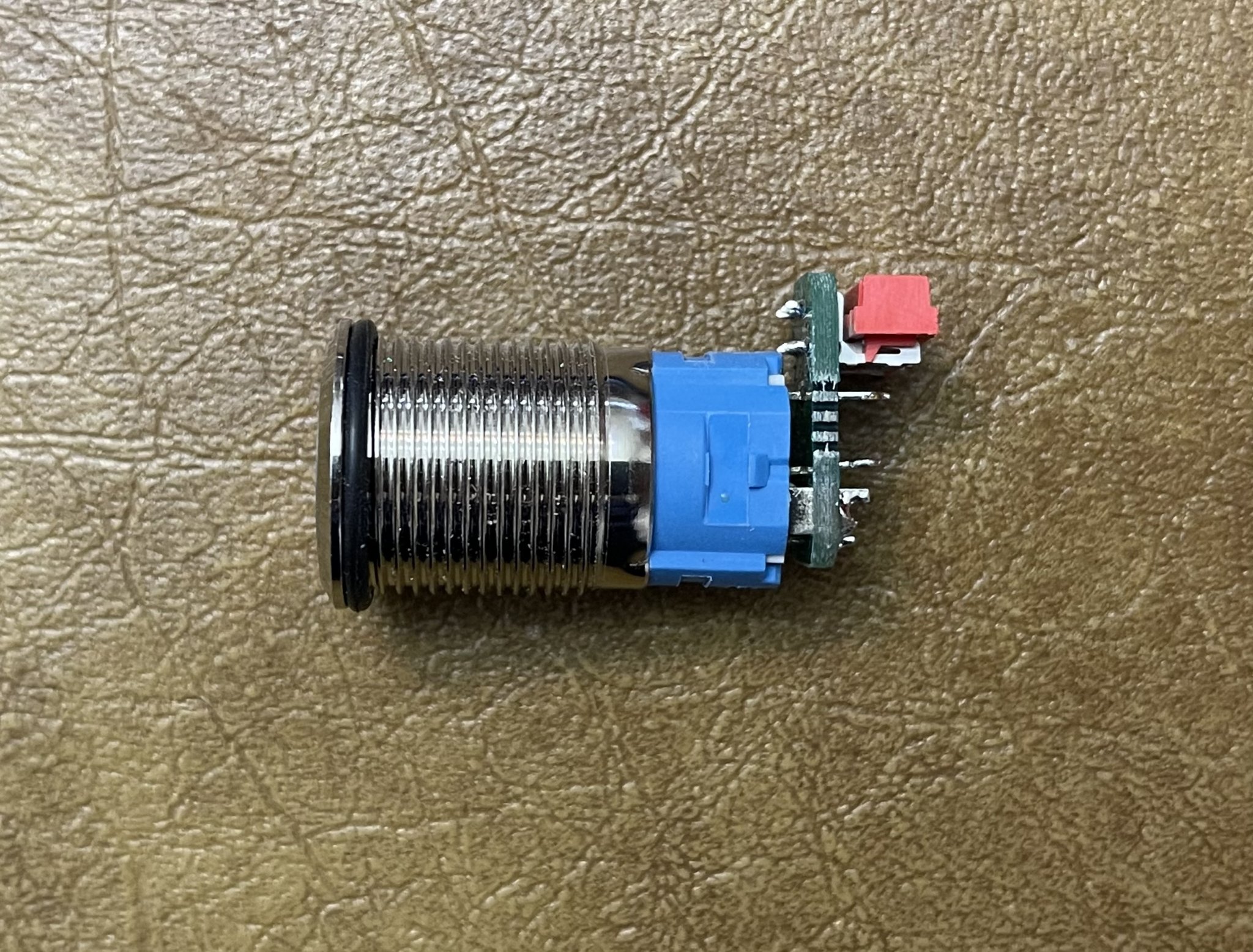

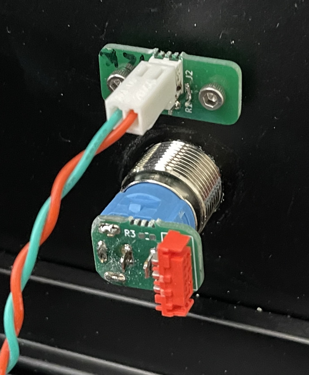

Little details matter. I’m going to improve the power on switch reliability and ease of assembly by switching over to a custom made helper PCB with a MicroMatch EDC ribbon cable connector to run from the switch to the 1200AS2 amp module and the tube buffer logic circuit.
The size is very compact to allow it to be threaded through the panel cutout.
Hand soldered connections (like below) are ok for a one-of prototype, but ease of production and real world reliability are important and vastly improved with MicroMatch connectors wherever possible.
