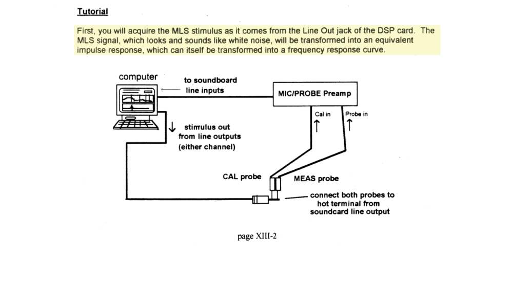

dlr,
Here is what the owners manual says about impulse response. At the bottom of the page, in yellow. Did you not know this?
Bud

BudP said:dlr,
Bud
Yes, precisely. The MLS technique was developed by the author of MLSSA. It provides a means to obtain an impulse response that eliminates all influence of any upstream components, that is, preamp, interconnects, amplifier, speaker cable and any intervening device. The raw driver response can be obtained from a system with the crossover in place, at the expense of some lower signal-to-noise ratio. One only need place the probe after the last component for the cross-correlation that is made. This cannot be done with a direct impulse system. The MLS has many inherent advantages.
Second, the MLS has an inherently lower noise floor and better noise rejection than a direct impulse. But the result is the same, the system acquires the impulse response of the system. EVERY MLS based measurement system uses this technique.
So the statement that it cannot generate an impulse response is implying the inability to acquire the impulse response of the system. The point is meaningless.
Let me add one more point. Every system that you may care to use will, at some point, apply some mathematical function to the acquired data in order to obtain other data. Even something as simple as the frequency response with phase data cannot be made by any standard systems, such as those that use sine-wave sweeps. This is because a sine-wave sweep is inherently lacking any phase data. A system such as LMS (part of the LMS/LEAP software) acquires ONLY the magnitude. The phase is generated afterwards via, guess what, the Hilbert-Bode transform!
The MLS provides data acquisition. The functions applied to this data yield any and all other data that is within its ability to provide. The same is true for a simply direct impulse. The impulse, FR+phase, CSD, step, distortion, etc., are all provided via application of mathematical functions to the acquired data.
Dave
