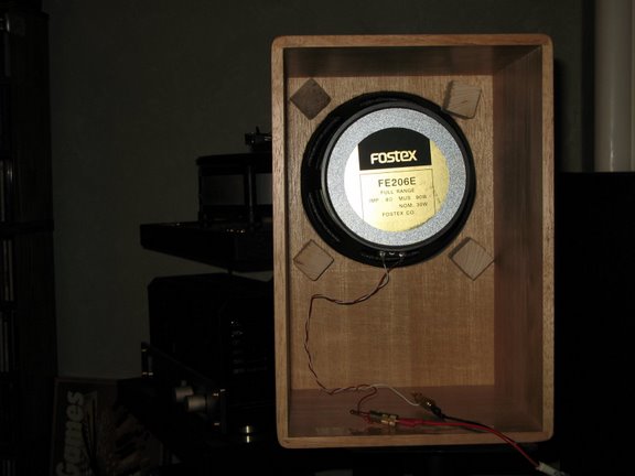

OK - there's no room on the baffle for EnABL round the driver bit - the driver goes too close to the edge, but I could EnABL round the outside. Do you think that would be as effective?
You can see that from the pics:
However, I know the sound of these speakers now, I've listened to them a LOT - and they would be easier to A/B because they don't weight 1 tonne each like the Sachikos will!

Has anybody made a measurement of a full-range driver such as that one before/after the dust cap was replaced with the "phase" plug? My understanding is that it is a full-range driver. The dust cap ,even inside a whizzer, is often used to add to the top end. If you eliminate that dust cap, you're likely to reduce the upper end frequency response.
Has anyone actually documented the change? Consider that the driver designer would likely have tested quite a number of variations, including this I suspect. The off-axis also is an issue, so to show what is really changing, this area must be included in analyzing the change.

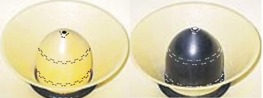

Indeed they have. And also described a slight loss of highs. In my
own speakers there was perhaps a slight loss of edginess. I wasn't
for going back (even if I could) unlike the time I put on too much
Microgloss and mega-lost some highs!
Phase Plug Graphs

http://www.geocities.com/rbrines1/Pages/Articles/Phase_Plugs/Phase_Plugs.html
dave
dlr said:Has anybody made a measurement of a full-range driver such as that one before/after the dust cap was replaced with the "phase" plug? My understanding is that it is a full-range driver. The dust cap ,even inside a whizzer, is often used to add to the top end. If you eliminate that dust cap, you're likely to reduce the upper end frequency response.
dave
Re: phase plugs
auplater said:Is it just me, or do those phase plug modified full ranges look like a tongue sticking out of the speaker center...![]()
Maybe a new paint theme, eh?
Phase Plug Performance
Concerning Bob Brines' phase plug data with the Fostex FE167E referenced by Planet 10:
The off axis response of this driver above 2000 Hz of this driver is exceptionally rough beyond 30 degrees with or without the phase plug. But, if you focus on the on-axis to 15 degrees off performance, it is clear that the phase plugs cause more variability in the response. The valleys are deeper and while so of the dips have moved, the overall response is rougher. I don't see how the sound would be better in any way with the phase plugs versus without.
Other drivers may or may not perform similarly to the FE167E. However, these results are a case for saving your money and not buying phase plugs. You would be better off buying a better driver than fooling with phase plugs on the FE167E.
I should let Bob speak for himself, but as i understand it, after his initial comments based on the measures, extended listening has him preferring the speakers with phase plugs (based on comments from more recent posts).
I have had a few comments about less top end, but no comments that weren't positive, and many that are quite enthusiastic.
Another case of the limited measuring technology we have not telling the whole story?
dave
dave
