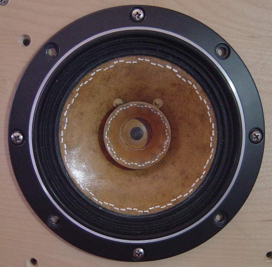

Chris, Did the PM go through, I am never sure I have the procedures quite straight.
As for the color of the cone, I do not know. Just the shiny surface and semi transparent nature of the cone, you can see the Mamboni triangles through the whizzer cone, are familiar.
Phase plugs and other post emitter surfaces all seem to benefit. I have no experience with phase plugs per se but I can see what I would do for many of the ones I have looked at.
The main thing to keep in mind is that this is a three vector pattern and seems to need to be placed just before any major deviation in surface is encountered. So, if the phase plug is an oblate shape, just before its surface becomes tangential to the emitting longitudinal compression wave front, is the most useful place to put the pattern. At the start and actual finish, if there is a distinct one at all, are also places to treat. These will be very small in benefit compared to the one at the tangential circumference.
Once you get involved with this pattern you do tend to treat all surfaces, just to learn the benefits, and one of the benefits is a reeducation of your correlator. Well, "benefits" I suppose, as you will become a bit short on tolerance for drivers that are not as well behaved as the EnABL'ed units are. Something of a pain some times.

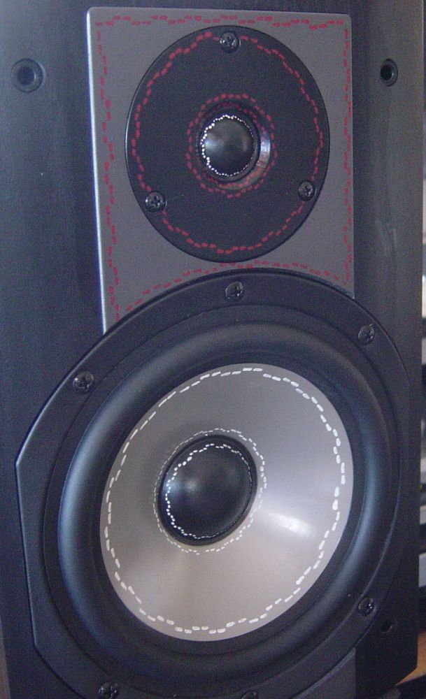

Hi R Jamm,
I will finish building up the 2nd test speaker tomorrow. On this 2nd speaker I have reduced the height by 4 inch's from 28 inch to 24 inch. The reason for this is that with the 28 inch speaker I notice a "richer" sound when I stand up and my ear is above the baffle and speaker frame - so I am trying to get that same richness when I am sitting. I thought of reducing the height even more but was afraid I would lose to much bass response. I'll know tomorrow when I finish building unit number 2.
I must say that the Pioneer 10 inch mid-woofer doesn't seem to take much to break in - about a day seems to it! My Fostex 167's took a solid week - heck they were so tight when they were new that I had to kick up the amp to around 90db's just to get 'em moving and then back it off to mid level and just let 'em cook. The Pioneer fired up right away and seemed pretty good from the get-go!
I am still amazed by the openness of the sound these units produce! Taking the speaker box pretty much out of the usual scheme of being a "box" that "aims" the direction of the traditional speaker is nixed and these things - they sound similar to OB designs - very open sound and very smooth.
I'm looking around for a different tweeter than my Heils - just to see what is out there in today's world. My current thinking is to use a tweeter that is good from say 3 khz up to above 18 Khz and mount it in a similar configuration as the Pioneer (reduced in scale of course) and flip it upside down so the magnet of the tweeter would be back to back with the magnet of the Pioneer. I'll work up a sketch and put in a later post to show what I'm thinking of.
I'm also thinking that the baffle the Pioneer sits atop of is a bit to wide because of the 14 inch SonoTube I'm using. So I'm considering putting a dome shaped baffle on one of the test units and doing some EnABL patterns to see how that helps smooth things out.
One thing that I'm still very sure of - for the cost and ease of construction this is one heck of a speaker!
I FINALLY got my Micro Gloss delivered at the local hobby shop so now I can start doing some of BudP's EnABL patterns!!
The stencil experiments just did not work out well at all - although I still want to try a couple of things. Right now it looks like the way I'll go with applying EnABL is to use Speedball Calligraphy Pens - sizes A0 thru A5 (square, flat tip on the A series) and the Polly S acrylic paint. I'll print out a pattern on regular paper and trim it down to a size that I can tape to the speaker near the area to be treated and use it as a guide. Then it's a careful touch with the correct sized Speedball tip and whack-o - my speaker cones have been EnABLed!
BTW - the problem with the silkscreen stencil was that the Polly S paint is so thin that it would creep underneath the edge of the screen and blot out around the edge of the pattern. It could make for a rather interesting "ink blot" test (perhaps something I should be considering
) but not a very good application of BudP's EnABL pattern.
I noticed on another thread that there is some discussion of BudP getting his own EnABL thread going here sometime soon. Congratulations Bud!
My suggestion is to put an EnABL pattern all the way around the edges of it in order to keep things smooth and dump off all distortions and distractions.
But then I guess that most of the stuff I'd post would wind up in the bit bucket! :bs:
Attached is a photo of test tube #2! I will report on the findings!

Hi John,
If you can give me a few days I will be putting up pictures of the pen types needed, the paints needed and showing how a pair of Lowthers can be tamed.
If not, then go looking for Speed Ball A series pen tips and a handle to put them in. Also go to the local good hobby store and look for Poly S Flat Clear acrylic paint and Micro Scale Micro Gloss acrylic clear paint. Then toddle over to your good office products store, or, horrors, call around to find Polar Coordinate Graph paper.
Then dig up your ancient mechanical drawing set and get out the dividers. Do you have a set of extenders? You will need them.
Measure the distance from surround joint with cone, across the cone to it's opposite point and transfer that to a small section of the polar paper. Count back a couple of circles and that will be the outside edge of your upper, outer ring. Count back three more rings and that will be the lower edge of your lower ring of blocks.
Take that flat ring projection from one of the threads, this one even, and expand it until the outer edge of the biggest ring is one ring smaller than the inner diameter of your polar paper lower ring measurement. You may only get a section from letter sized paper and you will certainly have to stiffen it by gluing it to some thin cardboard. This becomes your template for application of the flat clear paint with the calligraphy pen. You can just as easily fill in the appropriate blocks on the Polar paper with pencil and use it directly, I do.
You use the pens upside down and pretty square to the cone surface you are working on The application pattern is two sets of lower blocks, and I would use the ones printed close to the cone for this, and then by eye put a set of upper blocks in between these two lower blocks, on the upper ring. Make sure you are leaving a small gap to the surround. For the 15 inch you will be using the widest pen available, This will be wide enough, even though it is not as wide as the printed paper blocks. Since you are eyeballing the placement just bring the upper blocks down a bit so that the space between rings is about the same as the widtht of the pen. A little more or less will be unimportant. If you find that the pattern row has wandered from perfectly concentric do not fret, wont alter a thing.
The flat clear paint will basically disappear for a while so you really cannot do one whole ring and then another very successfully.
Regardless of cone paper type use a pen dip per block and only drag one edge of the tip on the bottle lip, to remove big globs. If this is a soft short fiber cone material you probably will not see the pattern until you apply the gloss coat conformal coating material. If this is a calendered hard surface paper cone you will see the pattern pretty quickly, as it dries. If this is a poly cone don't use it just yet. Poly cones work quite well but you have to tooth the poly first, using a 3 to 4 k grit paper and a gloss pre-coat and overcoat process.
Be sure you pass the pen tip through an open flame till the protective coating burns off in a few seconds, otherwise the paint will not adhere to the brass and you will have no control over the flow event.
I would really suggest a cheap 8 inch paper cone PA driver as your first learning surface. You will improve the performance enormously with just two sets of rings and a dot in the middle of the dust cover, surrounded by just six of the pattern blocks to turn off the energy that would otherwise create a beam from this location.
The cone / dust cover joint will need to be treated and you use three rings here, one right at the joint, one up the cone wall and one out on the dome. same relative spacing, same number of pattern blocks. Round dots here are ok, rectangles get difficult to control at this small a size, on the 8 inch at least. The 15 inch woofer will need the same treatment, even though it will be a tedious bear to do it.
I am reposting a picture of a Fostex cone done by ultrakaz. This level of precision is really as good as you need to get to, so you do not need to be tense about errors or perfect looking blocks, which you will not get anyway. ultrakaz put 38 block sets down and it didn't hurt a thing. He tells me privately that he treated a pair of cheap Yamaha two way ($70 per pair) speaker systems and his girlfriend claims they are much clearer than his big system speakers. He is a bit undone by this from the sound of it.
I have never had to do more than apply the acrylic paint blocks to a baffle surface to completely control both reflected energy and diffraction from a sharp chine edge. Try this first and if it doesn't work for you, you can always make the pattern from other thicker materials.

John,
The Poly S is for the pattern, goes on first and is allowed to dry for a day. Then listen to one of the drivers.
Then coat the front side with one coat of the Micro Coat Gloss. Use a sable brush that just fits in to the bottle opening, move slowly as this stuff foams instantly and the bubbles take hours to break. Do not ever shake or stir just sort of gently rock the bottle, very slowly, to mix contents if they separate out.
First coat should go on using a circular painting fashion with as even and painterly a stroke as you can manage. This will not be a particularly even coat. Then wait a day and listen again, free air is fine, full range is fine. Likely two more coats of Gloss will do all that is needed. Apply them in alternate directions, with the second coat as vertical strips and the third as circular again. You can do these two back to back or wait for a few hours in between. Don't wait for a day though as these two need to interact a bit to give you a really smooth shiny surface.
Here is the Fostex thread and I have posted his latest treated drivers, the Yamahas, below.
http://www.diyaudio.com/forums/showthread.php?s=&threadid=100391
