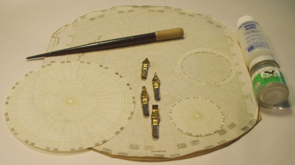

This will be one of my early pictures for the Lowther processing which I will begin to post today.
Bud
Hi all,
Here is the promised Lowther beginning. The posted picture is of polar coordinate graph paper, applied to my purposes, the pens, Poly S paint and Micro Gloss coating materials. You can see a plan for a 12" driver, a Lowther size driver, a dome (with the blocks on the inside of the ring) and another small block ring. This is all you need, plus some scissors and a decent camel hair brush, to EnABL drivers of any size and configuration.
Bu

The link later on in this post should take you to a photo album that shows the pieces generated by computer fawning, that you do not really need to use, to EnABL a driver. Mostly I hope they give you some hints on how to use a guide and what it's placement, with regards to the actual painted blocks, should be.
The conic sections show where the actual blocks should be and the flat patterns show where the guides should be and the two together show how much above a flat guide to place the pattern blocks. All together, there will be nine EnAbl block rings.
The whizzer will have three rings at the top of the whizzer, two rings on the cone and one ring over the fold and out onto the ledge that Lowther thinks is a good idea. This means that you should pattern the Whizzer top first so that you can align the shelf pattern, as an offset to the top row of blocks, on the whizzer cone.
Alignment of the bottom two rows on the whizzer would be a nice touch and if I manage to do it, great. It will look better than not, but there will be zero sonic benefits or detriment. Alignment of the top cone and whizzer rows might actually be important sonically so I will enforce that.
Here is the link to the pics. Please resist editing the comments for the pics... I know it will be hard, but I will just become dispirited with my web ignorance and inability to lock my own intelligent comments in place for posterity.
http://picasaweb.google.com/hpurvin...photo?authkey=VnmOeDveOOk#5059385522118969202
Bud

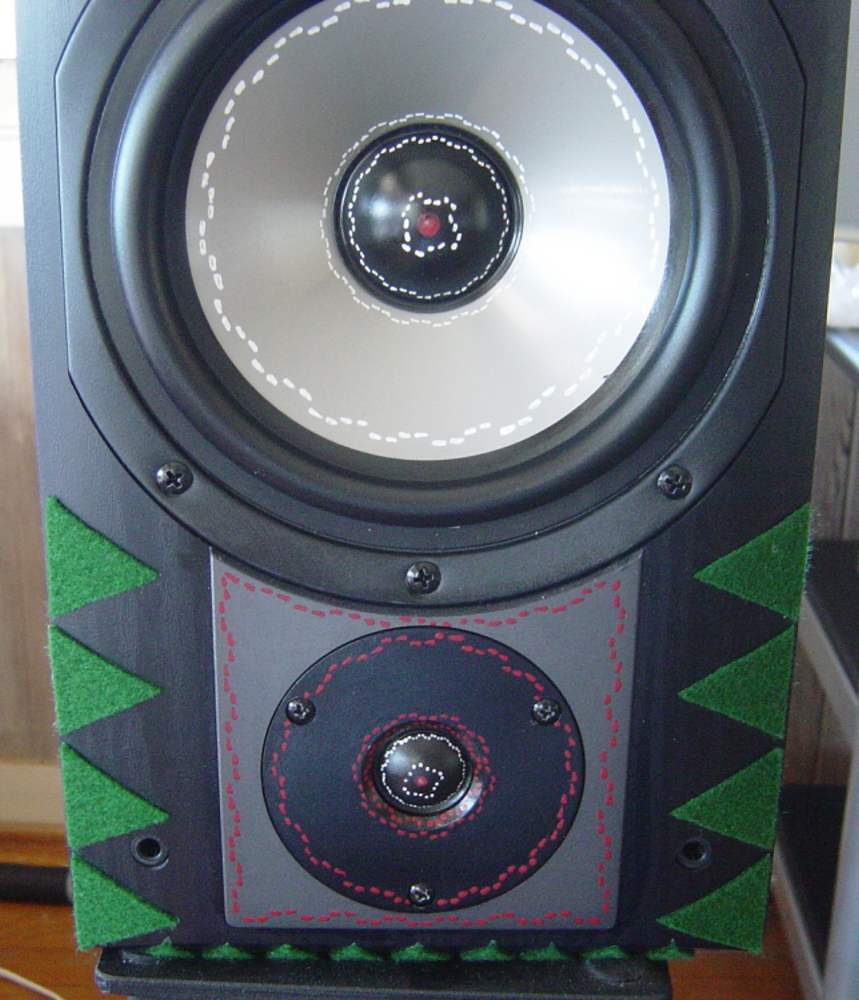

Well, ultrakaz has done it again. Look closely at the center domes on the attached Yamaha speaker system. That is the mysterious center dome pattern, with center spot and droplet of PVA on top of the center spot, I have mentioned a few times in this thread.
Bas, John and all who are contemplating treating large cones with center domes, you want to copy this pattern at the joint of the cone and dome. Though, you can squeeze them down into three rows, with the center row of blocks right in the joint, for less of this tedious activity.
The center dome treatment is important also, very important, as it controls the spike of energy from the center dome and controls the evenness of the high frequency dispersion pattern. Note how few blocks are involved, this is the number that you need, between four and ten pairs in two rings, total. Bas, you will be able to remove the round felt pieces you have attached to your cone. This, added to what you have already done, will control the whole cone. Then add Mamboni to the back just for the sake of bliss.
Then look around, our friend Mamboni is also showing up around the edges of the cabinet. You guys are ging to have to hurry to catch up here......
Bud

So, I am not convinced that there is more than a loose relationship. Or, the treated cone is emitting so coherent and self supporting a wave that the additional blocks at the panel edge just act as a subsidiary control. to maintain that coherence. This is supported to a degree. by the one wave tank test I performed many years ago, where the emitted waves flowed to the end of the tank and dispersed with no observable reflections. There are wave structures like this in nature, they are called Soliton Waves.
4. No measurable differences have been shown in larger drivers. Since Bud is working on some drivers right now, it would be nice to see some "response before" and "response after".
I have been quite frustrated in my limited teat suite and knowledge of procedures. I do not have a MLSSA or other CSD capable test device. With my main revenue stream, transformers, mired in such a dismal business climate, I will not be able to remedy this lack on my own. I can supply samples, processed to differing levels of completion, but not a lot more than that and many years of experimentation.
5. I think one thing I am going to do is investigate some of my data and see if this reflection characteristic can be found. Reading the article Bud posted on the Positive Feedback site lead me to think about distinguishing cone breakup versus reflection.
My experience has been, that with both parts applied, cone breakup is somewhere out beyond the stable power handling ability of the voice coil. I have had test samples catch fire in the motor, with only a mild amount of very linear compression being audible. Very very loud compression, but not the usual garble, leading to complete dissonance, typical of the untreated sample drivers. These tests cannot be entered as anything but anecdotal evidence, since no particular attempt to provide controls was followed. It does seem to be pervasive however.
6. I wouldn't expect this to be a solution for cone breakup unless the mass of the pattern is significant enough to change those modes.
The only comment I can make is that cone breakup may be more profoundly influenced by standing wave corruption, of following signals, than is generally realized. I think a very close look into this will be, at least, educational. Regardless of the eventual findings, I do think this is an entangled event and not a clearly understood entanglement either.
One driver that comes to mind that might worth a try is the Jordan JX92S. This driver is known to be a little rough at the high frequencies, smoothing that out really will make it stand out.
Be happy to provide my abilities. However, i do think that objective tests should be on a simple paper cone, as noted in my long response to bobhayes, similar to the one Corrington used in the 50's.
Bud
There is a solution for those that can't find polar graph paper.
Graph paper printer
The options are available through dropdown pick-lists:
Cartesian, polar, triangular, hexagonal, axonometric and dot diagrams.
Linear scales (metric, imperial, time, equal divisions, customizable).
Non-linear scales (logarithmic, quadratic, gaussian, square root, Weibull, logit).
Music manuscripts and tablatures.
Mercator grids.
Pattern papers (lines, bricks, losanges, ellipses, hexagons).
Regards
James
