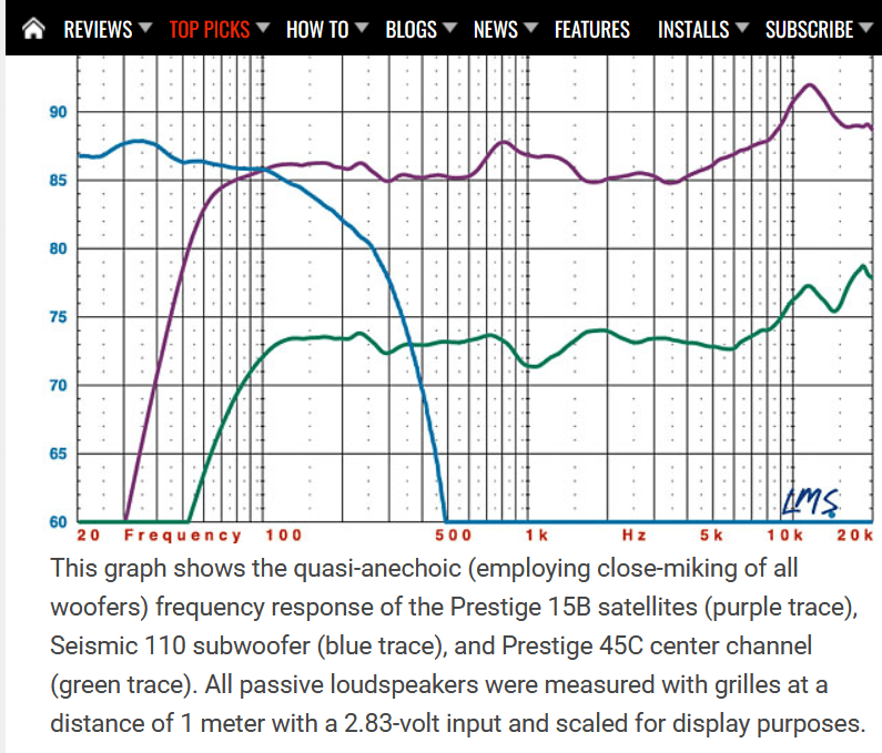

What's 'boring' about the Dalis, is it because they sound more laid back, or have a less bright sound than the Paradigms? I haven't heard either so I can't comment on the sound; sometimes a speaker might sound more 'exciting' but may not be suitable for long listening sessions.In terms of drivers, are there particular ones many people are using for home builds? Any that stand out? Appreciate all your help, I'm slowly piecing the whole landscape together. My current home audio set is Dali Oberon 3s, but they seem pretty boring to me compared to the Paradigms
