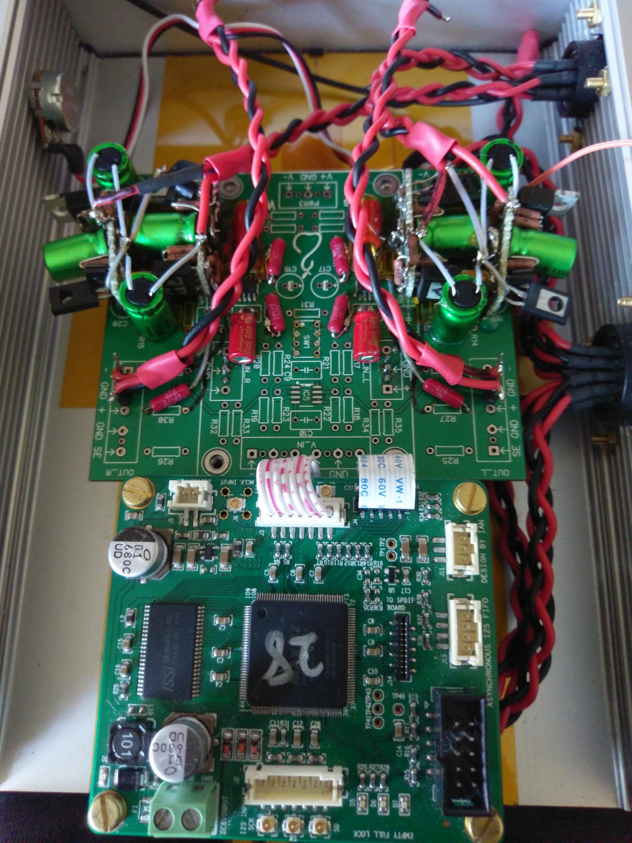

Made some good progress this weekend in preparation for trying Ian's latest toys...

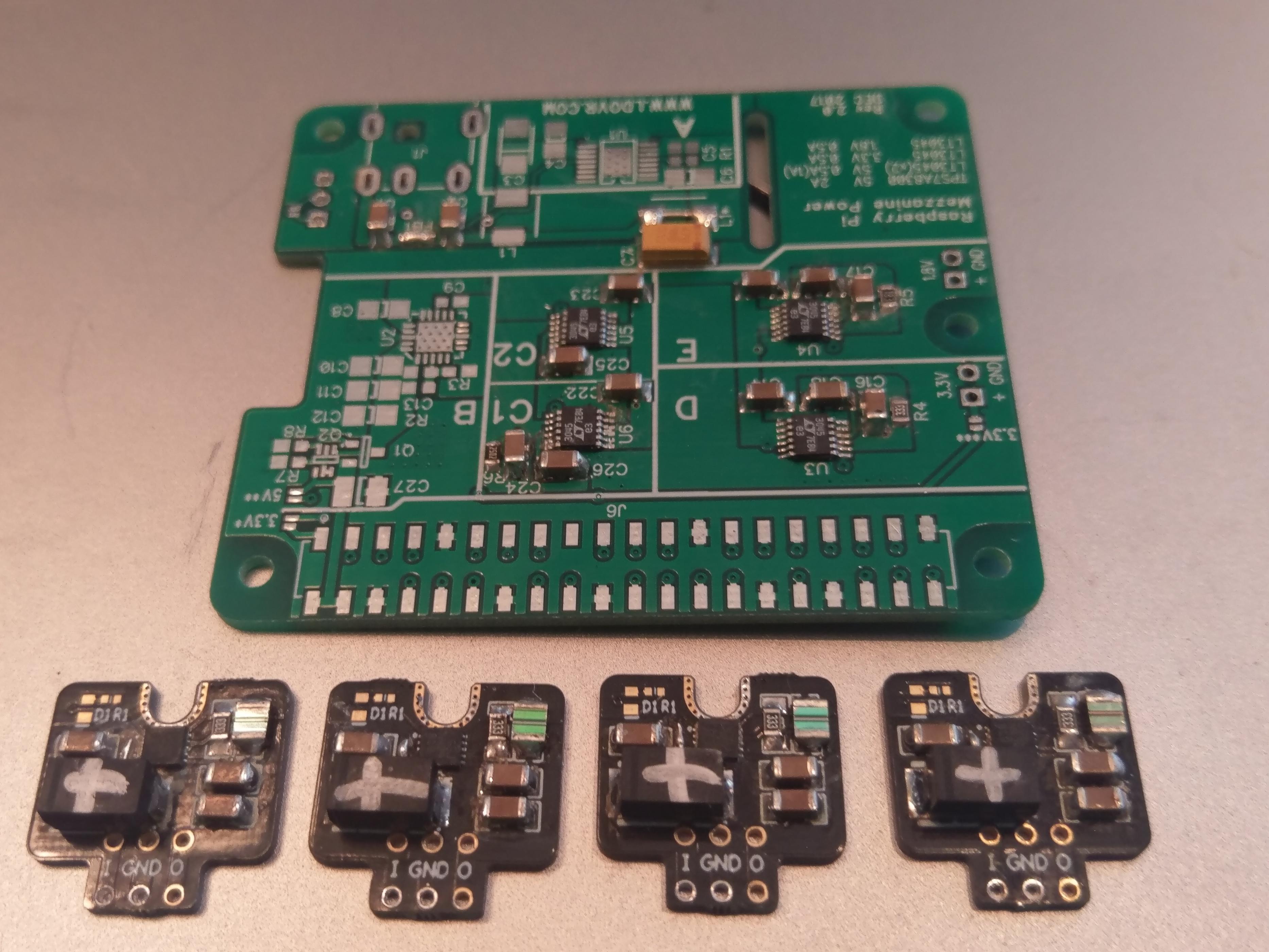

- Built 4 of his LT3042-based reg boards. 2 of them will go on the prototype of his ES9028Q2M RPi DAC I have here to provide separate regulation for each rail on the board. That'll get it about as good as it can go with regulator-based supplies to compare to the Ultracap-based ones. The other 2 are reserved as CC/CV supplies for Ultracap supplies.
- Built another ldovr.com RPi mezzanine board to convert a 2nd RPi to fully-linear-regulated operation, along with another Stammheim dual 3||LT3045 reg board at 6V to power it. That'll give me a 2nd reference-level RPi source for the comparisons.
- Got both of my Twisted Pear Buffalo-III Pro setups fully running. One is the ES9038 version of course into their Mercury. The other is the ES9028 version, which I've run with 2 I/V stages. One is a 'truncated' IVY using just 1 OPA1632 per channel in the configuration Joe Rasmussen published to provide a near-equivalent to Ian's OPA1632-based I/V stage. The other is their Legato, which should be closer to Ian's OPA861-based I/V stage. The ES9038 won my head, the ES9028 with the Legato won my heart and provide more of that illusive 'analog' sound we are searching for, at least to my ears.

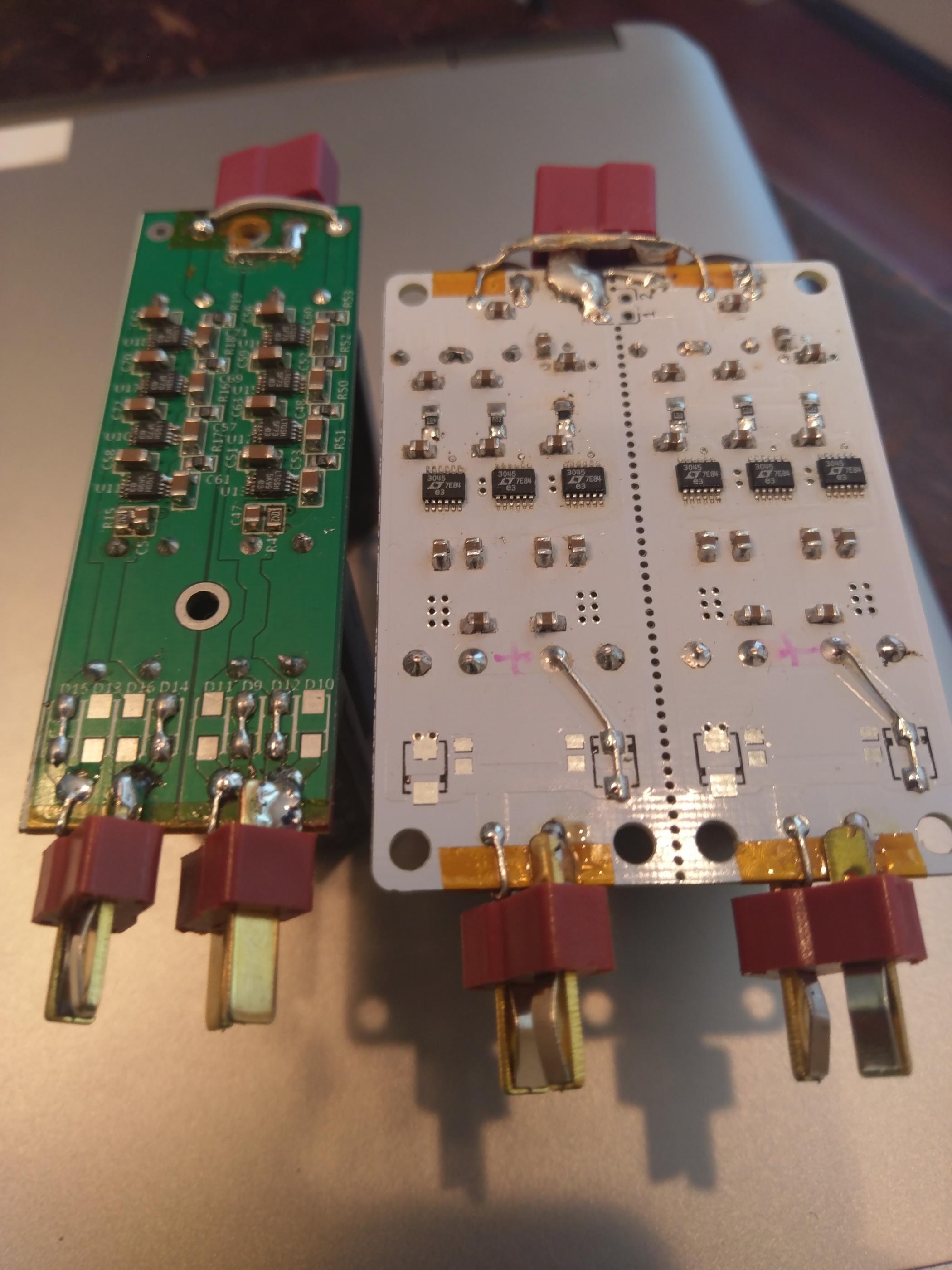

Assembled UCPi, the ultra capacitor explore board for RPi
I assembled this UCPi PCB today.
My LT3042 ultra low noise reg board is used as the CC-CV trickle charger. I set the current limitation to 200mA. It takes around one hour to fully charge the two ultra capacitor cells. The finial voltage difference in between is less than 0.1V.
With DC input connected, UCPi works in floating charge mode; When DC input is removed after fully charge, it will work in pure mode.
Linear DC input is recommended, but 5V power from an USB adapter is also available through the on-board USB connector. I'll do some test to find out how much difference in between.
UCPi is an explore board, so it doesn't have complicated relays or MOS FETs for automatic switching functions. But it has all performance of an ultra capacitor power supply. It's a good start point to experience ultra capacitor power at low cost. And also it might be the best 3.3V or 5V power supply so far for RPi ESS DAC HATs.
I sent 2 of the UCPi PCBs to Greg for sharing, hopefully he will receive them soon.
BTW, big ultra capacitors are not very easy to solder. Higher power soldering iron might be required.

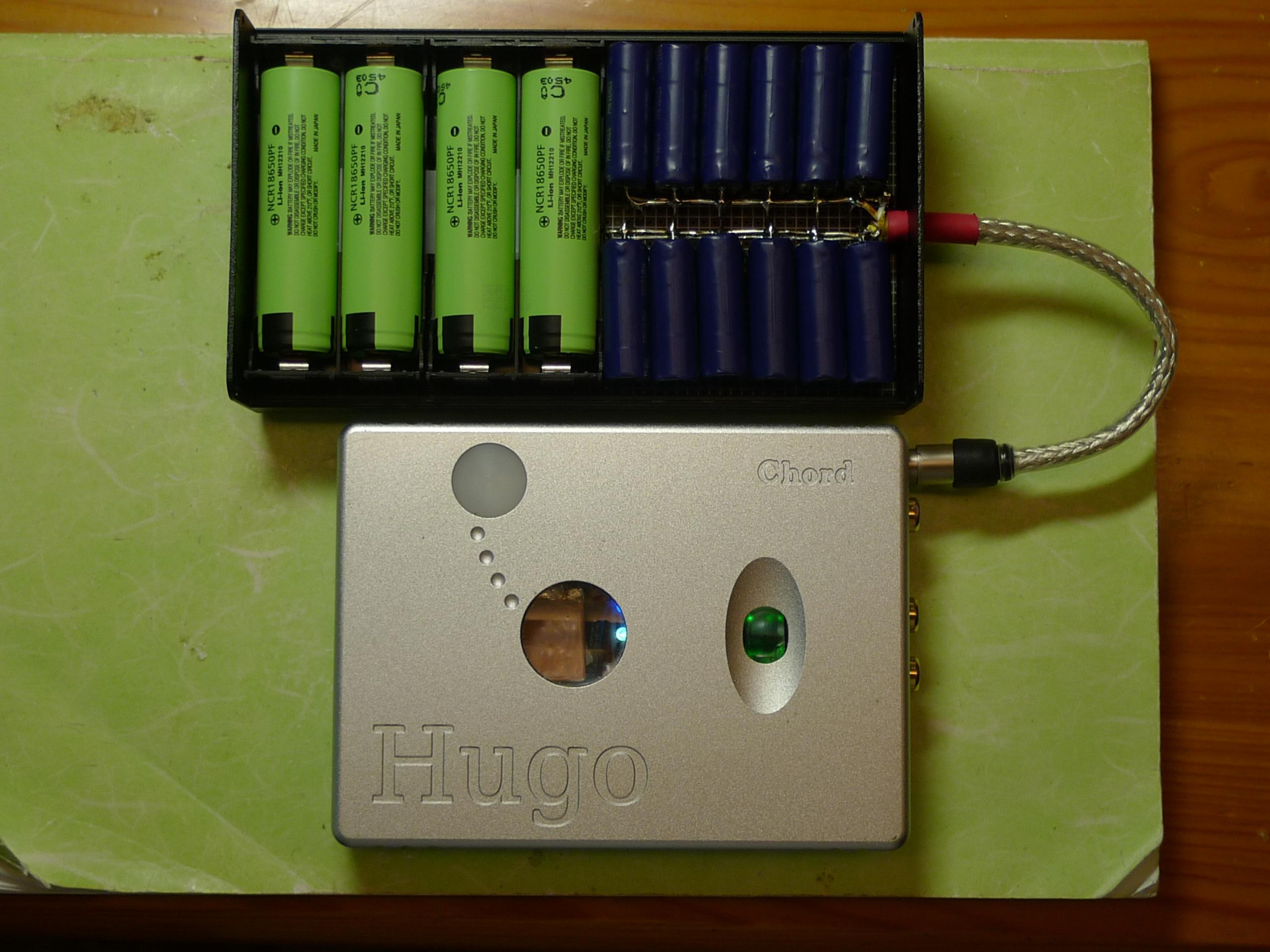

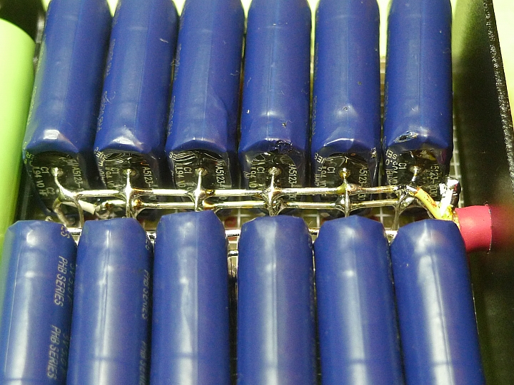

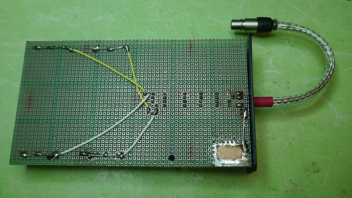

Using a 18650 battery to charge supercapacitor and then power it directly from the supercapacitor without LDOs. This is much simpler, anyone can DIY without the PCB.
According to experience, it is better to use multiple supercapacitors in parallel.
Supercapacitors have poor voltage endurance performance. If you use a general DC power supply, even if you use LDOs, there is still a risk of damage to the supercapacitor. If LDOs are not specifically protected, LDOs are easily destroyed by the discharge of supercapacitors. Therefore, using a stable output battery to charge supercapacitor is the most ideal method.
