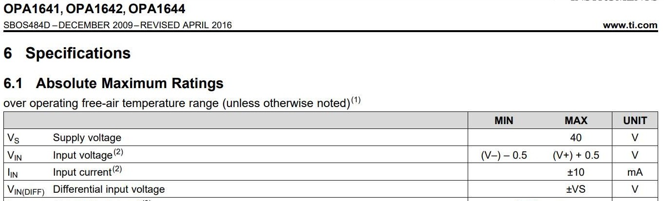

If I'm not mistaken, opa1642 is a real JFET. It has rail to rail differential inputs, it doesn't have antiparallel diodes. Svadim79, if you have some DC voltage between the inputs of the I/V converter, maybe opa1642 is better. The GBW is a little small but who know, maybe it sound very good, why not.
OPA1642 common-mode max positive input range is (V+ -3.5V), so clearly not rail-to-rail input. One of the best OpAmps for buffer or non-inverting low gain configurations with high source impedance. For I/V duty its probably not the best choice.
Correction: PMOS input stage, not NMOS, as far as one could infer from the specs.OPA1656 is NMOS only.
