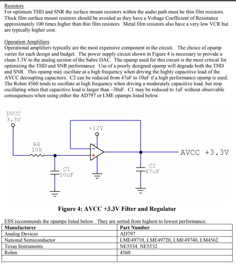

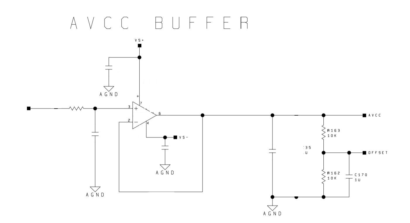

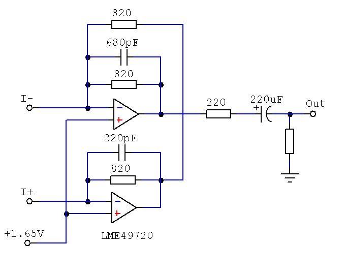

Victor's two opamp output stage is one way to go for that (at the link you gave), but it may not have as much filtering in as would be optimal. Still, it looks pretty reasonable.
Regarding AVCC, it is best to have two AVCC supplies, one for each channel. Otherwise channel separation suffers and it doesn't sound as good that way.
Another thing to consider is that the impedance from the AVCC supply to the dac chip not only includes the wiring from the AVCC supply to the dac chip, but also the ground return impedance from the dac chip back to the AVCC supply. That's why I like to mount circuitry on the back of the ground plane, it keeps the ground return impedance part of the power supply loop at a minimum.
To use an LT3042 to best effect, it should be used as a voltage reference that is then the input signal for a dual opamp AVCC supply. Something like a LME49720 is good to serve as the dual opamp part. I assume you have seen the circuit before and it is the one I use, one opamp section of the dual opamp chip for the left and one for the right AVCC supply.

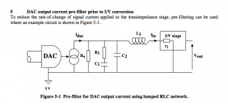

Just so we are talking about the same things, I will post the recommended AVCC supply schematics below, along with Victor's output stage schematic.
EDIT: When you linked to Victor's post, it occurs to me you could also be thinking of using LT3042 as a single supply, then use 3 x 1800uf for each AVCC channel. Although that might be very close to what Victor did, I would not recommend it for best sound quality results. AVCC turns out to be really critical and although THD @ 1kHz might look okay, it still won't sound very good in the bass and in terms of stereo as compared to the recommended supply, IMHO.
The AVCC buffer in the second picture is the same as the AVCC supply shown in the first picture. The only difference is the second picture also shows how to use two 10k resistors and a 10uf cap to make the reference voltage for each channel. That would then be the same as the terminal labeled +1.65v in the third picture. A problem we sometimes have is that there may be more than one name for the same thing if different people have used different names for it at different times. In any case, the AVCC "reference voltage" or "offset" is equal to one half of AVCC voltage which comes out to be right around +1.65v. There is another voltage that is 3.3v which is the input voltage to each of the two opamps. Sometimes that may be referred to as a reference voltage too, but obviously it isn't the same as the 1.65v reference. The +1.65v reference is only used by the output stage, either Victor's output stage or the ESS recommended output stage (which is similar to what I used).
What I did the last time I worked on my AVCC supply was use at an LTC6655 3.3v reference for the 3.3v input to the two AVCC opamp supplies. It helps for that particular 3.3v input voltage to be very clean and low noise to start with. It is labeled DVCC in the first picture, but the actual DVCC supply is too noisy for me, so I used my own clean 3.3v chip to make that supply. An LT3042 could be used for that I guess if that is what you have available.

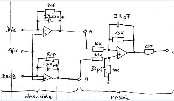

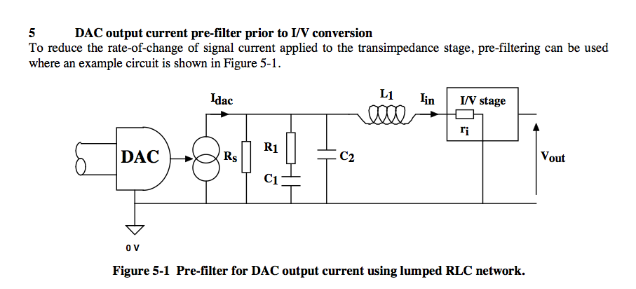

To make sure we all are seeing things the same way, the third picture above is Victor's output stage, not an AVCC circuit. For comparison, I will post the output stage I used, which is similar, but not exactly the same as the ESS circuit.
Also, to further try for more clarity, I will post a picture below showing my AVCC supply and the 'downside' part of my output stage. The AVCC components are outlined in RED color, and 'downside' output stage section is in BLUE.

system54, Thanks for the picture, that makes it a lot easier to imagine what is going on. Since you are talking about a possible case for the clock, I assume you mean you found 100MHz (or whatever the clock frequency is, 80MHz?) noise that maybe gets smaller when you put your finger on the clock? Or maybe the big red film cap has got some clock noise radiating out of it (I hope not, but it's down in that area)?

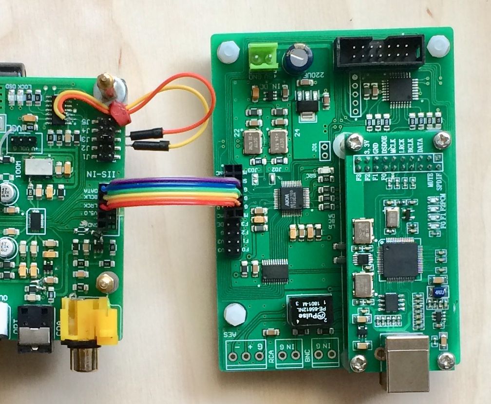

i can already say that the nz2520sd (49.152mhz) sounds better than the external Clock implementation.
the case is only for fine tuning, i thing the Radiation is gone now, i will measure tomorrow.

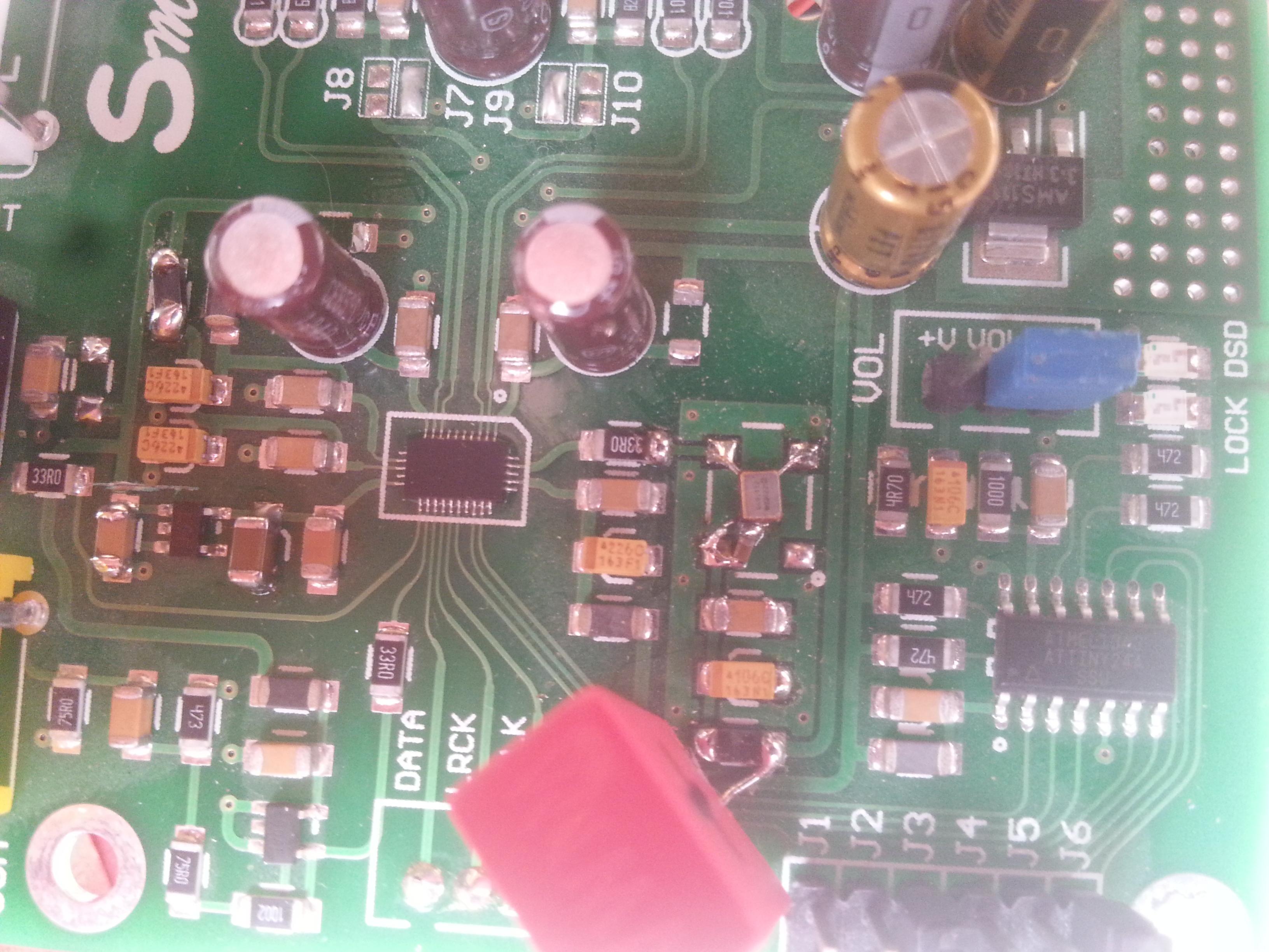

Thought I might pass along an interesting lesson I learned the hard way. I use a crimper tool and some ribbon cable to make interconnection cables as shown running between the two boards in the picture below. When the wires are small diameter as they are with the ribbon cables, I also put a dab of solder on each crimp before assembling the pins into the shells. So far, so good.
I had a wire break off right where it goes into the shell caused by repeated installation and removal of the cable. Maybe I didn't separate the ribbon wires from each other enough for best strain relief either.
Anyway, I used a little jewelers screwdriver to lift the retainer on the shell where the broken wire was, and used a little round poke tool to push it back out of the shell so I could fix it. Once out, I soldered the wire back on where it had broken and reassembled the connector.
Checked it out with a ohmmeter and it looked good. Not long after I started having trouble with DPLL bandwidth for DSD. I couldn't get the DPLL bandwidth down as low as I could before. I checked out various things including ringing out the ribbon cable again, but didn't find any problem. Among other things, I then verified with a scope that all the signals were coming across through the ribbon cable including probing at the connector or away from it on the circuit board traces. Signals looked good. No problem found.
But there was one funny thing, if put my finger on the cable, or near it on the circuit boards I could change the DPLL lock-in-ability.
To make an even longer story short, I took apart the connector and looked at it carefully with a microscope. For the pin insert I removed to re-solder (female), the springy contact points were not as tight as they used to be. Very careful examination showed there was contact, but the contact force was very small, more of a sliding fit than an interference fit.
As it happens pin header pins are .025" square. The poke tool I used to push out the pin was found to measure at .032" which evidently was enough to permanently deform the contact point's springiness on the female pin insert, but only slightly. The result was that there was a connection that measured fine every way I had to measure it, but was now apparently somewhat noisy.
Made up a new cable and connector assembly, problem fixed. Also made a poke tool that measures .023" round. It works fine, verified it causes no permanent contact deformation with microscope.

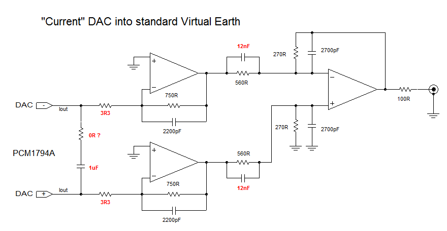

Good question about opmaps for dac output stages. It could be that LME49720 is hard to beat so long as it can supply the necessary output current. For ES9038PRO a higher current capability opamp was needed and the next best choice was probably OPA162x.
The problem is there are really two problems. One is the designing an output stage that looks like a good choice on a schematic and in simulation. The other problem has to do with a mostly unseen problem which is the RF leakage coming out of the dac outputs. Output stages are designed to finish the reconstruction process started with the last interpolation filtering inside the dac, but the output stage has to deal with some very HF content. That means the opamps have to be able to tolerate some unquantified RF/HF junk that can potentially get amplified to the point it can then get demodulated in semiconductor junctions and cause shifting bias voltages which in turn generate distortion that may be hard to characterize because it can be maybe kind of non-stationary.
And of course, even if we can find some opamps that can handle the HF junk well and be tolerant of it while they are being used to help filter it out, there is the question of whatever remaining HF junk may make it into a power amp and what it might do to the sound there.
All this is nothing new, people have been thinking about it for a long time, but it is one of those things that may be hard to model so cut-and-measure methods may be what we are left with.
In that regard I will post some output stage schematics below that maybe can help illustrate.
