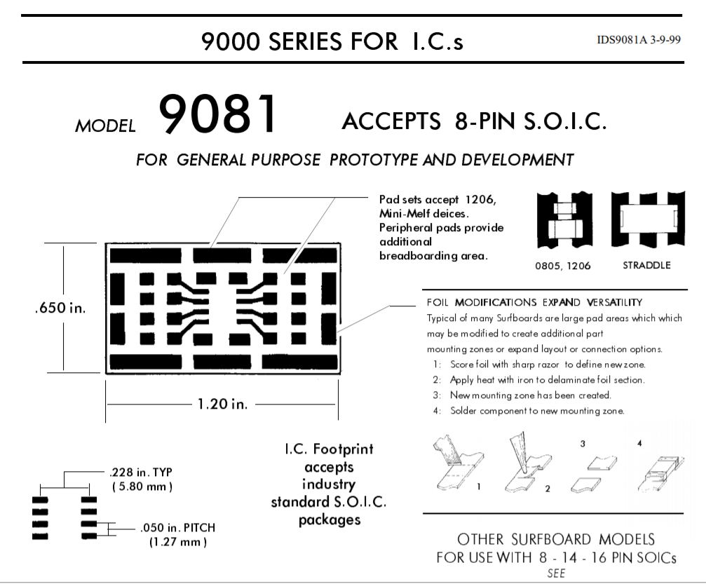

We did talk here briefly about a possibility of using Surfboards (or equivalent) and SMD resistors and caps instead of some of the leaded resistors and caps. If there are people who think that kind of SMD construction might be doable and of interest, I would encourage anyone to give it a try.
If enough people think they might want to go that way if given an option, maybe the BOM could be expanded to include parts for an SMD-on-adapter version.
If there is any interest for something like that, please raise your hand (figuratively) so we can see how many. Otherwise, we will stick with what we have already for the parts list, and only make a few corrections/updates.
So far no hands raised, nor any other affirmative response.
I will give it another day or so in case of any late responders. If none, then we can proceed as is.
While waiting for a part to arrive to get me going again, did a little thinking about an SMD version of the through-hole output stage schematic. It would be based on three model 9081 Surfboards with the outline as in the pic attached below.
The three Surfboards would be enough hold all the components. If laid out flat they should be able to fit in about the same space as the leaded component version, so they could probably mounted on the same size PCB.
I ordered a few surboards to take a closer look at how that might work. Need to order a few SMD resistors and capacitors too. Be something interesting to try out.
After looking into SMD parts a little more it turns out the resistor values we need are not available in tighter than .1% tolerance, at least for in-stock items. So, ordered the resistors and caps that are reasonably available for an SMD output stage using the new filtering.
Actually, I think it might turn out to be easier to assemble than the through hole (leaded) component version. We'll see, I guess, when all the parts are here. A possible downside for some modders is that there are no sockets for trying different opamps, not that swapping opamps should be needed. LME49720 is an excellent choice for this application.
It probably helps to have all the resistors be tight tolerance because it helps to make the output stage more effective at removing common mode noise. Differential combining requires resistors in accurate ratios, and matched I/V resistors keep common mode currents from appearing as differential mode signals.
The 220 ohm output resistors could probably be looser tolerance so long as the input impedance of the power amp or preamp that follows is high enough. However, a couple of good resistors are cheap enough to just use the same kind as for other parts of the output stage and not worry about it.

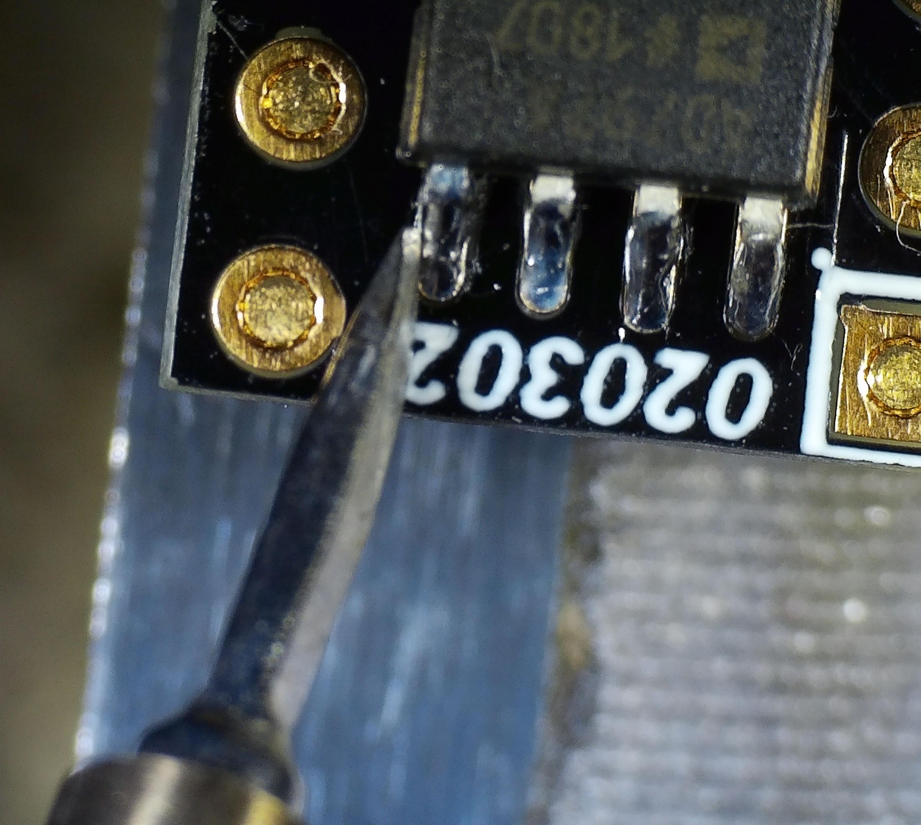

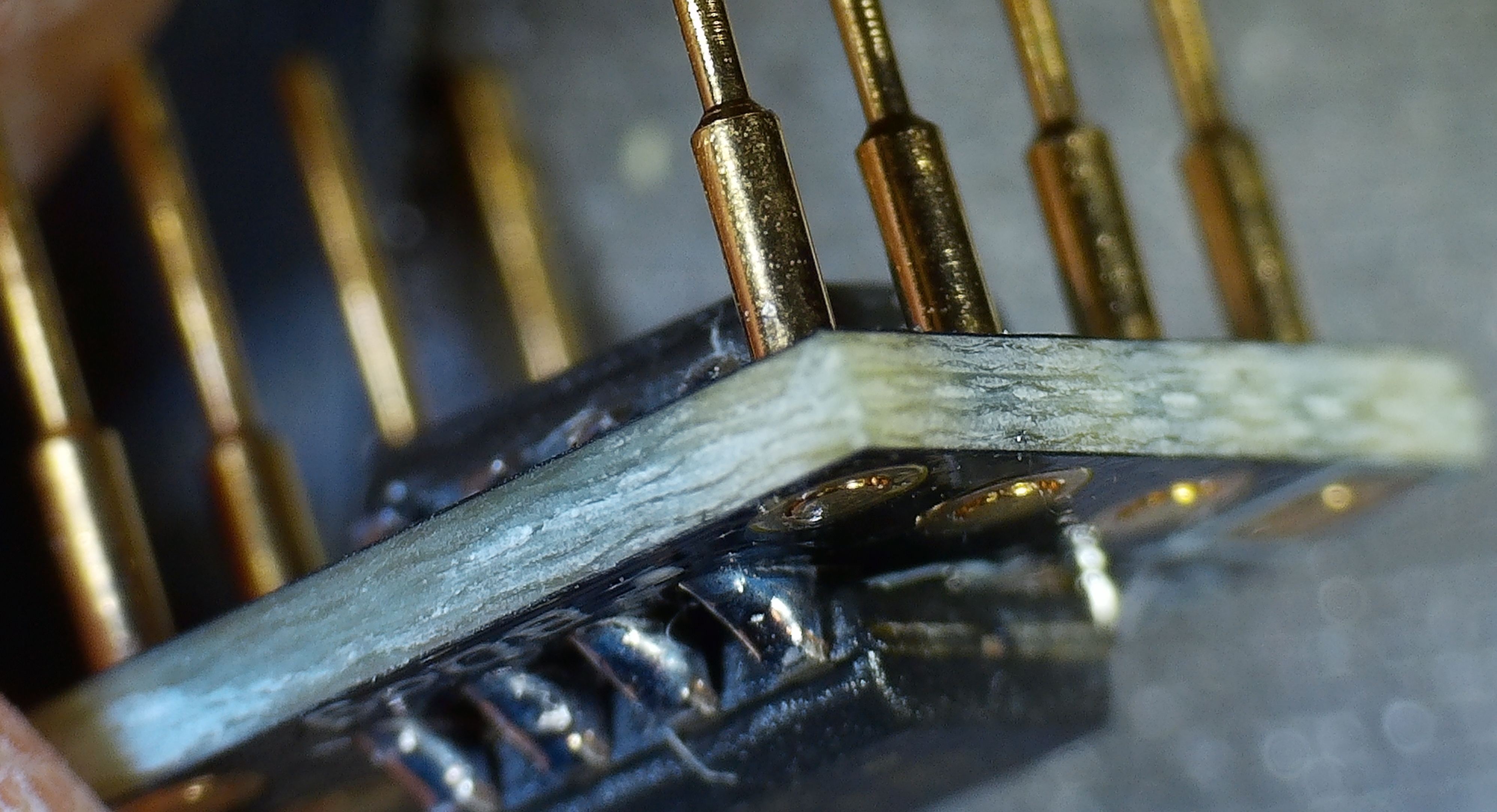

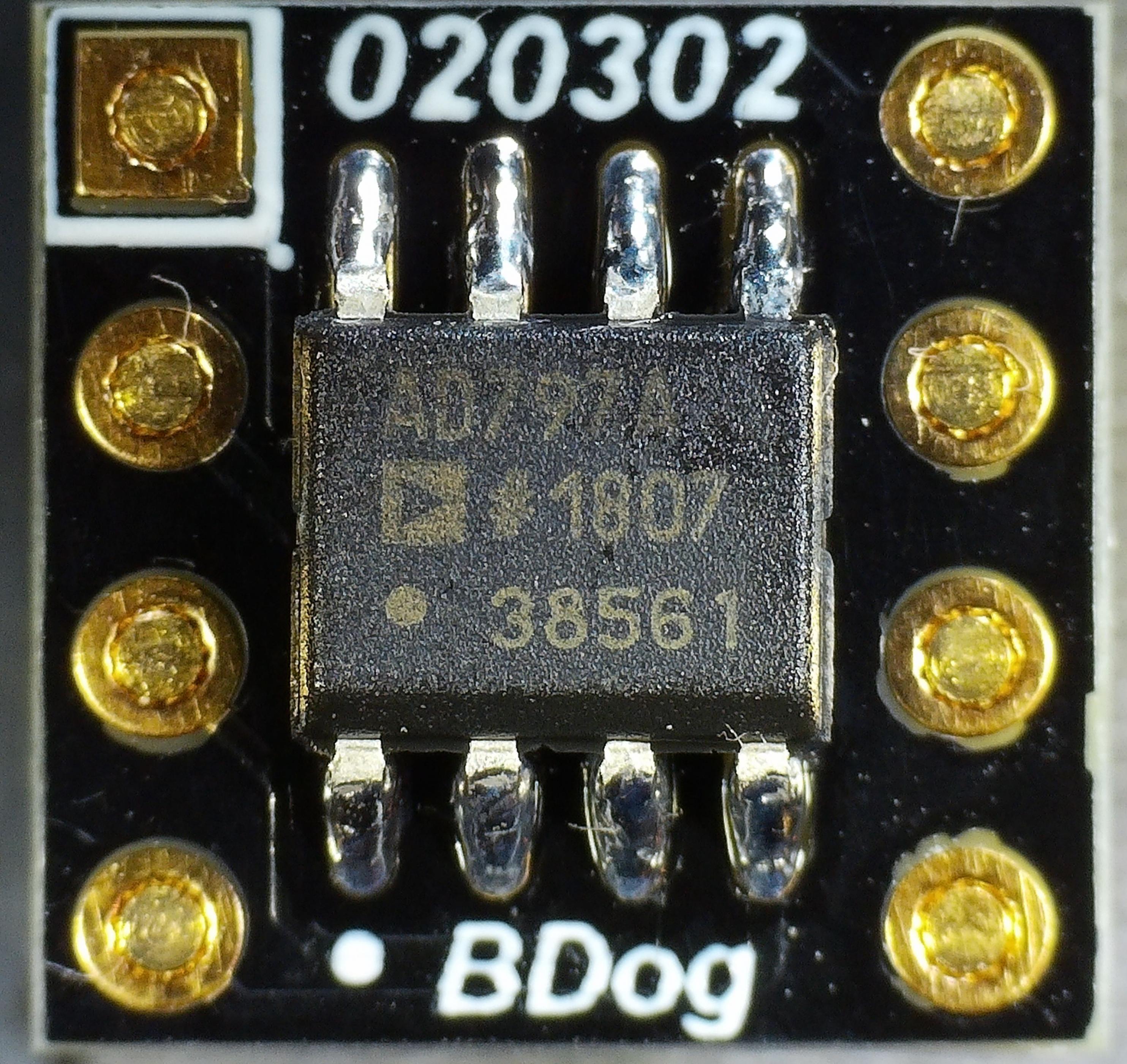

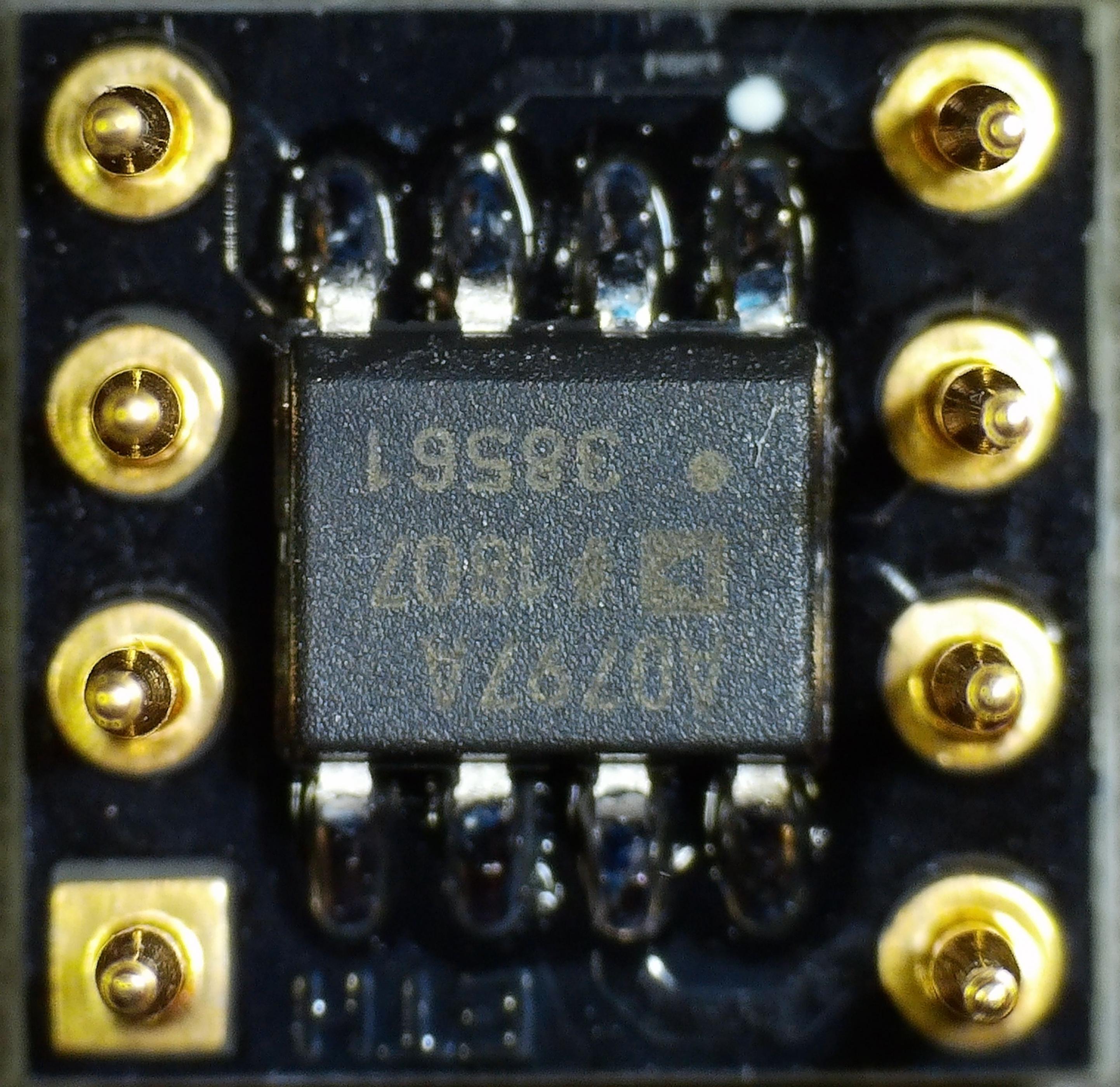

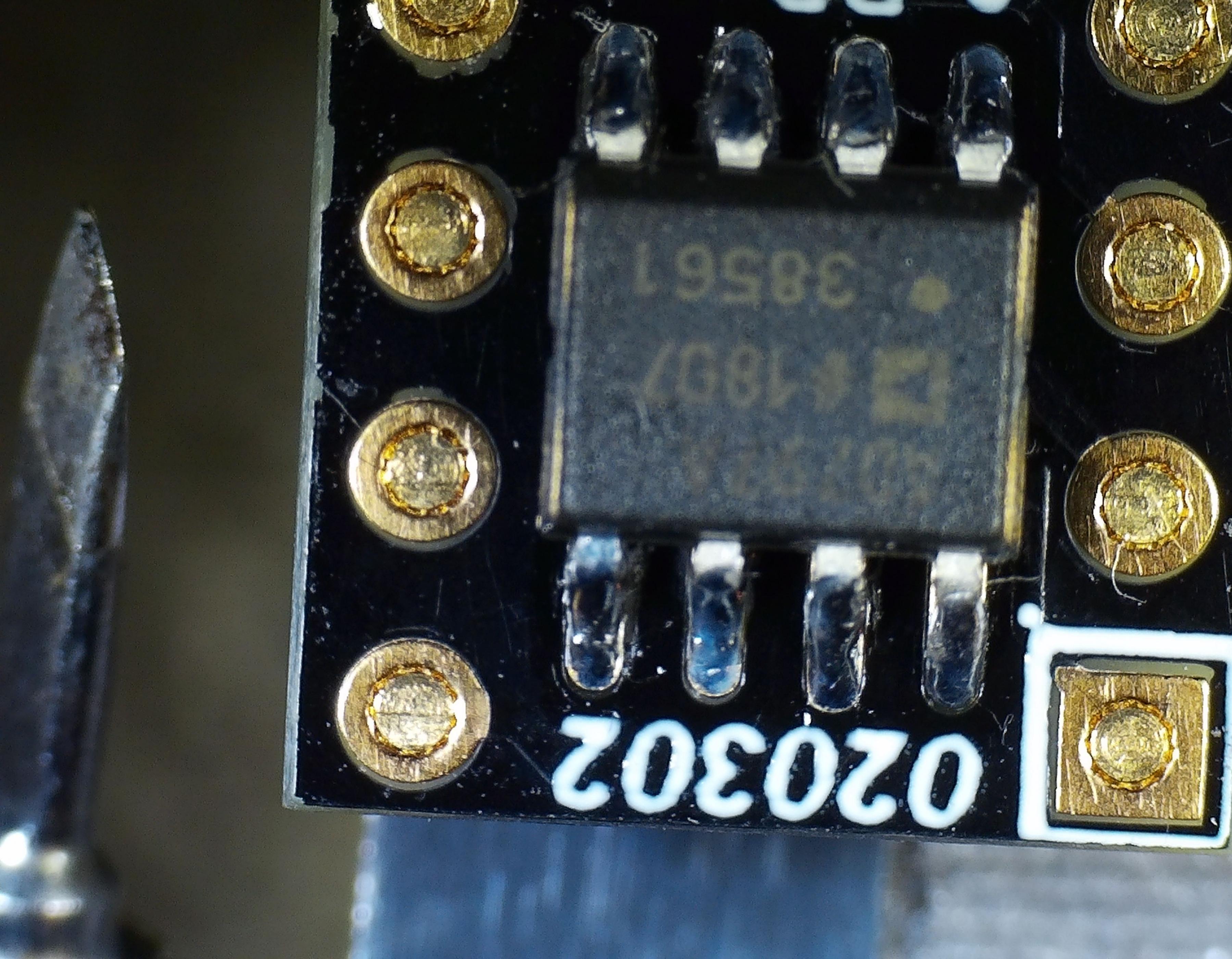

Wanted to say a little bit about preparing to try AD797 for AVCC and about micro-soldering.
First, decided to try some new-to-me SOIC to DIP single to dual opamp adapters. The sockets on my AVCC and output stage boards are wired for dual opamps. AD797 is a single. Turns out there are some very compact adapters that look very interesting for this type of thing: Single to Dual Op Amp Adapter | BrownDog 020302 | Cimarron Technology
Some pictures below of one of the adapters with two AD797 soldered to it. Pics also show the tip of a Hakko micro soldering iron. The tip is a knife edge which makes it thin enough to fit between pins and only touch and heat the desired pin. Because the tip has a rectangular cross section, it has enough area for good heat transfer. What it can do is truly amazing. I soldered AD797's in place one pin at a time, no problem.
I also tried the tip on some scrap boards for pin lifting use. It is possible fit the knife edge between pins, melt the solder for on pin, the wedge the knife under the pin and lift while the solder is still molten. Make it incredibly easy for the pins I tried it on.
Nice adapters, don*t use dil socket, use right solder because each solder has different sound even with the same opamp. This joints don*t look perfect...if we are talking about perfection. More solder is not always good. Best conntact has opamp copper pin dirrectly press to golden plated conntact of adapter. No solder between them or as least as possible. Little solder most just be around pin and surface to keep this conntact tight.
My receipe... put opamp on right pin position, then solder pin 1 or 8 that are not important. Then use Mini-Alligator Clip with Smooth Jaws to press opamp to surface and do fine quick joints. I use wbt solder. At the end i put pins into adapter and solder it. Clean everything with isopropil and toothbrush.
