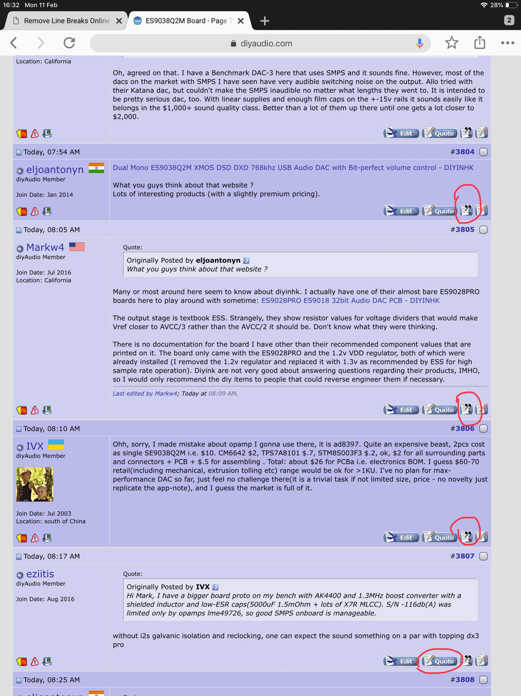

Dual Mono ES9038Q2M XMOS DSD DXD 768khz USB Audio DAC with Bit-perfect volume control - DIYINHK
What you guys think about that website ?
Lots of interesting products (with a slightly premium pricing).
Many or most around here seem to know about diyinhk. I actually have one of their almost bare ES9028PRO boards here to play around with sometime: ES9028PRO ES9018 32bit Audio DAC PCB - DIYINHK
The output stage is textbook ESS. Strangely, they show resistor values for voltage dividers that would make Vref closer to AVCC/3 rather than the AVCC/2 it should be. Don't know what they were thinking.
There is no documentation for the board I have other than their recommended component values that are printed on it. The board only came with the ES9028PRO and the 1.2v VDD regulator, both of which were already installed (I removed the 1.2v regulator and replaced it with 1.3v as recommended by ESS for high sample rate operation). Diyink are not very good about answering questions regarding their products, IMHO, so I would only recommend the diy items to people that could reverse engineer them if necessary.
Ohh, sorry, I made mistake about opamp I gonna use there, it is ad8397. Quite an expensive beast, 2pcs cost as single SE9038Q2M i.e. $10. CM6642 $2, TPS7A8101 $.7, STM8S003F3 $.2, ok, $2 for all surrounding parts and connectors + PCB + $.5 for assembling . Total: about $26 for PCBa i.e. electronics BOM. I guess $60-70 retail(including mechanical, extrusion tolling etc) range would be ok for >1KU. I've no plan for max-performance DAC so far, just feel no challenge there(it is a trivial task if not limited size, price - no novelty just replicate the app-note), and I guess the market is full of it.
Hi Mark, I have a bigger board proto on my bench with AK4400 and 1.3MHz boost converter with a shielded inductor and low-ESR caps(5000uF 1.5mOhm + lots of X7R MLCC). S/N -116db(A) was limited only by opamps lme49726, so good SMPS onboard is manageable.
without i2s galvanic isolation and reclocking, one can expect the sound something on a par with topping dx3 pro
