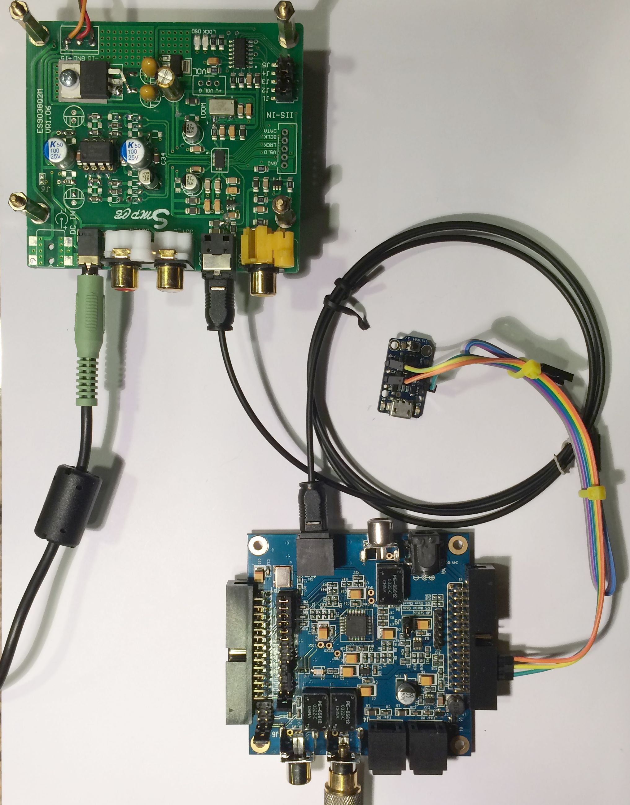

For some time I have wanted to see how far I upgrade one of the ebay Sabre DAC boards to sound as close to a Benchmark DAC-3 as possible. I'm getting pretty darn close, but I think there is a little more that can be done. More on that later, but for now a couple of photos attached below. As can be seen, output stages are fully balanced IV, power supplies are considerably cleaned up, and a low phase noise oscillator has been fitted.
very impressive!
Attached below is another photo of work on the DAC upgrade project. It shows an effort to apply one of the techniques used in Benchmark DAC-3 to improve ebay Sabre sound quality. Benchmark uses an SRC chip before the DAC chip to upsample all input to 211kHz. That allows the DAC to use a minimum phase slow roll-off reconstruction filter without producing audible transition band filter artifacts.
At this point, I have used a $30 MiniDigi SRC board that has been slightly modified to allow bootup configuration to be set via I2C bus control by a 3.3v Arduino Trinket. The SRC chip is rated for -125dB harmonic distortion. The Trinket configures the SRC to convert any input sample rate to 24/96 output. Thus the ebay Sabre DAC always receives 24/96 input. That is sufficient to allow CD and DVD audio to be played back using the Sabre minimum phase slow roll-off reconstruction filter without producing audible transition band artifacts.
Possible improvements to this setup include upgrades to the MiniDigi SRC chip and SRC oscillator to give -140dB harmonic distortion and 196kHz SRC output capabilities. Not quite up to the 211kHz pre-Sabre SRC conversion done in Benchmark DACs, but getting closer. Cost of the SRC upgrades is expected to be pretty low. SRC upgrade chips are < $15 and ultra-low phase noise clocking may not be necessary at this stage (although it should be reasonably good, similar to the original oscillator). The Sabre clock oscillator upgrade already done provides for ultra-low jitter sound reproduction quality.
As a side note, I might mention that the oscillator clock upgrade done on the ebay DAC board made a surprising-to-me amount of improvement in sound quality. Prior to the replacing the oscillator, cymbals and percussion still didn't sound close-enough-for-me to the Benchmark DAC here used for comparison purposes. The oscillator upgrade made a substantial and very satisfying difference to my ears. IMHO it is a necessity for best DAC upgrade results.

Fitting it onto the ebay DAC PCB was a bit tight. The Crystek case is a bit larger than the original oscillator. Also, the solder pad locations are the same, but the Crystek pads are slightly larger than original. To provide a little additional clearance around the solder pads on the ebay DAC, I used a hobby knife to trim away a little of the ground trace copper around each pad. Not too much though.
Maybe this would be a good time to also mention that there is a pdf available from ESS with recommendations for op-amps, output stage circuits, and AVCC+ power supply conditioning circuits (one for the left channel and one for right). It's good reading: http://www.esstech.com/files/4514/4095/4306/Application_Note_Component_Selection_and_PCB_Layout.pdf
There is also a copy of an early evaluation board schematic which shows how to derive the output stage 'offset' voltage from the highly conditioned 3.3v AVCC+ supplies. The offset voltage should be at 50% of AVCC+. http://www.esstech.com/files/5114/4095/4310/Sabre_8_2Channel_64PIN_V3_SCH.pdf

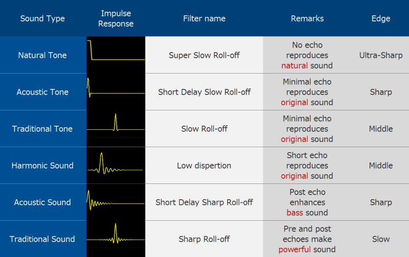

2. Upsampling using various dithering techniques or simply oversampling without any dithering, in my system, made the sound smooth with loss of dynamics. Both move the out of band noise further up and improve the transient response (lessen ringing) but the effect was almost like going deep into current mode on the chip. Details and imaging improved the loss of dynamics and timing.
3. Keeping the original bitrate without upsampling/oversampling with a Slow Filter yielded a good compromise.
YMMV but there is something to be said about Japanese engineers describing various impulse responses and the sound. I am able to relate to it.
Here is an interesting thread that discusses the impulse response and sound
AK4490EQ Filter adjustment - Gieseler Audio - StereoNET

Hi madds1, Interesting comments there. Thank you.
Believe optical spdif is only good to 96kHz and is not rated for higher.
For software SRC, I tried upsampling a song from a CD to 96kHz using Reaper DAW and 'Extreme High Quality' SRC mode in Reaper when rendering the output wav file. It sounded quite good to me, but Reaper's best SRC is known to be exceptionally good. Not as good as Weiss Saracon which is probably the best, but maybe a pretty close runner up.
My reason for wanting to use hardware SRC is so that it can be automatic and work anywhere.
Also working on finding a cheap USB to SPDIF interface, since USB connectivity would be a nice feature. Ordered an ebay board to try, but it won't be here for a few weeks.

The SRC chip is a pretty good one and could be booted up using an Arduino or any simple microcontroller that is I2C or SPI bus capable. http://www.ti.com/lit/ds/symlink/src4392.pdf
Have to start thinking about other options I guess. It is always possible to software upsample, but it is rather inconvenient compared to using real-time hardware.
If anyone is interested, Reaper is a good DAW for upsampling and various other uses. 60-day evaluation period and non-commercial licenses are cheap. I like it. Runs on Windows and Macs, too.
Anyway, maybe if there is enough interest we could layout a PCB design for people wanting to assemble a little hardware SRC project? The parts should cost should be fairly modest.

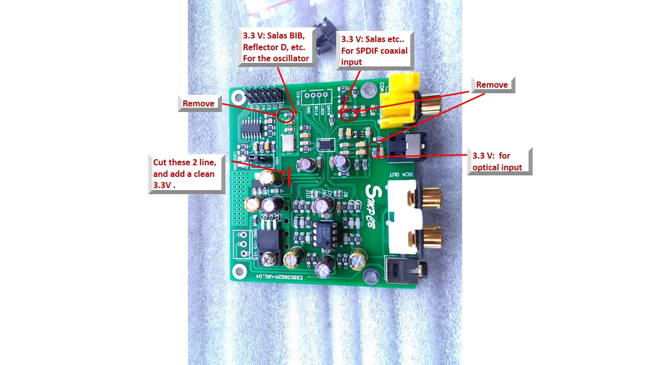

Upgrades
I made some upgrades to improve the sound of the board (ver 1.04). Some important steps are listed here:
1. The two power lines are cut, and a separated 3.3V is added, see picture.
2. The oscillator is powered by a separated 3.3 V Salas BIB (very low noise and among the best DIY power supply for digital). It made a high impact to the sound.
3. Also, I powered the SPDIF inlet(s) by an individual 3.3 V supply too. The original 3.3 V is shared with all the analog power(s) of the DAC chip (bad idea), yielding to the highly degraded quality of both coaxial and optical inputs. I am using mainly the coaxial, so the optical part is disabled now, but the optical input can be activated any time if needed.
4. I removed the onboard coaxial RCA, because of bad contacts both to the GND and signal.
For separated power lines, we have to remove some of the inductors (grey coloured ones), those are labeled by red circles.

I have some mod experience with previous version ES9018K2M board.
And yes, 1) low phase noise clock and 2) low noise regulator are the 2 most significant mod to improve the sound quality IMO.
For more detail write up you can refer to below link for modification about:

hi there..many thx for your attached images..I´ve also seen that u soldered some connectors to the I2C-pins on it..
have u something getting to work over it ? and with what ? do u use an Arduino for that ? but many thx+greets again

Just a note, SRC doesn't improve impulse response, it has the exact same issues as normal oversampling.

Nothing has been done with it yet. Just planning on taking a look as time permits.
