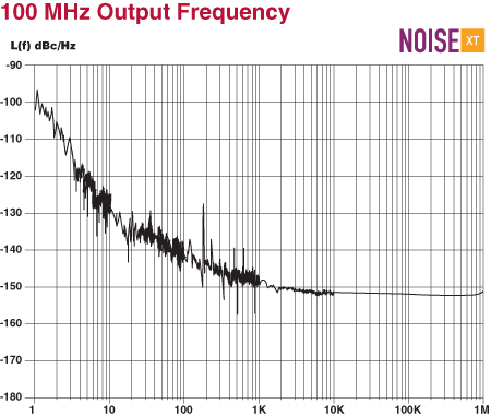

Here's an example of a 100MHz multiplied SC cut, OCXO.
The phase noise at 10Hz is around 30dB improvement over Crystek.
At 1Hz it would be even greater, but the trade off is clearly the HF noise floor.
