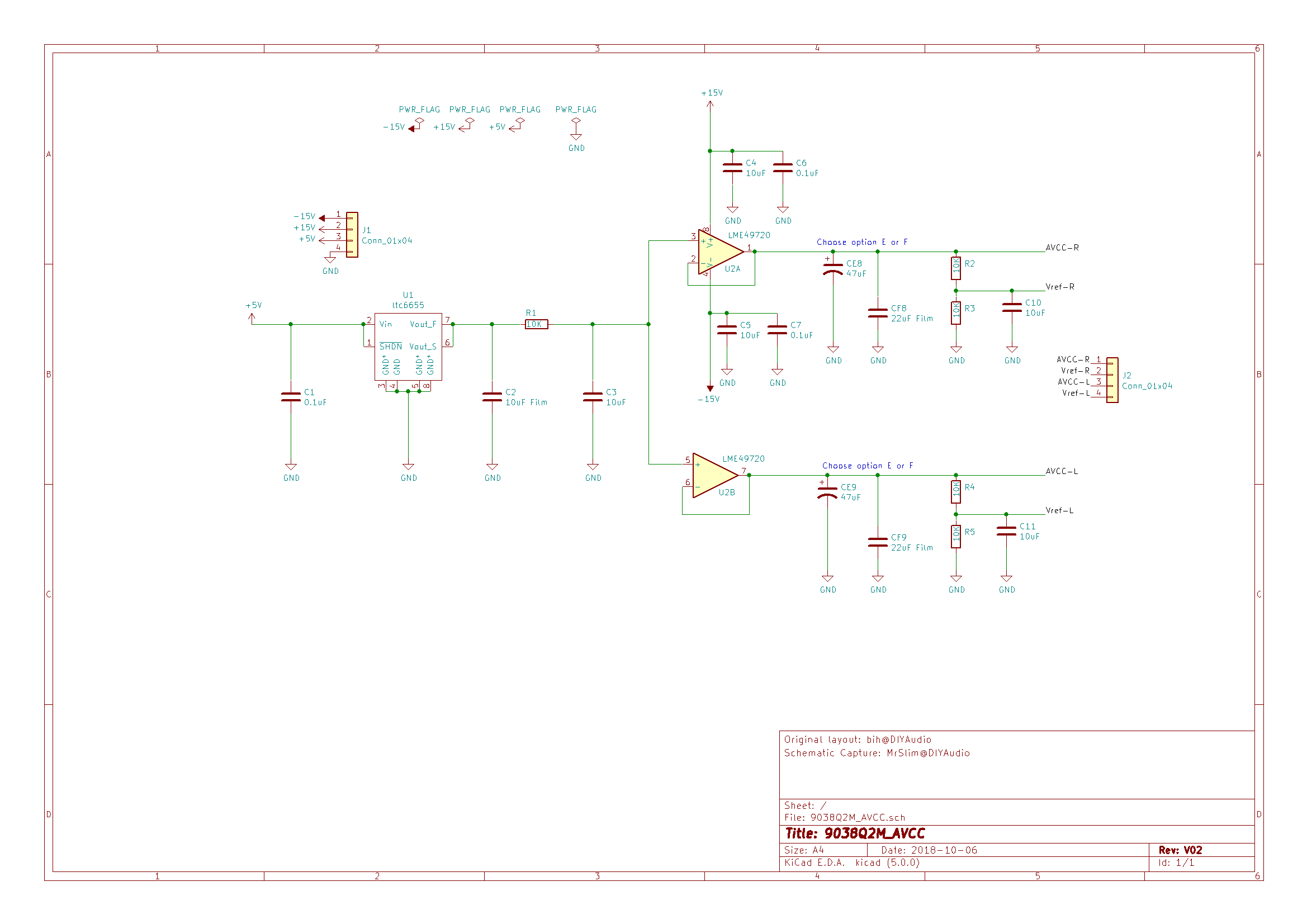

The AVCC wiring drawing you posted looked okay, given a quick cursory check. However, connection isn't the only consideration. Layout is very important too. It isn't shown on a schematic, but its important to do it reasonably well for good results. I would suggest you look at how the opamp and other components are wired up in the pics I posted of my AVCC board. If you can't find the pics, maybe we can help look around for them.
Ooh, those 100k and 47k resistors right next to the caps? Hmm then i dont need to even wire the output at the caps, i can do it at those resistors (once they're removed).Once you get the caps out, you can see if anything else is connected to the RCA jacks.
Great! The I/V stage wiring too?The AVCC wiring drawing you posted looked okay, given a quick cursory check.

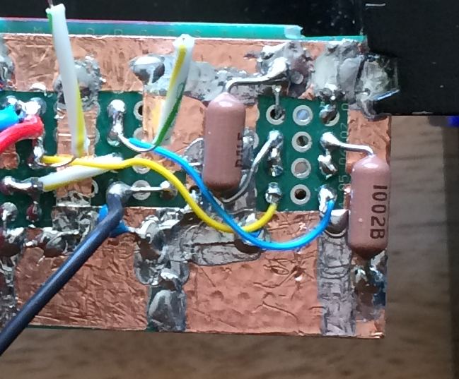

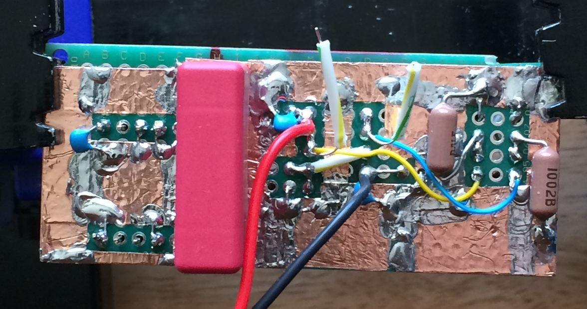

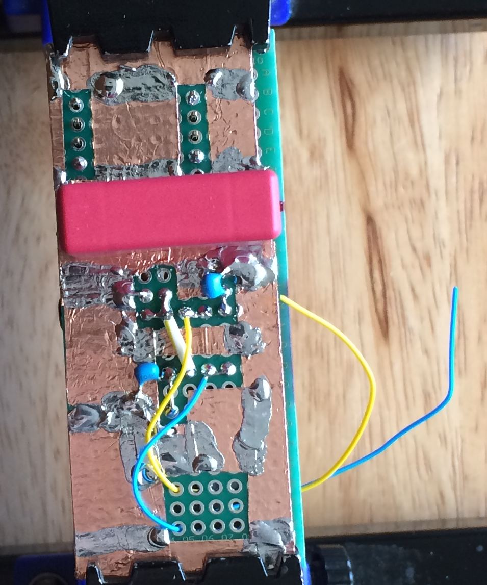

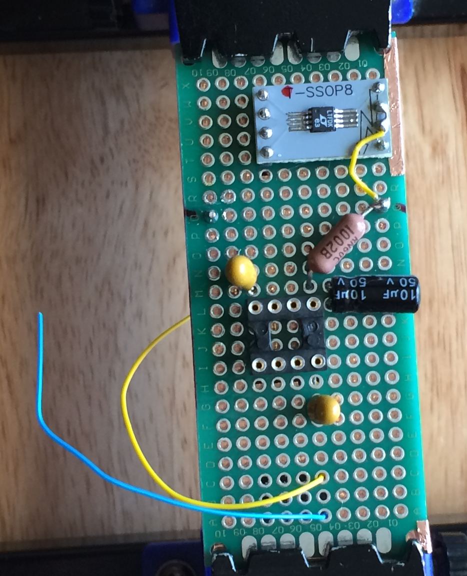

For the output stage, there are some detailed pics of my layout in the output stage instructions zip file I linked to.
Some other pics of AVCC board and Vref divider during construction below. You should be able to look at both sides and figure out what you are looking at in terms of the layout plan from the schematic. (First and last pics are upside down relative to how they mount to the bottom of the dac board ground plane that would be below when the two were attached together, sorry if hard to visualize that way. To put it another way, the pics are shown right side up as they would be seen once attached to the dac board, and when the dac board is also placed right side up.) Last pic just shows the Vref divider part of the circuit over at the right side as it was being laid out. In the first pic, the two wires in the middle sticking out into space unattached on one end are the outputs that get soldered to the bottom of the AVCC cap vias on the bottom of the dac board.
The idea is to get the decoupling caps right at the opamp power pins, keep the analog inputs separate from the outputs, keep one channel wiring not too close to the other channel wiring, try to keep wiring short and direct, etc. Lots of things to think about when laying out a circuit.

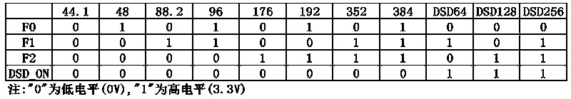

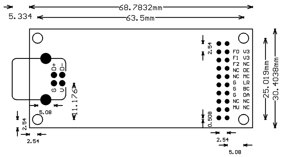

USB to AK4137 requires: DATA, BCLK (sometimes called BICK), LRCK (sometimes called WCK or FSCK), DSD_ON (sometimes DE), FO, F1, F2, MUTE, and GND. There should be one ground for each signal wire. If using ribbon cable as recommended, every other wire should be a ground. The ground wires should be individually connected to ground pins if possible, one ground pin per ground wire at each end of the ribbon cable. The most important signals to have an associated dedicated ground wire are the I2S signals: DATA, BLCK, LRCK.
It is strongly recommended to use gold plated pin connectors for AK4137 outputs and for dac board I2S inputs. Either gold or solder, but not nickel or tin plated connectors. That is to help minimize jitter.

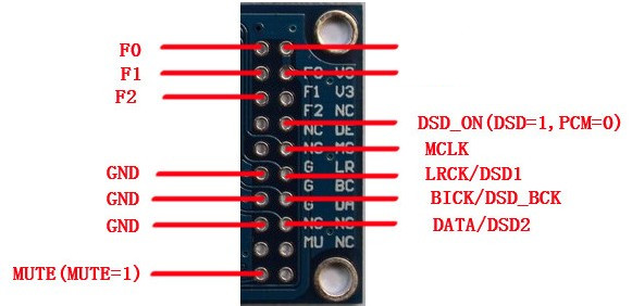

Some diagrams below showing where the AK4137 board would expect the input signals as listed above. The two unlabeled red lines at the top right in the middle diagram below are +3.3v outputs from the USB board. They should not be connected to anything on AK4137. No MCLK is needed from the USB board.
NOTE: As explained before, no Chinese XMOS or Amanero board supports Native DSD since it takes paid ASIO drivers. DoP DSD can pass through Windows if Windows Sound Engine doesn't do any DSP on the digital audio stream, something that cannot be assured. Also, AK4137 does not understand DoP format so DoP would have to be played with the USB baord directly connected to the dac board I2S inputs.

Thank you, those pictures are pretty good, i cross referenced with the diagram and it makes a lot of sense i see where everything is and keeping everything tight and efficient.Some other pics of AVCC board and Vref divider during construction below. You should be able to look at both sides and figure out what you are looking at in terms of the layout plan from the schematic. (First and last pics are upside down relative to how they mount to the bottom of the dac board ground plane that would be below when the two were attached together, sorry if hard to visualize that way. To put it another way, the pics are shown right side up as they would be seen once attached to the dac board, and when the dac board is also placed right side up.) Last pic just shows the Vref divider part of the circuit over at the right side as it was being laid out. In the first pic, the two wires in the middle sticking out into space unattached on one end are the outputs that get soldered to the bottom of the AVCC cap vias on the bottom of the dac board.

You don't show the opamp decoupling caps. There is no cap implemented across the inverting inputs of the I/V opamps, it was considered and rejected. There is a schematic in the output stage zip file that shows all the components.
Whether you decide to use the components shown in the BOM or the other schematic parts values (such as used by Topping), it matters that the parts are good quality. Use NPO or C0G for any caps in the audio path. Bypass ceramic caps are X7R, do not use NPO/C0G for those. Resistors are 0.1% or better if at all possible. If not possible, distortion will probably be higher than it would be with the correct parts. If only 1% resistors are available, one could measure the actual values and try to match them symmetrically for the I/V opamp and the differential summing opamp for each channel. The idea is to help cancel out common-mode distortion which will work best if the resistor values are exactly matched. Doesn't matter so much if the two stereo channels are exactly the same, matching matters the most for the resistors and caps within each individual channel.

Oh, you're right its not in this schematic. So onMrSlim's post, the capacitors C1, C6, C7 and C12 should be removed? Okay, thanks!You don't show the opamp decoupling caps. There is no cap implemented across the inverting inputs of the I/V opamps, it was considered and rejected.
I took the schematic from your .rar with the word document with pictures of the output stage, (the one you linked a few posts ago, from the dropbox).There is a schematic in the output stage zip file that shows all the components.

No! Those need to stay.
I was referring to a cap with no value connected across the + and - dac outputs before going into the I/V opamps. No cap is used there, that's why it has no value on the schematic you used.

Whoops, didnt even see that one! Yeah, thanks for telling me. Seems like MrSlim's post #3003 is the go-to schematic, i will build from there, parts are on the way. As you say, the schematic i picked was just to show the wiring on the perf board images.No! Those need to stay.
I got it, it was a decent help to correlate what was going on the pictures with the schematic.Understood. It does not show opamp power pin decoupling caps. I included it only to help understand what was shown in some pics. That's what the color coding is for.

Page 15 of the TI vref reference design manual shows a chart with different values of caps on the low pass filter cap on the output.
on the current AVCC design it is 10uF tantalum.
Do you think further improvements could be made to the noise attenuation with a larger (say 47uf) tantalum as the chart implies?
Aluminum Electrolytics should be fine. Tantalum has some different properties and is much more non-linear as a function of voltage. In this particular case the difference may not matter since the voltage should be quite stable. You can try 47uf if you want. The 10k resistor works with the cap to make a simple low-pass filter. Increasing the cap value will lower the corner frequency. No harm in doing it, although it will make the filter output voltage take a little longer to settle when the circuit is first powered up. ESS used a 10uf cap with their example opamp AVCC supply, but there is no magic number. 10uf or 47uf, either one is probably fine. Of course, the amount of filtering needed depends on how noisy your voltage reference is and how much noise you can tolerate, but LTC665 or LT304x are both very low noise to begin with so no worries.
