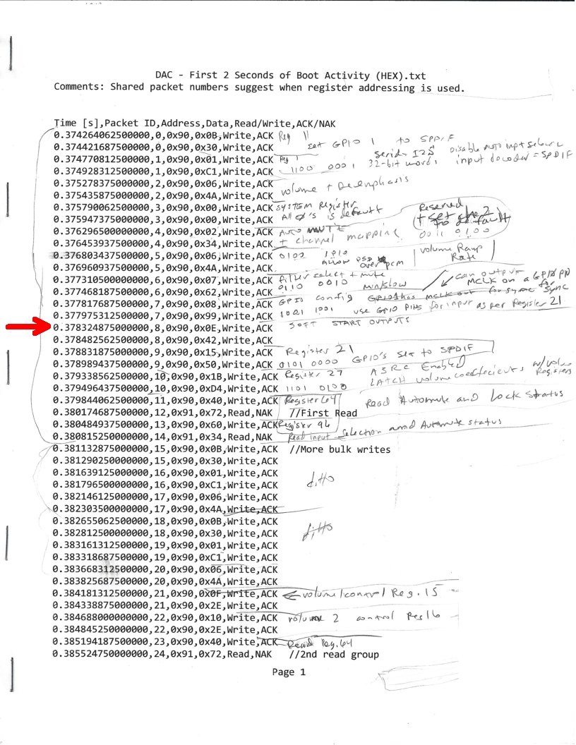

Gentlemen,
Because of the need to control the device registers in order to set PLL bandwidth and other things, a sample $10 ebay logic analyzer printout is attached showing I2C bus bootup activity of a Chinese board. In particular, I would focus attention on the line with a red arrow to the left and the following line. That is where the Chinese MCU enabled the device to start playing sound, an apparent quirk required for the particular chip and not well documented anywhere I have seen.

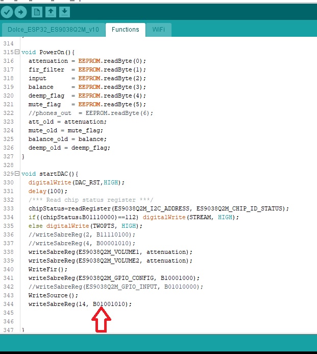

Mark, it took me 3 hours, back in March, to figure out why my DAC doesn't start. I removed the Chinese STC chip and I have replaced it with an ESP32 based board.
My DAC board is the blue one, so its controller chip was STC. I have started to learn how to program it, but a got bored after a couple of hours.
I have finally found (by chance) that bit 6 from register 14 should be "1": soft start when locked. If this bit is "0", always soft start, the DAC won't play.I don't know why!

Hi Thorp, Its not documented in some versions of the datasheet, and its documented incorrectly in other versions (one of them says bit 7 must be 1, which is wrong). As you found out correctly, its bit 6. I found out by watching the MCU boot up the dac, as per the printout.
Apparently they didn't want it to be enabled by default for applications like cell phone audio. The documentation for the part is pretty sparse, don't know why they couldn't at least make it more accurate.

So you are saying that you have to send this register in order to get the chip to work properly?
From what I can see this is register 14 (decimal, as they are numbered in decimal in the datasheet). So this regiuster is set to 0b01000010, which is the default according the datasheet - this is indeed interesting. I would have assumed that I don't have to touch this register at all if I want default behaviour.

No, register 14 is 0b00001010 default and the DAC won't play.
You have to set it 0b01001010 in order to hear some music.
Aha, it seems that is possible to also make the DAC working by setting register 14 to 0b10001010. I will try this setting.

I have tested all 3 combinations for bit 7 and bit 6 of register 14.
They all work.
Interesting. I didn't recall bit 7 working, but I guess my memory could be mistaken. Wouldn't be the first time 🙂 The way its supposed to work is bit 6 ramps up the analog outputs from ground level up to AVCC/2 volts (when dac is locked; lock bit = true). Outputs should return to ground when not locked. Ramping up to AVCC/2 as configured by bit 6 should not work when bit 7 is 0. Bit 7 supposedly initializes and ramps up the outputs to AVCC/2, and supposedly must be set to 1 for the dac to have analog outputs at all. IIRC what actually happens is the outputs ramp up to AVCC/2 and stay there if reg address 14 data is 0x42.

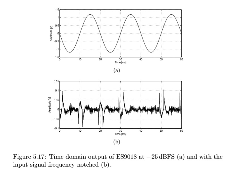

With Sabre dacs it is also ideal to tune the I/V feedback network to try to minimize hump distortion (which occurs at low-ish signal levels). The actual time domain distortion signal may be observable with a scope at high gain if the I/V output or dac voltage mode output is run through a notch filter before going into the scope. When ESS did that measurement, IIRC they used a 50Hz sine wave and a 50Hz notch. Probably possible to see the higher order harmonics more easily if using low frequency test sine wave. A pic of an example ES9018 notch-filtered distortion waveform attached below.
