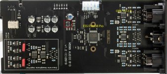

Hi @markw4
Thanks for the response. The DAC pic I shared is available publicly on ESS website. It shows a section of the DAC chip that has ASRC and DPLL in one box. As far as I can tell there are no out of the D/A chip on board chips like Accusilicon oscillators etc on my board to help with jitter. So should I assume that my ESS 9038Pro based DAC has inferior Jitter rejection capabilities and look for maybe external before the DAC reclockers?
I know my DAC is asynchronous in USB mode at least...must be the same for Toslink. Would you also agree that the USB asynchronous mode is also prone to jitter and that lowering the DPLL bandwidth to lowest in sync value will help? Would you recommend a USB purifier or reclocker in this case?
Also, after reading your comments I'm wondering if a Toslink reclocker like the IFI Ipurifier be a good idea to use with say Chromecast Audio optical to the DAC?
Many thanks
I found a pic of your dac board online (attached below). The box outlined in red is the clock, and the components around it look to be its local power supply.
From that we know you dac is asynchronous. TOSLINK and USB are both run through the internal ASRC.
Thanks. That's very helpful. I really appreciate you digging up my DAC board.
That just leaves the matter of whether a DAC in this configuration and with this DAC Chip will benefit from external reclockers...for both USB and Toslink? FWIW, the DAC is giving me an option to select DPLL between a range of 1 to 14 with 7 set as default.
I read on ASR that most DACs, due to their ASRC +DPLL features eliminates jitter to almost nothing and that there is not need for reclockers in modern times and tech. Any thoughts on this is also welcome.
Cheers
I don't see any practical use for a reclocker.
Regarding DPLL, try setting it as low as you can before the dac playback becomes unstable (depends on incoming jitter level). You may be able to set it lower with USB than with TOSLINK. People tend to report that lowering the DPLL setting improves sound quality quite a bit. You can try it and see what you think.
