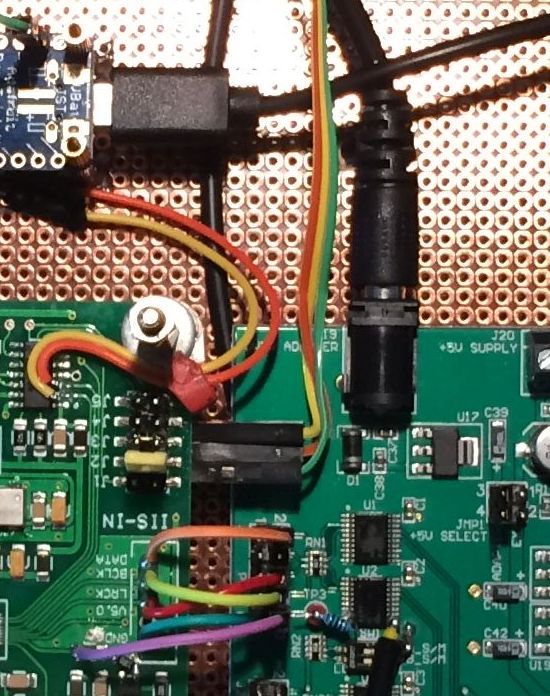

Of course, everybody may have their own way of doing it. Since I am starting with a Chinese DAC and trying to interface with an SRC4392 it results in its own set of issues. Also, since I can't or am not trying to sync a USB-to-I2S converter clock with the DAC clock maybe that would give a different result as well. WIP photo below.

That AK4137 SRC board looks interesting. Might be a slightly better than the TI part, at least in some ways. Would have to study the datasheet and sketch out a schematic of a physical board to be sure one way or the other.
It might also be workable with 'master mode I2S' but not sure about that with this SRC or the TI part. If one were to look at that last picture I recently posted it showed some modification of the Chinese DAC board to get access to a DAC signal which required temporarily disabling the DAC board SPDIF input. Could have been the TOSLINK input instead but I decided probably easier to do with the SPDIF input. There is probably a separate pin on the PRO DAC chips for that, but not for mobile. I have mostly scoped out how that would work with SRC4392. Would take some time to consider the same or similar for the AK4137.
