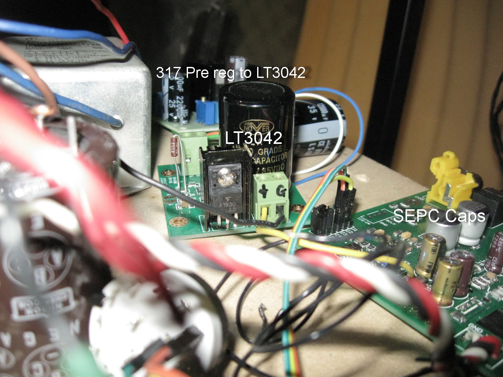

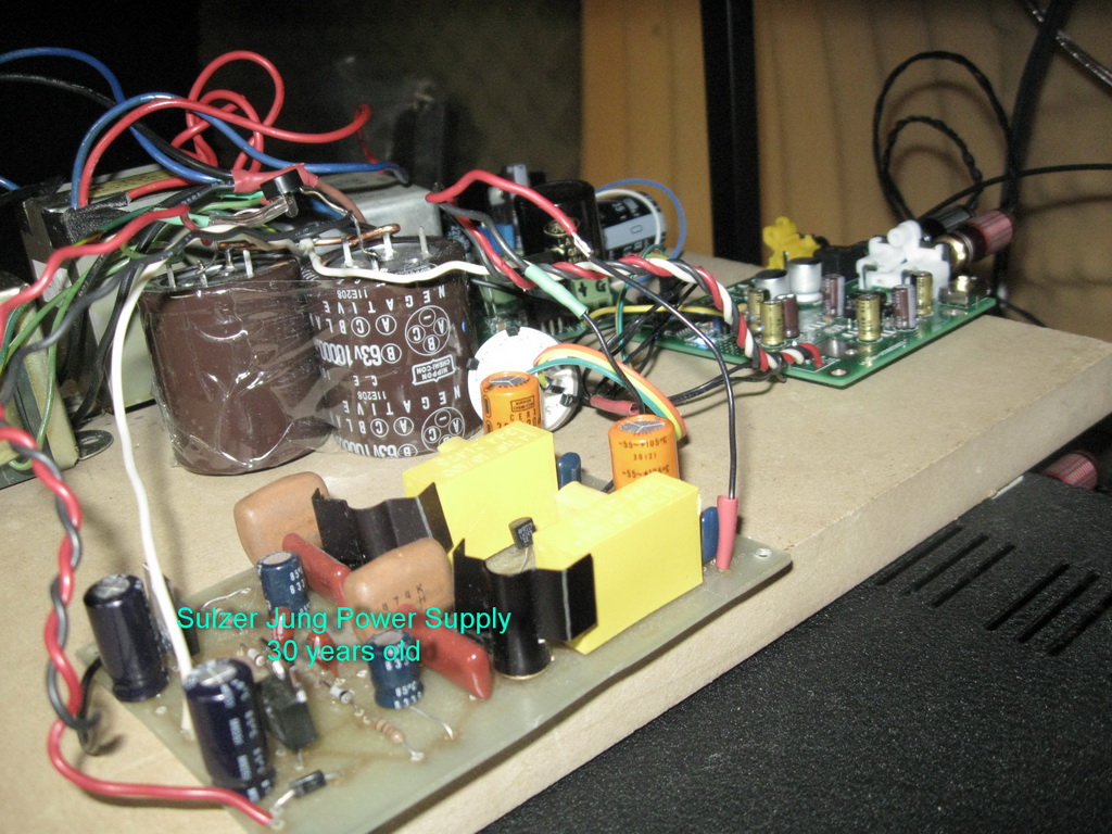

Having recognized that. Here is my progress on my 9038q2m. For some reason my system and the only thing that has been changing is this DAC project changed for the better the past week and a half or so. Could this be due to burn in? I don't know but it changed for the better. Psychological no. The slight hardness was convincing me to quickly put together the ESS recommended IV section as well as the AVCC circuit.
Then the OSCON Sepc caps I had ordered arrived. So this saturday morning. I removed the stock caps as well as the 330uF Panasonic HFQs I had added and put in 470uF SEPC
OS-CON™, SEPC Series - Panasonic Electronic Components - Radial Leaded, Can | Online Catalog | DigiKey Electronics
for the AVCC line. This is powered by the LT3042 3.3V reg which replaced the AMS117.
Then I listened and this was the result. Bottom octaves were better defined. More surprisingly was that it cleaned up a lot of the hardness I was hearing. The music was much more agile. Then I listened some more and the cymbals and brushwork was noticeably improved..a lot of the splashiness was gone and it was more defined. Vocals were now spot on. Individual singers could now be easily discerned when in groups.
What I then put on was a 317 preregulator to feed the LT3042 and the sound benefited as the smaller details were a little more obvious but nothing large a small difference but for the small cost of a 317 board from Ebay Less than $4, it will stay.
The project is still far from finished as this will possibly delay my IV section and what will be interesting is what will be the result of adding that OP amp AVCC section as opposed to feeding from the LT3042.
The oscillator is still stock and no ASRC board has been added as yet.
By far the most improvement to the sound had emanated from upgrading the AVCC supply on this board. The OP amp choice is relatively small in comparison at this point.
I will let the new caps burn in a few days and see what happens.

Hi Mikett,
Could you please post some pictures of your board?
I'm curious about the 317 preregulator and the 470uF SEPC.
I already add LT3042 and I will change the oscillator on my board soon, so I think I can add your mods too.

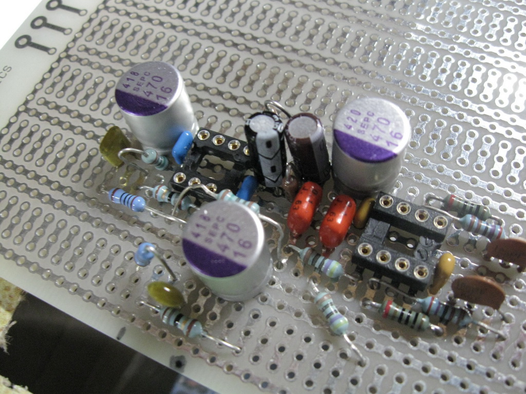

OK so I started laying out the textbook circuit by ESS and I discovered I read the wrong number and did not realize I did not have the 100pfs.
But so far this is what is happening.
The AVCC conditioning and IV circuit will be done on two dual op amps per channel. I thought about using a 5534 and then possibly a 797 for AVCC and I was afraid of stability and compensation. So I opted to use something more stable or the likelihood of stability is greater.
I am planning on trying to use the SEPC as the input filter for the conditioning circuit. This will cause a slow ramp up of the AVCC output and I am not sure if that is good but since AVCC has a range of voltage I suppose that is OK. The picture is one channel. So there will be four additional op amps. A second Sulzer board will be added for dual mono for each AVCC and IV output.
The perfboard is larger than need be. Where markw4 goes below. I plan on putting my external board so it is a bridge sitting above the 9038q2m board. That way the leads are minimized in the final layout.
What I have not figured out as yet is that my offset divider is on the external board. Do I need to bring that back to the 3038q2m board?
I will probably hack away at the 9038q2m next weekend. So I will bring the DAC outputs to the external board, take some 3.3v from the LT3042, feed AVCC back to the DAC and output sound entirely from my external contraption. At least hoping to.
Markw4, those oscillations are the very reason why when my parts bin is done I am done. There is now some guy like me with no instrumentation can put something decent without a guess. So it must come down to kits which are proven and even then a scope at least is required and a decent scope these days.
Thank you for the pictures Mikett
