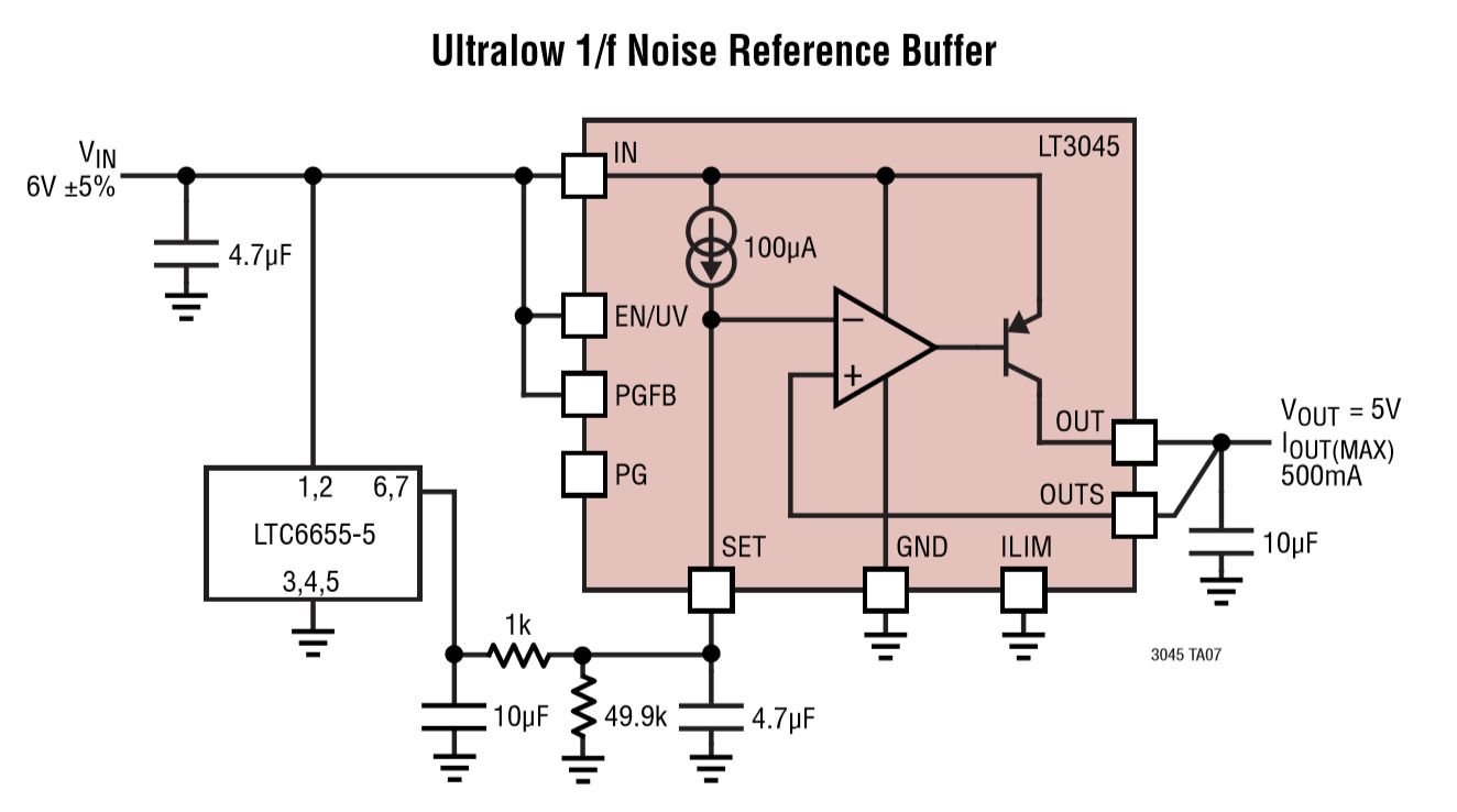

Hello Serge
regarding the capacitors on the Avcc regulators, you are using 100uf, is there a reason to use this particular value or any value can be used , or maybe bigger is better?
If using LT304x type regulators for AVCC, bigger output capacitors than recommended in the data sheet can worsen transient response. The problems with LT304x regulators for AVCC include issues as described in this post: https://www.diyaudio.com/forums/power-supplies/311453-tried-chinese-lt3042-board-4.html#post5561404
With careful load layout and design, transient response should be able to be quite good. And LF noise can be improved a lot using a suggested application circuit from one of the LT304x data sheets that shows an LTC6655 used to provide the reference voltage. (See diagram below.) This might actually make for an excellent AVCC supply for ES9038PRO.
Otherwise, if not using LTC665, then LT304x Cset capacitor should be increased to 22uf as described in the data sheet. If that makes start up time too slow, then the fast start up option circuit can be implemented, also as described in the data sheet. Pictures of one being modified for that can be seen here: http://www.diyaudio.com/forums/digital-line-level/314935-es9038q2m-board-154.html#post5468329

HI Mark thanks for your reply.
i have seen the link with the problems with the LT3042 regulators, and i tried building the avcc supply with the transistor you sugested 2 times , but for some reason i did not get 3.3V at the output, so decided to use the lt3042 regulators in the end, as i want to move on with another project. myabe i will return to this dac after i finish an amp i want to start building now, and make the correct the avcc supply then along with the output stage.
but still even when using the lt3042 regulators the results are very audible for the better.
