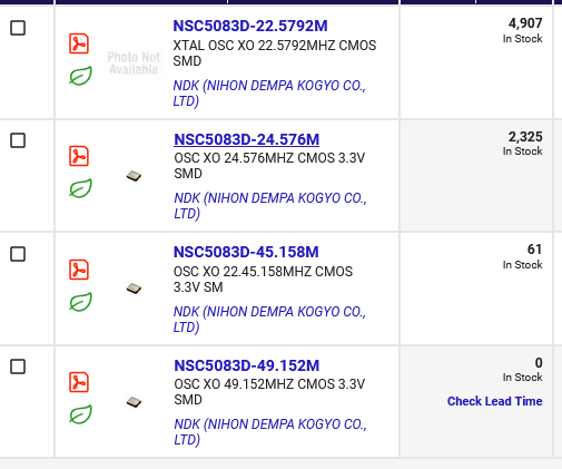

For the Crystek CE3391 I see 700 in stock at mouser (for the 49.152 MHz version). The sometimes recommended types from NDK are end of life, what would your recommendation be?

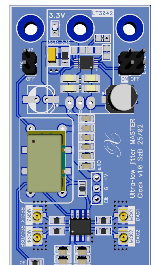

Crystek CD3391 is a "standard" oscillator, not a low-jitter one for higher quality audio. Also, I don't use ferrites in the power to my clocks. I find ferrites can be designed around and when they are used I don't like what they do to the sound. There is some more info on ferrites in my Clock Board thread. Also, clocks are just as important as low noise AVCC voltage regulators. All dacs need a good analog time reference and a good of analog voltage reference (likely a pair, for best stereo). The clock or clocks should have very clean, low noise regulated power for best results.

Unfortunately:
🙁 But even if it would be available I would like to avoid components which are too special, at the moment only a 24V DC source is planned to be connected to the enclosure (a class a headphone amp will also be in there).
NZ2520SDA is not end of life and is available at Digikey.
You are right, unfortunatley only lower frequency versions:
Would that be the recommendation?

Hi! I am actually designing this DAC, could be intresting for you….
Hi, definitely! Haven't seen this thread before.

Before looking at details, I might just mention that some people here in the forum feel that CCHD-957 (for whatever reason) tends to sound subjectively better with a particular bypass cap, which needs pads a little bigger than the standard 805 smd size. The bypass cap is a 0.22uf Rubycon MU, part# 16MU224MZ22012 Not cheap, but IME definitely worth trying.
Also, the CCHD-957 should be left running at all times for lowest phase noise. It may take a few days of running to settle into its most stable operation.
Besides bypass caps, the clocks should probably also have series damping/termination resistors. May not be needed if they are close enough to the dac load, but sometimes it helps to layout the clocks in a strategic location where ground plane currents flowing under them are minimal.
