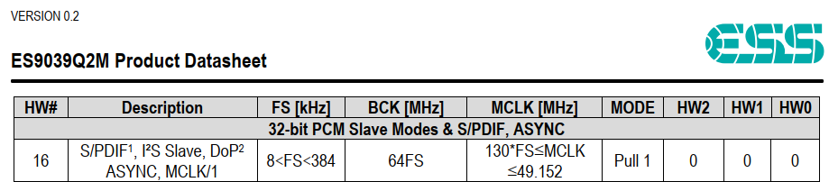

In practice the first thing to do is to read the datasheet. Now what might be the minimum MCK frequency in ASYNC mode?In theory, phase noise increases by 6dB with each doubling of clock frequency.
^That's exactly right, for the dac chip datasheet that is.

Unfortunately, ESS dacs run async mode require a minimum clock frequency in order to play back certain sample rate content. Maybe good use the lowest clock frequency that meets the user's needs.
For HW# 16 it says 130*FS ≤ MCLK ≤ 49.152MHz. So minimum MCLK for 192kHz (max samplerate for me) should be 24.96MHz. Does this also mean a 50MHz clock would not work?
