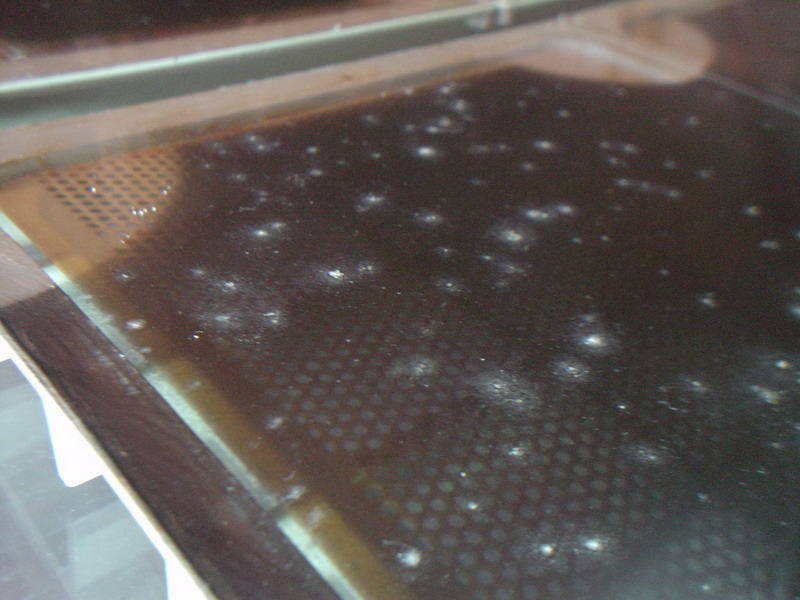

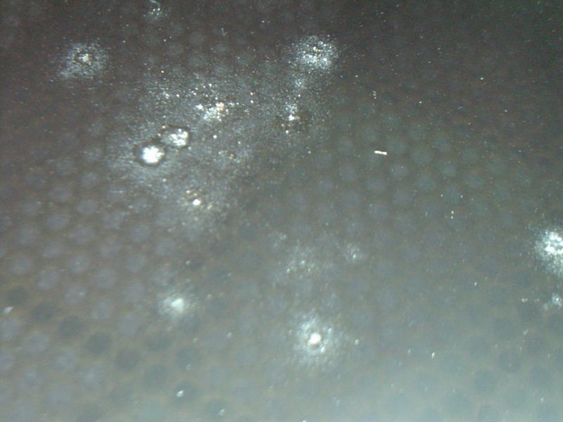

Is the coating of the Esl-63 also carbon black?
I have attached two pictures. You see the coating of a nearly 20 year old Quad Esl-63 panel. These white points on the coating look like white ash. The foil is not damaged there. Before the rebuild you could hear sometimes a ticking sound. For sure a perfect leakage path at these points.
Harry
