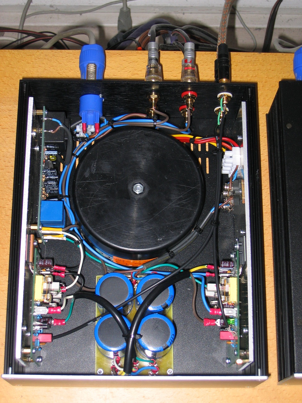

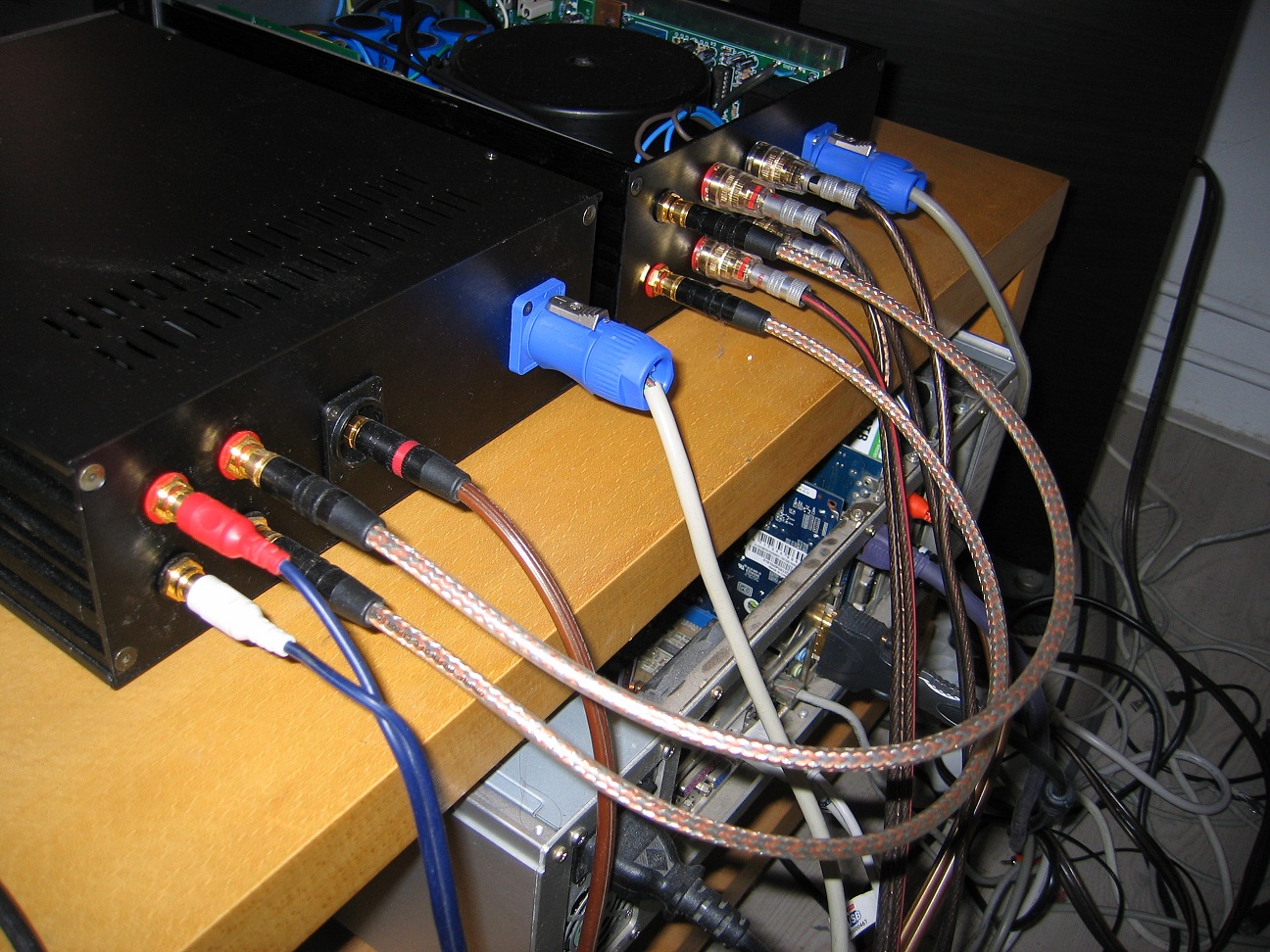

Afters months of PCB-layouting, prototyping, ordering parts and some metalwork, I am proudly presenting the result of this project!
The only thing it still needs is a proper testrun and a mains-fuse. (My electronics store is not opened today)
What is on the pictures?
2 enclosures. One for the Minidsp and one for the amplifier
Minidsp is used for the sub-sat filter
The amplifier is a very compact device at which I am proud since there is quite a lot of electronics in it. (230mm wide, 280 mm deep, 80mm high)
350VA 2*25VAC torroid
Rectifier on side panel
Elco-bank of 4 pieces 10.000uF 63Vdc
Two mono PCB's
A loudspreaker protection kit
Neutrik RCA entrance and mains inlet
Ebay terminals

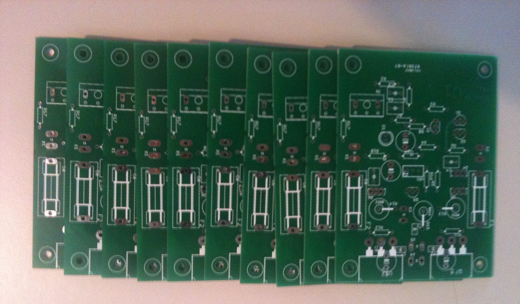

Thank you very much. I really like the "end" result too. The enclosure is from Italy, ordered in The Netherlands. modushop.biz
The amp is a 90% copy of Elliots P3A and the pcb layout and schematic adjustments have been made by me in order to make the pcb fit vertically in the 80mm high enclosure.
