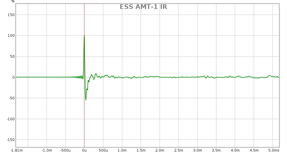

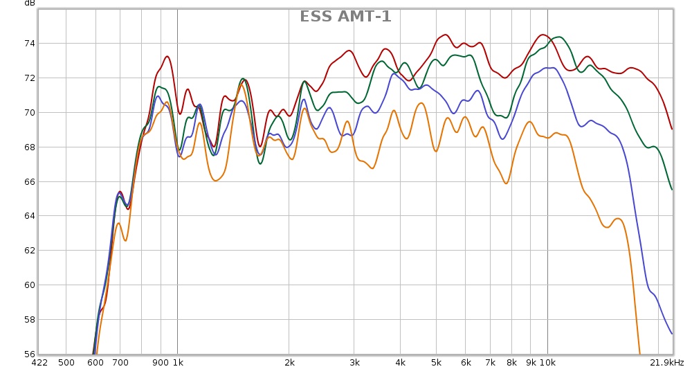

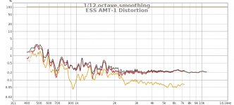

My pair of the large ESS AMT-1s arrived and I am seriously impressed by them! I did only some quick and dirty measurements and they are flat and very low distortion, I guess they will sound great.
I will report my progress in this thread - trying out different combinations with direct radiators, paraflex and horns and ultimately a synergy horn with them.
The distortion is measured at 90 dB and one meter. The FR plots are 20 dB less. I had to take them at low level, these are just quick and dirty measurements after unpacking. For proper tests and listening, I need to buy some protection caps first. I am impressed by the impulse response, best I ever measured.
