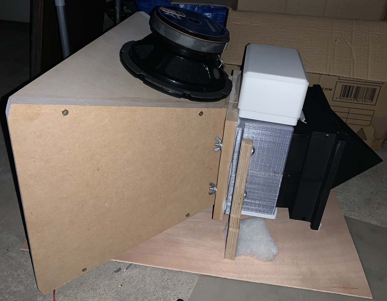

@drumdoctor The current (inner) dimensions of the horn including the printed part down to the AMT membrane are: 530 mm width, 290 mm height, 320 mm depth. The -3 dB point is around 300 Hz with open backs, I thing I should get a lower response when I put the back covers on the mids. I estimate somewhere around 200 Hz crossover point should be possible. 300 Hz is actually good enough for my purpose (with a separate midbass unit below it).
@magic44ken I have only one unit built at the moment. The dispersion in the HF should be 30 degrees, which gives theoretically roughly 175 - 205 cm high window at the distances you specify. I would say that most of the perceived changes in sound would be from the reflections, not from direct sound. But I may be wrong.
Reactions: drumdoctor

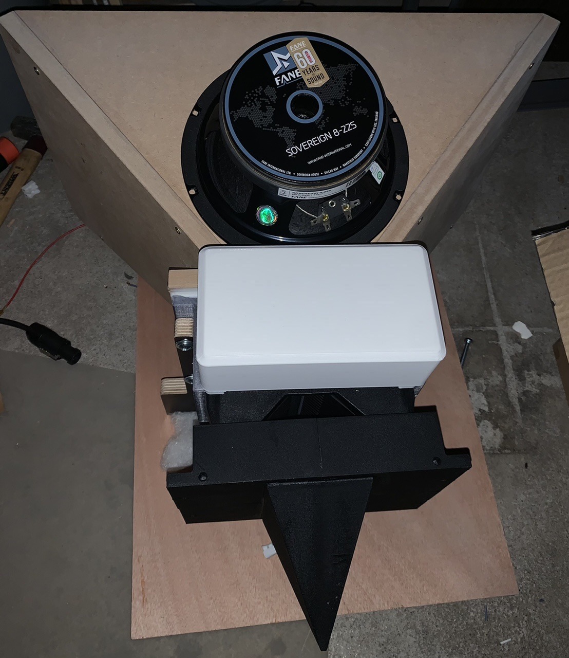

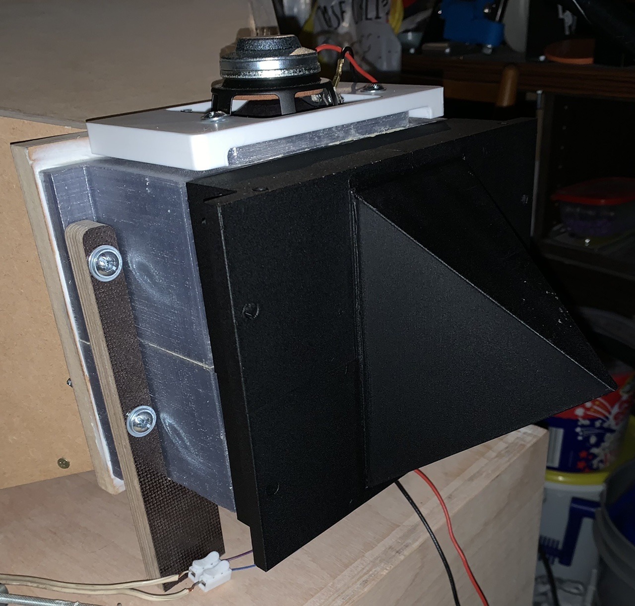

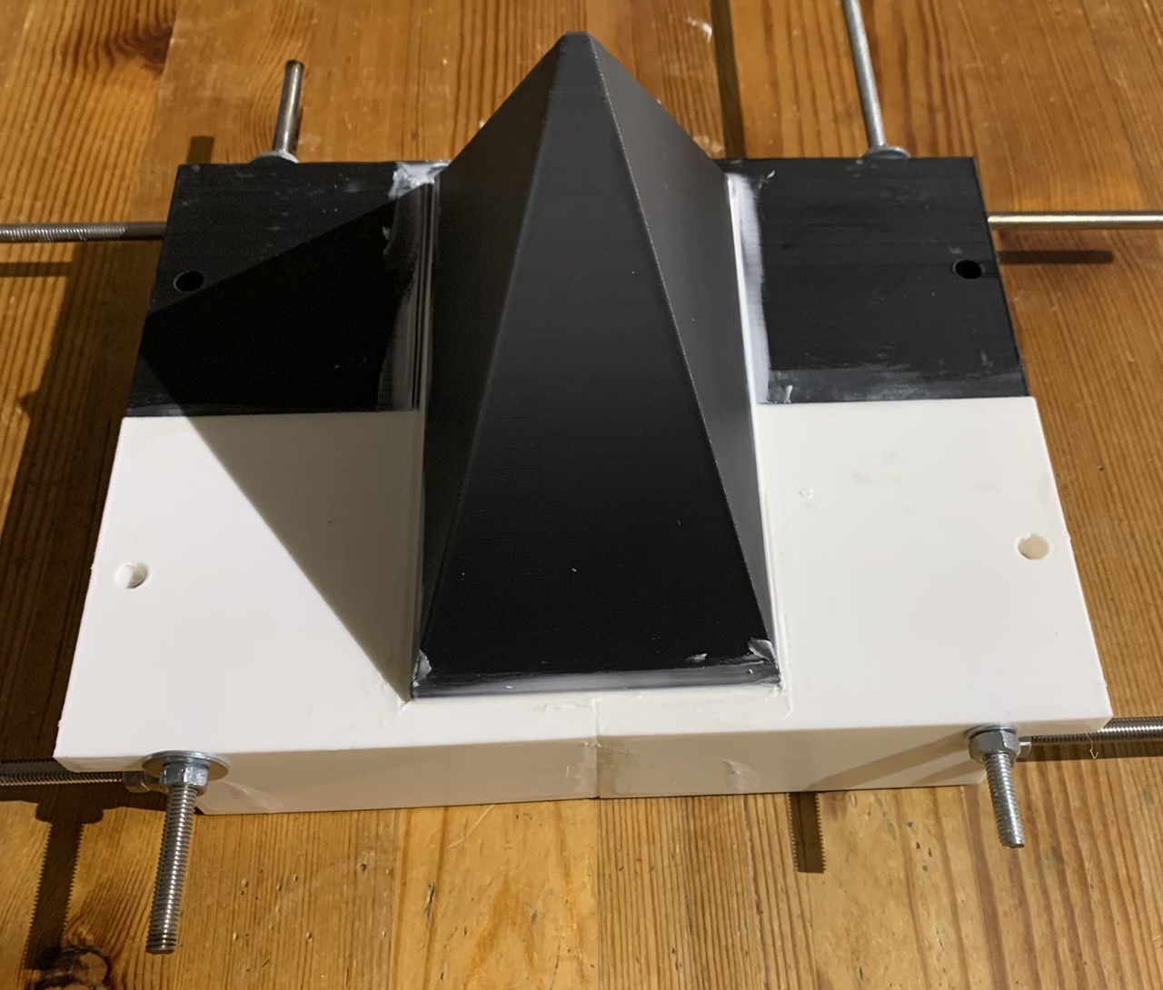

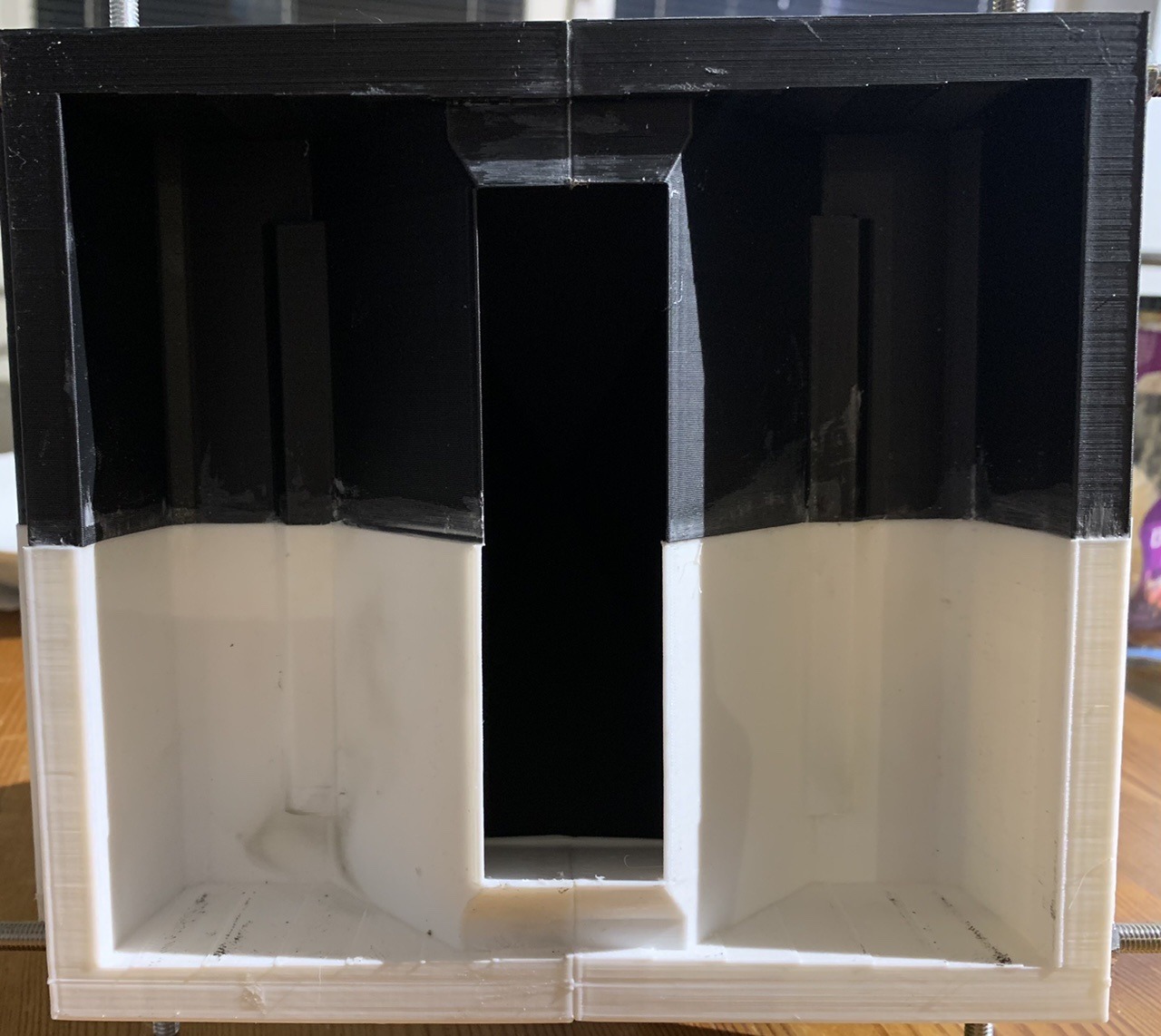

A little progress. The AMT back cover is finished, the glue needs to dry, damping material will be installed and foam tape for sealing it. The parts are printed on different printers from different materials, that is why they do not align perfectly, one of the printers is not really calibrated for dimensions and prints slightly smaller things.

I have mixed feelings about the results. The sound is really great, no doubt about that, but it feels all quite impractical and I am not sure if I mind the narow vertical or not. Now I plan to built a large 3way Synergy with a traditional compression driver. And maybe then again one with an AMT - the arrangement around the throat must be done in a better way. Since I always wanted to try a proper open baffle speaker, the AMT will be used with a Deltalite II 15" in a minimal baffle test arrangement.
An AMT synergy is really something special, but I think I need to gather more practical experience to do it correctly next time. I still have an idea or two and I plan to use the GRS planars as test units, since they are easier to mount. Still, I consider the Heil AMT the best sounding HF unit for my ears...So good that I will most probably build a second quick and dirty impractical unit for listening before the large synergy is built.

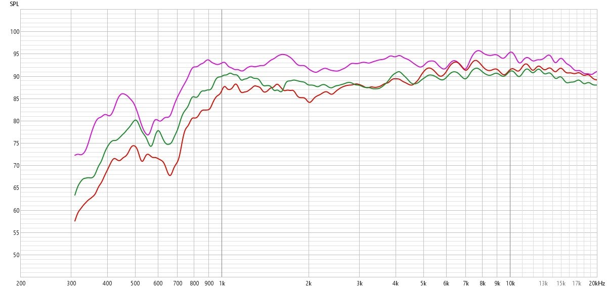

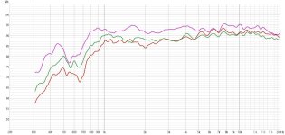

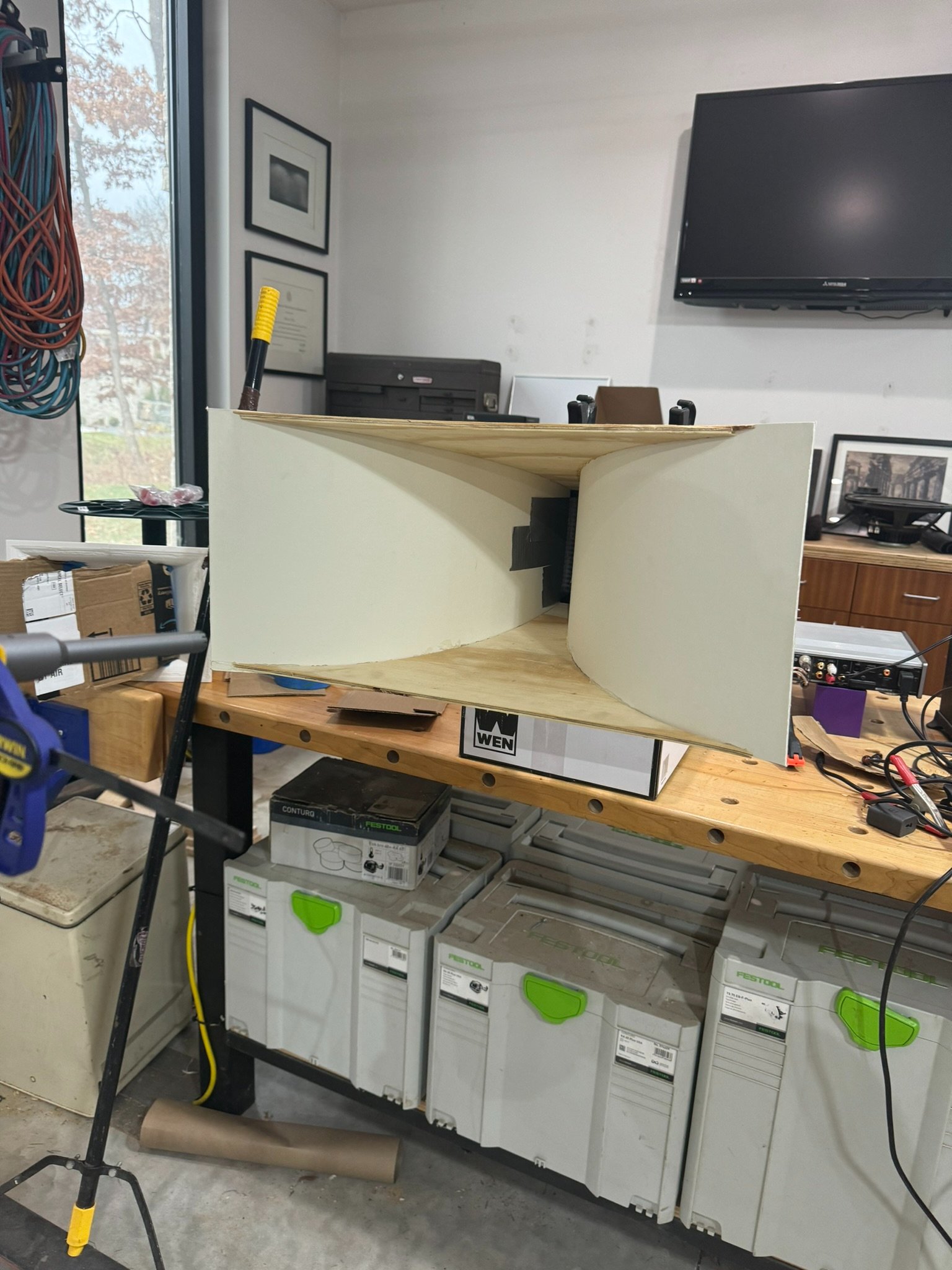

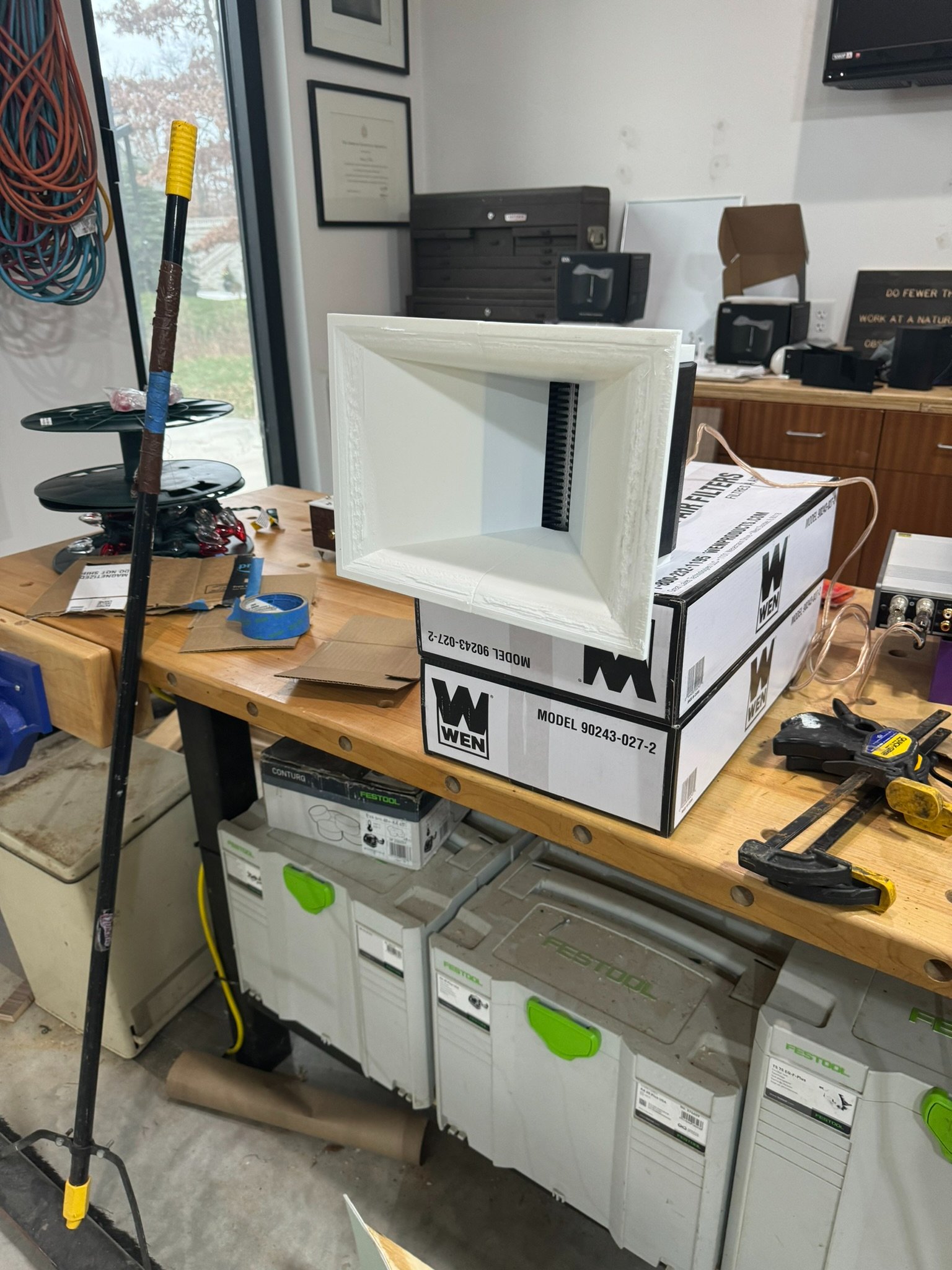

@pelanj I don't know if you're still active in this project, but I've been following along with some of your experiments and have done a few of my own. I recently mocked up a tractrix horn with the Heil AMT and a 3d printed adapter somewhat similar to yours, and I got some pretty interesting results. Here are a few photos of the horns I've been testing as well as the frequency response changes.

That looks pretty nice! My most recent experiment with the AMT is here https://www.diyaudio.com/community/...eter-faitalpro-3fe22-mids.400527/post-7844045 - slightly larger horn and a larger midbass driver - I had mixed feelings about that one - the midbass is too far away from the throat in this arrangement, so I cannot really make a nice crossover for it. I also do not really like the narrow vertical pattern - the cinema speaker next to it is 90 x 90 CD horn and it covers the room much better - especially sitting vs. standing (as expected). The midbass issue could be relatively easily solved with using a smaller driver closer to the throat. I do not think I can solve the narrow vertical pattern - only learn to live with it and listen seated only.
@xrk971 Top pink curve is the large tractrix, the green is the smaller white 3d printed waveguide, and the bottom is the bare heil.

The tractrix provided substantial gain and bass extension. This should reduce distortion by allowing you to play with less diaphragm movement. Whatever you did as the transition from Heil to the tractrix worked. I don’t see any notches. Can you share more images of that transition adapter? Or is it just tape?

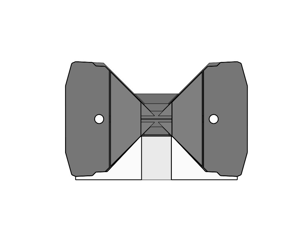

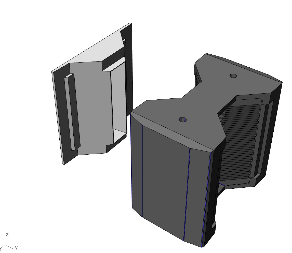

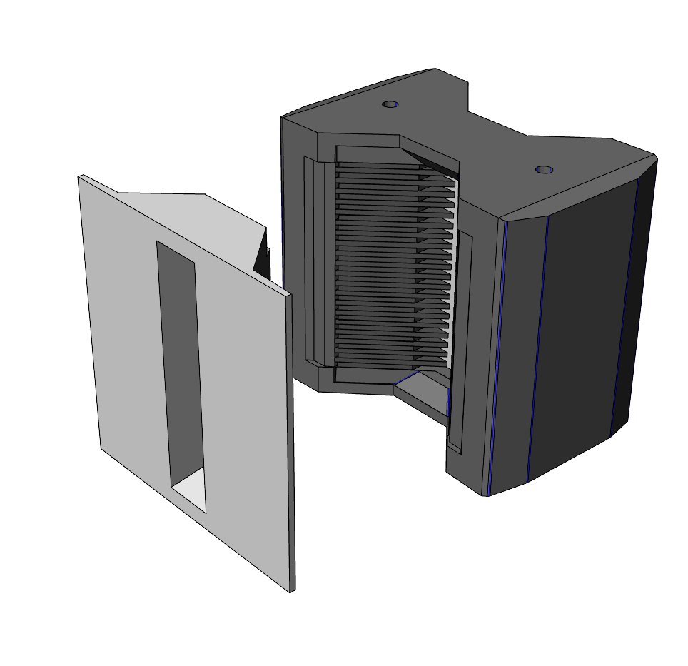

I have a couple of screen grabs of the 3d model and a section from above to show more or less what it is doing. I didn't get fancy with the throat adapter - it has square walls on the side with an top and bottom to match the heil vertical angles. I just taped the adapter to the tractrix horn with some duct tape and it was honestly pretty poorly crafted - I hot glued it together 20 minutes. If I ever decide to build a permanent pair of speakers I'd likely mill it out of a solid piece of wood. I'm trying to decide where to go with this - I have a 2A3 tube amp collecting dust that I'd love to hook up to it but I don't think I have the chops to design a passive crossover; I always use DSP.

I always try to answer posts with a question directed to me, but I would comment on yours nonetheless for the excellent work you show and nice smooth response. If you want, posting an STL file (or other stanrdard CAD format) of that ESS AMT-1 throat adapter would be very useful for folks.
