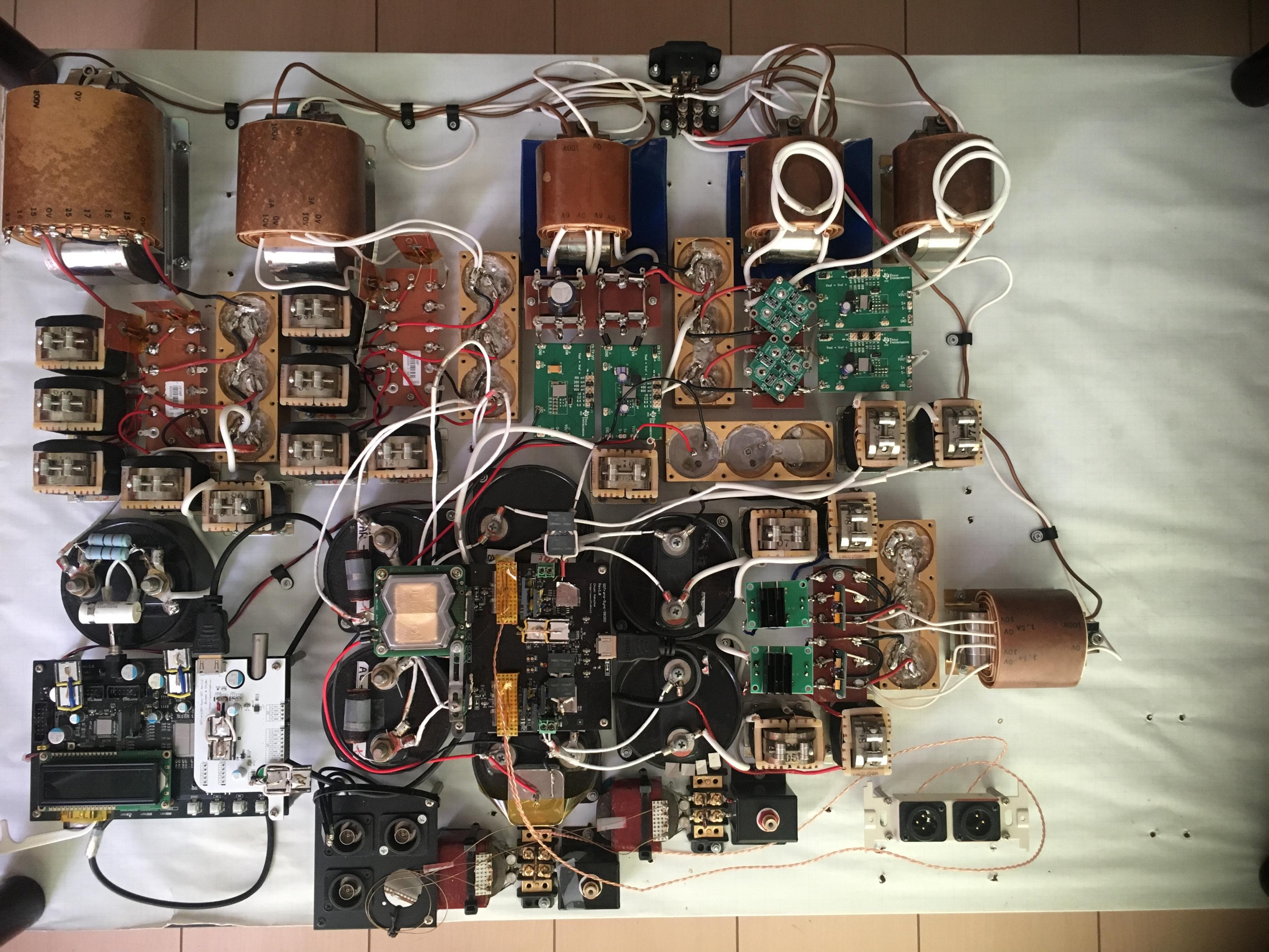

I am a self-certified “fanboy” of ES9038PRO DAC chip.
For two and a half year, my friend Tetu and I always making their efforts in improving their own DIY ES9038PRO DACs respectively by exchanging information frequently. Our common opinion is “ES9038PRO is the best commercial DAC chip currently available. However, not so much DAC devices that have fully exploited the potential supreme sound quality built in the chip are in the market. Fortunately, both of us can recognize the excellence by improving continuously power supplies, master clocks, I/V stages and so on. Whenever we listen to music played by their DAC and perceive amazing information retrieved from 44.1kHz/16bit sources, we spontaneously feel our sincere gratitude to designers and manufacturers of the DAC chip.
Attached is the photo of my current system.
On a two storied wood board, SD memory card player, SDTrans384 and Chiaki’s ES9038PRO Dual Mono DAC are assembled without any IV stage. Most of the weight of the system is from power supply units. As a master clock source, NDK OCXO DuCULoN is adopted. Most of the rectifiers are GaN E-mode HEMTs.

Can't even imagine the cost of this whole system!
The small boxes are line transformers?
In my system shown above, a master clock on the transport side is synchronous to a master in a DAC side. Therefore, the master clock in the DAC side and the incomming I2S/DSD-raw signals are synchronous. I set the DPLL bandwidth, “OFF”. I think it is equivalent to “No Bandwidth” in “ES9018S”.
I have not recorded costs for the system. I guess the total cost is more than 5,000 USD and less than 10,000 USD.
Some square boxes are choke coils and line transformers. However,so far, the line transformers are not used. The eight channel output signals in one DAC chip are tied together for both + and - respectively and the summed + and - are connected to Hot and Cold of XLR input of ADAM A7X active studio monitor speaker. No GND is interconnected.

What clock frequencies are you using on your DAC shown in the photographs.
45.1584 MHz and 49.152 MHz. (Just one of them is in the photograph)
I have also tested 90.3168 MHz and 98.304 MHz before. I think "45.1584 MHz and 49.152 MHz" is a sweet spot within my limited actual experiences.

My policy excludes any USB involvements. Only AES67 is acceptable for me.
ARM chip connected to es9018s DAC, fully sync connect.
ES9018S can't realize "No Bandwidth" for DPLL setting. DPLL "OFF" on ES9038PRO is far better.
I do not believe es9038s improve the sound in my system.
I agree with you as long as your "es9038s" is not typo. The product type "es9038s" you indicated is never likely to emerge in our market.
If your "es9038s" is a typo of "ES9038PRO", I strongly recommend you try it.
However, everybody has his/her own idea, policy, value and budget. I respect your own approach as far as you are satisfied with yours.

No. I am not high-end orienting. But, I have ever listened dCS Vivaldi before and was deeply impressed. The impression of Vivaldi then was very superior.
With the DPLL switched off is this synchronous mode connection where is the clock refernce derived from for the Audio. (sorry for stupid quetion).
A master clock of NDK DuCULoN OCXO is input to DAC board at first and the DAC board forward the clock to SD memory card transport. The transport sends I2S/DSD-raw signals that are synchronous to the master clock back to the DAC.
What are the speakers you use for listening tests.
ADAM A7X Active Studio Monitor Speaker with an XLR input.
how you connect your dac with PC?
I never connect my DAC to a PC/Mac/RaspberryPi online according to my policy. My transport is a tiny SD memory card player, SDTrans384 by Chiaki.
I copy audio sources from my PC to a SD memory card and the card is transferred to the player off-line.
I don't want to connect any PC/Mac/RaspberryPi which are an enormous source of digital noises ranging from 1 Hz to several GHz to my DAC.
