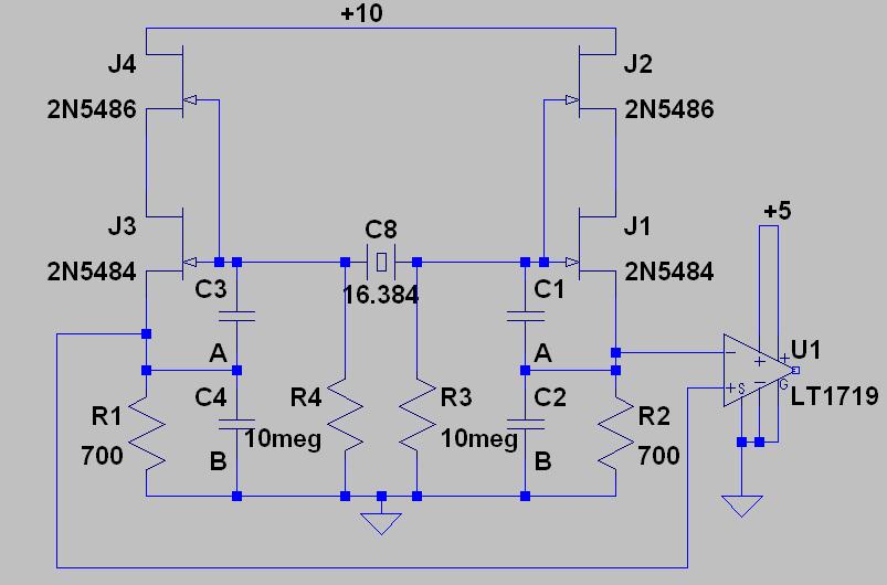

Clocks:
Don't have specific experience with Tent, am happy with my own, which is a differential fet (sometimes cascoded) colpitts with clean power/ground/layout, padded with sorbothane. I plan of trying the Crystek modules for 40 MHz, and if they work as good or better, then why not?
Tent is not my only and last option: I'm also waiting to receive 80 MHz VCXO low noise by Crystek
Http://www.crystekcrystals.com/crystal/spec-sheets/clock/CCHD-950.pdf
I'm very interested to better know the clock that you are using:
(differential fet) could you post schematics and tecnical info?.

Continuing, clock sch and iron i/v
Hires: Was concurrent with K&K about the LL1674 for i/v a few years back...I disagree with them loading the output side, sounds constricted to me. I prefer setting the load at the primary, and letting the secondary "rip" into as high an impedance as possible, like 100k and up. It remains to be seen if the Sabre has sufficiently low residual offset for this, if so I will try a differential i/v primary "load" from 50 ohms up to wherever , depending on the sonics.
Rossl: hmmm, not sure a kilobuck to hear if the mil spec oscs are better is exactly, er, cost effective DIY...
Back to affordable for the masses, the Crystek modules may make discrete oscs non-relevant, particularly above 20 MHz or so. There is that fine line between lazy and efficient. If somebody else has done the work sufficiently, why try to re-invent the wheel, unless it's fun.
Major discussion of a discrete osc probably could be moved to a new thread about "yet another clock", or something like that, but here is cliff notes:
Key point is not so what, but how.
Layout keeping wires, traces, loops small. Try a copper foil groundplane. Dedicated power supply, separate power transformer, rect, pre-reg not shown in the sch to keep grounds cleaner. Fine tuning the caps A and B to match the particular strays in the devices and layout. Typ 47 to 100 picofarads. Use vrefs as the reg for the fets, such as ref01, lt1021, lt1027. Depending on the comparitor used, maybe a power reg for the comp. Not shown in sch, bypass refs/regs with low esr, small caps, up to 30uF or so. An lt 1394 can give 5v differential clock out. The lt 1719 can be 3.3v single out. An lt1116 fed 7v can give 5v diff out, but takes more supply current. High Q, low esr fundamental xtal. Ground the case of the xtal. Try powering the input stage of the comparitor off the fet power/ground rather than the comp power/ground. They might sound different, one might sound better in a paticular implementation. Match Idss of the "bottom" fets, to keep the source offsets in circuit under a few millivolts of so at operating temp. Yes, it can be done. The cascode top fets are higher Idss to function as cascodes and are optional. The fets can be low noise, high gain such as J309, but decent results can be had with garden variety fets, the 5484/5486 were for sims of the cascode, and do not represent the views of the network or it's sponsors. Metal film 10 meg gate resistors. Optionally try wirewound source resistors, using the inductance as part of the tank circuit, tuned with caps A and B. Mount the xtal on sorbothane. Probably something else I will remember after posting...
