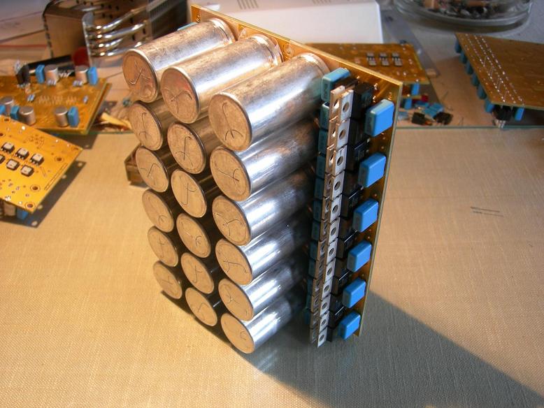

Hi Dustin
Is it possible to get the PWM or DSD coded signals out of the chip?
By doing that you/we can get an power amplifier output with 4 additional transistors.
I have a design using Lovoltech LU1014D JFET's with JFET regulated onboard power. 25 Watt with these JFET's into 8 ohm and 50 Watt into 4 ohm with only 4 JFET's in addition to your chip...
Have been planning to use the Cirrus CS44800 http://www.cirrus.com/en/products/pro/detail/P1070.html
,but if it is possible to get PWM or DSD coded signals out of the ESS Sabre chip
Attached photo of the JFET amplifier:

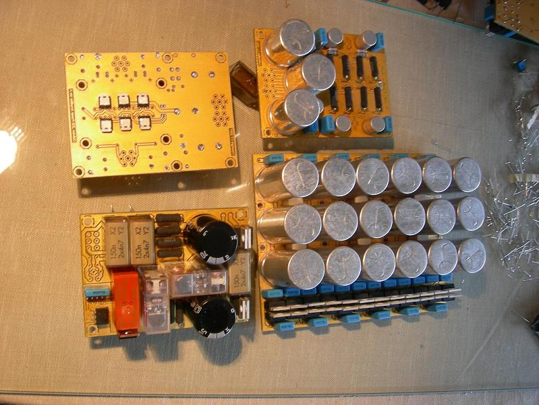

Some more information on the JFET amp.
Both operational as class A and PWM amp.
JFET regulator with virtual capasitor of 20 Farad...
PCU pcb wiyh "Silicium Carbide" rectifiers (6 in parallell),
and 6 secondarys.
AC in pcb with auto 115/230 VAC selection,
slow start, DC trap, filter and optocoupled remote
power on/off, and ready for temperature fuses in the primary.
Raymond
