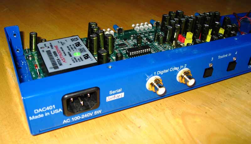

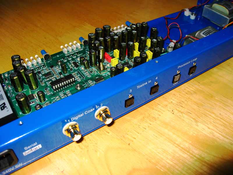

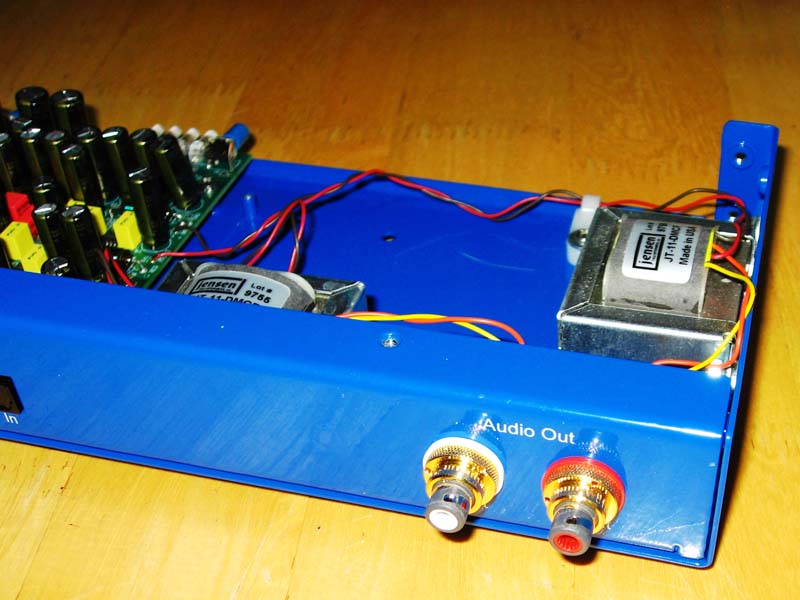

Output is isolated and coupled by Jensen output transformers that are capable of 0.0001% THD.
All inputs and outputs from the box are either optical or isolated by transformers. No DC connections other than the power safety ground. Absolutely no hum.

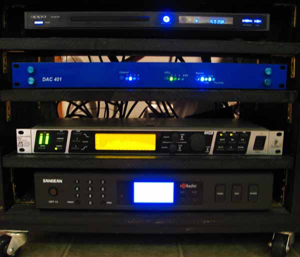

The equipment rack in my basement with Modified Oppo DVD player, DAC, Behringer DEQ2496 DSP equalizer in the processor loop, and a Sangean HD radio at the bottom. Not shown are the Popcorn Hour networked media player and plasma TV that comprise the four SPDIF inputs.
rossl said:Two coax and Two Toslink inputs are good to 192K.
Nice work!
Did you use the Wolfson SPDIF receiver to MUX?
Did you use a 40mhz clock?
Cheers!
Russ

No, I am using CS8416. I didn't use Wolfson because of the 176K problem.
The DAC clock is 80 MHz Crystek. You can't really see it very well in the pics because it is surrounded by tall caps.

I'm using OPA1632D. four of them.
The symmetrical balanced filter stage I ended up with is flat at 10KHz and down to -0.5dB at 20K.
The -3db point is 175KHz.
-27dB at 1.25MHz which is MCLK/64...
Simulated, not measured.
The caps used for the filter are WIMA and they are the orange ones you can see in post 1017
I'm listening to the DAC in six bit mode now. I have burned a PIC to use nine bit mode and I listened to that for a while.
I'm driving the wife crazy because I play the same songs over and over when I do the tweaks and the listening tests...
Of course, I have to play it loud to hear all the dynamic range
Answers to some questions sent by email about the Prototype DAC pictured above.
First question. No, I didn't use J*cko H*mo's SPDIF input circuit for the coax inputs.
I did use the general philosophy that calls for the isolation of the received signal with transformer, then terminate and convert to logic level before coupling to the CS8416 with a cap.
Next question. No, I didn't provide for a DSD input to my DAC. In the setup pictured above, post 1024, the DVD player converts DSD to PCM. Adding a DSD input to the board would require another mux chip in front of the Sabre8. Also, I am not aware of a standard cable and connector for DSD.
Another question. It took me about 10 hours to hand solder the parts to the circuit board... Soldering the TSSOPs and LQFP is difficult and takes a lot of practice. So, it would not be practical to sell a bare board. I am looking into getting a professional assembly contractor to solder up a batch. This will be expensive.

rossl: great build! If you don't mind sharing some pricing details, how much was it to build the rack (metalwork+coating)? How many units (just metalwork) did you do? This is my greatest stumbling block so far - to find someone to outsource metalwork to without parting with my car or living on beans for a year =)

Hi promixe
Get used to eating beans
Well, here is the bad news. I ordered just one chassis unit. It was expensive.
I spent a good amount of time designing it also.
As it was, I paid a lot for just the one chassis and tooling. For the price of just that... I could have gone and bought a decent used DAC.
But then... I already have two decent used DACs in my closet. I need to clean out the closet and sell some stuff. And, I wanted to make MY own DAC.
I didn't want to put in a big order of chassis units because I wanted to make sure everything fit, connectors screw in, and everything looked OK.
As it worked out, everything fit OK but I don't care for the paint color or the silkscreen.
In order to make it cost effective, an order at least 5 or 10 would make the cost of the tooling amortize out and bring down the per-unit price. Even then it will still be way more expensive than cheap china imported junk.
Changing the paint color on a new order costs nothing, but a new silkscreen is another tooling charge.
