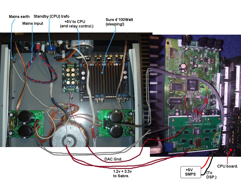

I'm certain the board is working fine and it's very well designed, but my problem is simply down to the way I've wired everything together...
I no longer get the crackling when touching the board etc. since I improved the power supplies and wiring and also fitted a mains filter.
What I have now noticed though is that my grounding point (for the mains filter) is not making proper contact with the whole amp chassis - if I push down on the bottom panel of the case, I hear a pop from the speakers, and the DAC resets itself (probably more like a data glitch, since the reset line now is tied to directly to ground.) So, I'll have to sort this out since I'm sure it's contributing hugely to the issue.
I realize that a lot of the design of the PCB is for remote sensing etc. I have the shield connected to ground at the moment (two points connected).
The 80MHz clock appears to be working great now as the quality is excellent. I'm still getting the strange noise at the start of decoding though, and it would suggest a problem with the DSP, although as I say, the noise I'm getting is the same as I remember getting with the Buffalo (with certain sources). It "sounds" like an async PLL is trying to lock on, but this is just a guess of course.
So, I have to sort out the grounding issue first, and try a ground lift and different wiring topologies for the power supplies.
OK, one big clue is that I'm actually using a +5V SMPS to power the DSP board, so this could cause big problems. The CPU is powered by a small standby transformer, the amp modules are powered by a 300VA Nuvotem, and the DAC board is powered by the TP LCDPS (all 1.2V and all 3.3V lines connected together.)
I need to build a quick +5V PSU for the DAC board and do away with the cheapo SMPS as I'm sure this will improve things a lot.
Another thing which happens is that if I try connecting my Sure 4*100 Watt amp module to the DAC board, it of course sounds very distorted because it needs at least a simple buffer or I/V stage by the sound of it. The thing is, I also get a buzzing sound while the DAC is in mute and this sounds very much like the typical ground loop "noise" you get with SMPS'.
Should I try connecting every power supply minus together, and then try connecting to the mains earth? What would be the recommended method?
btw, I have now changed all the digital inputs to use short lengths of mini-coax. The BCLK and LRCLK connections are each only 3 cm long, and the DATA input connections are only 5 cm long. The shields are currently grounded at the DSP end, and connected to each other at the DAC end....
Should I still ground the coax shields at the DAC end as well? I'm not sure what to do with the resistors in this case?

I'm sure the I2S connection is fine now, but I still get the noise when the source changes track etc. I have to admit, it could possibly be the DSP board after all. I know my setup is a bit of a mismash of parts, so it's probably down to the SMPS on the DSP or something.
I've sorted the eathing problem now and it has good contact through all of the chassis (mostly aluminium I think). I have no intention of leaving the mains earth disconnected obviously.
What I realized yesterday was that the DAC board is actually grounded via the Sympatico modules! This of course goes to the center-tap of the big torroid, and all other grounds are insulated from the case (mains earth) - If I'm not getting any major noise issues now, is there any reason to ground the center tap of the trafo to mains earth, or can it be left floating?
(I should really draw out a rough diagram of the connections today. I might also take a recording of the digital noise I'm getting.)

Hello,
Yes - you should make a clear drawing of your wiring!
I don't fully understand it just with words...
Regarding the CT/Mains earth, common practice is:
CT directly to the midpoint between the two filter capacitors (shortest possible).
Then a wire from CT to chassis.
Then a wire from Mains Earth to your CT/Chassis connection, at the chassis bolt.
Ground every "signal ground" at the CT point where it connects to capacitors.
If you have many connection, make a bus bar or star ground with anything thick and highly conductive (ie copper bar).
If you want to, ground "shields" to chassis locally, do NOT travel the unit to join the earth bolt. Other solution is: ground "shields" to the "signal groundplane" locally (that's why I provided this connection option on board).
If you want to go further, you can consider filtering between these shield connections and the chassis or ground, but I leave it to you.
You may use "ground breakers" etc... But first make sure you can safely power your equipment.
It seems you have some ground loops problems anyway. Show me a drawing.
Regarding the "star grounding doesn't work for digital"... yes and no: better a star ground than a bad "short loop".

Your DSP board has a connection to ground.
Your DAC board has a connection to ground.
But how well are these grounds connected?
It seems they don't even use the same supply, one is SMPS the other one linear... You have to directly connect the SMPS ground to the center tap of the linear one. And you know you are injecting some serious spurious currents here! That's why you need a short solid connection, otherwise it will develop as noise voltage.
If you rely on chassis, or worst, on your i2s "return current" lines to handle these spurious currents, it is normal the system has some serious problems!
If you imagine a virtual groundplane, you'd like to connect the i2s line AND ground lines directly between the boards. In fact, you wouldn't even need a seperate ground connection for the DAC board or the DSP board.
If you imagine a star ground, you don't want this i2s return currents connection as it makes an extra loop.
The faster the signals, the closer to the signal trace flow the return currents on the ground plane.
So yes, you would like to connect the grounds between the two boards with the i2s connection, so these noise currents wouldn't radiate.
This loop has it pros and cons: it provides a short return parth for i2s line currents. This is good. But if the main ground connection to ground of each board doesn't results in a low Z between the ground found on each boards, you are injecting ground currents right at the input connector, and allowing them to develop voltage on this connector (these are holes, and wires, so L and Z!).
So, connect or not connect? Take it with a big grain of salt: CMOS inputs are not that sensitive, and i2s lines do not generate really big currents.
The ground connection of the whole board is very close to this input connector, this is not just pure luck, you can have some serious low Z connection here. Now, you might as well not have this loop, use a star ground. It will probably work as well.
All that to demonstrate what? That the problem in your system is probably not here xD but more on this interconnection between the several grounds of your boards (the SMPS ground to CT stuff etc).

What is WAY MORE of a problem is that you connected these "ground sense" lines together on the power connector, as far as I understand?
This is NOT what you should do! There is a ground plane to do it! Doubling it makes for big loops through the dedicated traces!
You connected them to the regulators (LCDPS), and these are themselves grounded through a dedicated wire?
NO: you have to choose, or you locally ground them, or you ground them to the star point, not both. And as you don't have 7 independant regulators, local grounding makes no sense, you're making big loops.
Cut that ground connection between regulators and the board: it is already done via the star point.
Once THAT solved, and the SMPS ground to center tap ground problem solved, you shouldn't have this problem anymore.

Hi, guys,
Wow, amazing how fast these discussions can change! I have quite a lot of catching up to do.
Maybe I should have explained from the start that Nicolas' board was designed to be connected in a specific way, but I didn't / don't have full understanding of the techniques involved. I also should have remembered that it was designed to be connected directly to the source via fairly short wires etc.
I didn't intend to start any heated discussions with my questions, but hopefully we all understand that different design methodologies are employed here. As long as we're all learning things, then it's all good I suppose (hell, this is what the forum is for isn't it?)
Anywho, I've drawn up a quick diagram of my current test setup. Again, it's not pretty and I'm sure my earthing point could be a lot better. I also need to earth every panel of the chassis more securely.
The CPU ground is of course connected to the DSP board ground at the DSP board itself, the LCDPS ground are connected together at the LCDPS itself. The DAC board's central ground is connected to the LCDPS, but also via the Sympatico module input grounds, and then through the big trafo CT to mains earth.
Then there is the SMPS for the DSP which I still need to get rid of as I'm sure there are some unwanted current peaks and noise looping around here.
The I2S coax is ground at the DSP end, and also at the DAC end (although it is connected to the "other" ground point atm, not to the one directly next to the ESS chip).
It's still working fine apart from the noise at the start of decoding. I will sort this out once I get my o'scope back and when my buspirate arrives (to analyse the original mute logic timing and to control the DSP directly etc.)
I think it's best for me to leave this subject for a while after this, as everyone's been so helpful already and I've taken up a lot of time in this thread. I will post more updates when I get some of the bigger build issues done.
I just wondered if there's any major no-no's that jump out from looking at the attached photo?
I'll probably start a new thread about the controller side of things when I decide on which CPU board I'm going to use. I'm currently looking at a nice ARM9 board with a 3.5" touch-screen LCD which I'll build into the front of the chassis (these boards can be bought VERY cheaply from China now).
I can then add MANY different upgrades as a go along. It would be fairly easy to add analog inputs for example - I'm using the Sabre for volume control though, but I have no problem with adding a nice ADC and passing analog audio via the DSP and Sabre for speaker delays and bass management (ie. no "direct" mode).
I still have two DSP kits as well (Analog Devices and TI), so I might be able to add some extra goodies to the amp. Although, I do want the controller to be kept fairly simple, but with some nice menus and simple source code.
Just look at what can be achieved with a simple 12MHz AVR chip! (not my video unfortunately)...
YouTube - Homebrew device with iPhone aspirations
Anyway, I'm getting quite off-topic again.
OzOnE.
Forgot photo as usual. :eek:
