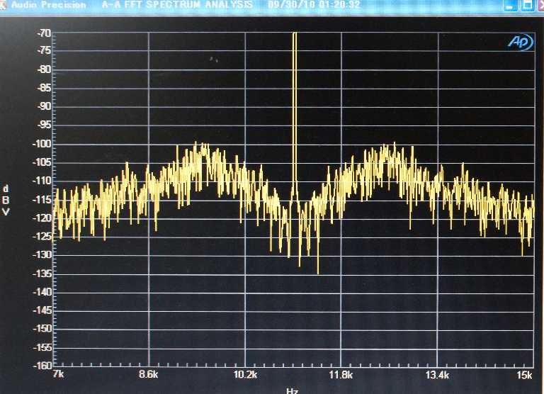

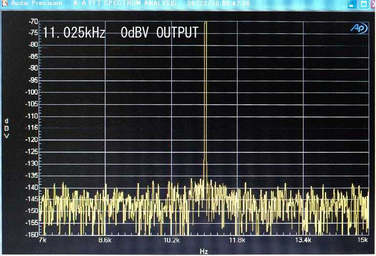

The problem I'm having now is that the Sabre locks onto the I2S audio from the DSP perfectly fine when using an optical input from a DVD player, but...
...If I use the optical output from the PC (tried two different sound cards), the Sabre locks on and plays audio for three seconds, then it looses lock for one second and the process repeats?
The sound cards work perfectly through optical to a commercial amp (even through a very cheap 5 metre optical cable). I tried three different cables with the Sabre DAC and I still have this "lock" problem?
The decoded I2S signals from the DSP board look identical on the scope whether I'm using the DVD player optical output (audio fine), or PC optical output (audio intermittent)?
May I make them sure that;
0. Your Sabre chip is ES9018.
1. You are using sampling rate 48 kHz and data length 16 bit inputs from both your DVD-player and PC interface and does your Denon DSP module output fs=48 kHz and BIT CLOCK = 64 * fs ( 64= 32 * 2 ) for the both DVD-player and PC interface cases?
2. Are those waveforms of BIT CLOCKs and WORD CLOCKs for the both cases almost identical? How are the timings between BIT CLOCK and WORD CLOCK? Are they almost identical either?
I don't think you use BIT CLOCK = 32 * fs ( 32 = 16 * 2) for the PC interface case. However, I just remember that ES9018 only supports BIT CLOCK = 64 * fs.

Effect of master clock oscillator quality
Recently a Japanese manufacturer, Fidelix published an interesting report for the relationship between grades of master clock oscillators and measured purity results for a test signal.
ƒNƒ�ƒbƒN‚̃Wƒbƒ^�[‚Ì‘ª’è•û–@ (In Japanese)
They are now in the final development stage of their DAC product, CAPRICE, that uses ES9018 chip and they say their commercial product will be released within a month.
They tried three crystal oscillators of different grades on the CAPRICE board. Their frequencies were between 90 MHz and 100 MHz.
A test S/PDIF signal of pure 11.025 KHz generated by AP SYS2722 was injected to CAPRICE DAC and its analog output was measured with SYS2722.
Type 1. Fidelix proprietary crystal oscillator with an amplifier of bipolar devices. A DC power supplied for this oscillator comes from a proprietary regulating circuit. A crystal unit used in this oscillator was selected from several samples available in markets. The spectral measurement result shows a very sharp peak.
http://www.fidelix.jp/img/11.025kHz.jpg
Type 2. A basic grade crystal oscillator easily available in Japanese markets (not special, not bad) The result shows an apparent peak broadening and a noise floor raise.
http://www.fidelix.jp/img/11.025kHzb.jpg
Type 3. A junk crystal oscillator
http://www.fidelix.jp/img/11.025kHzc.jpg
They say results in listening just match well the spectral purities measured.
![11.025kHz.jpg](/community/proxy.php?image=http%3A%2F%2Fwww.fidelix.jp%2Fimg%2F11.025kHz.jpg&hash=f97228d0e988334d6f77146c5f1a2d73)
![11.025kHzb.jpg](/community/proxy.php?image=http%3A%2F%2Fwww.fidelix.jp%2Fimg%2F11.025kHzb.jpg&hash=35928fc837f5762cfba40b72bb307c4b)
![11.025kHzc.jpg](/community/proxy.php?image=http%3A%2F%2Fwww.fidelix.jp%2Fimg%2F11.025kHzc.jpg&hash=f90caff19e7c60292207955becafe7e2)

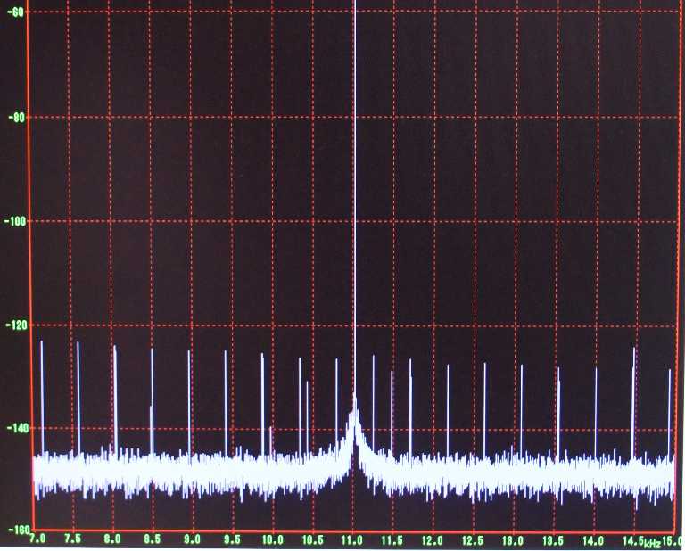

They added a new result measured by PC-based devices. They are surprised that a combination of an inexpensive audio signal input device and a free FFT analyzer program gives a similar result with that measured by an industry standard high level apparatus AP SYS2722. They used "E-MU 0404 Second Edition" sound card and FFT software, WaveSpecrta1.40, for 44.1 kHz analog output sampling.A test S/PDIF signal of pure 11.025 KHz generated by AP SYS2722 was injected to CAPRICE DAC and its analog output was measured with SYS2722.
http://www.fidelix.jp/img/E-MU.jpg
![E-MU.jpg](/community/proxy.php?image=http%3A%2F%2Fwww.fidelix.jp%2Fimg%2FE-MU.jpg&hash=3f6f47c6a951ea8102223ec001e266fd)
A J-Test signal WAV file was stored on a Audio CD disk and the file was played on an inexpensive CDP of Pioneer. ( its master clock was upgraded with Fidelix proprietary one)
It may be worth trying this method to compare your system with various and rich Stereophile measurement results without SYS2722.
The stereo J-Test signal of 16 bit version is available from here.
