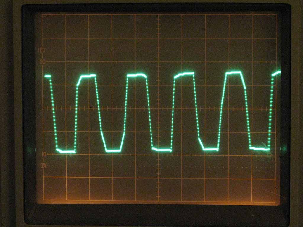

Question 1. Do I have a problem? My BII/Legato plus 4 Opus boards are in the new chassis and sounding wonderful. All of the boards are wired with homeruns (both power and digital). However, because of Brian's comment on buffering I thought I'd peek at the signal integrity into the DAC that is farthest from the I2S source (4.5-5 inches). For this purpose I thought the L-R clock would be fairly predictable (96kHz at the time). The result does not appear 100% clean, because the rising and falling shoulders are not uniformly sharp. I should add that I don't know how clean is the signal entering the chassis. Sound is good, of course. Worry or don't worry?
Question 2. The DAC board from which I steal I2S uses a DB25 cable from a PCi interface card in the computer. I re-boxed the basic DAC circuit board to make room for all the added Twisted Pear boards. I had to use an extension cable (about 9") to carry the main signal into the base DAC board's integral 25 pin connector. I had a ribbon cable on hand so I used it. With the signal routed through the ribbon cable extension - no lock! With the DB25 cable direct into the base DAC board, immediate lock giving the results shown on the scope picture. What am I missing and any suggested solutions for an in-chassis extension?

Concerning the LRCK image, let me add that the larger 'deformations' in the waveform don't change when the scope is following the signal on internal triggering. The only thing that changes is the shape at the very corner of each plateau. Again, your thoughts will be much appreciated... 🙂
Answers to my nonEE Qs
It turns out that my 20MHz scope is too slow to look meaningfully at digital inputs other than something as slow as the LRCK. [No complaints because the scope was free... 🙂] My conclusion is that the small amount of variation I see there is not an issue...
...and even thought the ribbon cable checked out with a multimeter, I suspect that the connections by the perforating 'teeth' were simply insufficient for the likes of PCM. I soldered a nice shielded cable in place and all problems solved.
