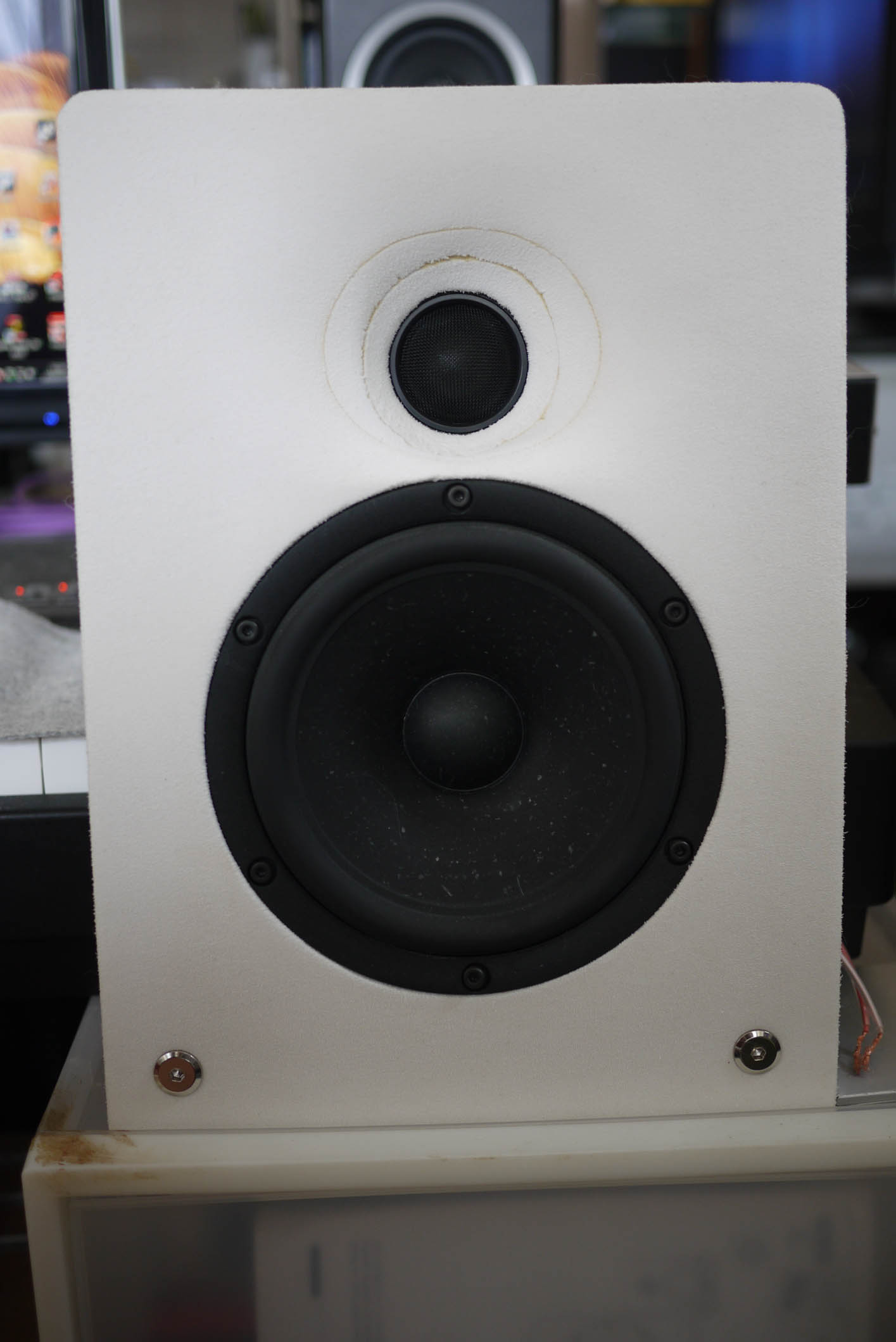

Here are some photos of my 2way satori mw16/rs28f build with EVA foam.
The aim of this particular design is to build a reference level near-field monitor, and I started this design in this thread
http://www.diyaudio.com/forums/mult...oice-8945a-8948a-sb15-sb17-satori-ss8530.html
Since I am designing for near-field use (1-2meter listening distance), it does not need to play as loud as a living-room or mains style speaker.Also the short listening distance means that to get better tweeter/midwoof integration, I wanted to get the center-to-center distance as close as possible but still using a high quality tweeter.
A few things about the design goals
- sealed cabinet with linkwitz dsp transform to give me F3 around 40hz
- rear mount the tweeter to get the tweeter/woofer center-to-center distance at 12cm. With these drivers it means a tiny amount of overlap
- time alignment of the drivers. (physical or DSP time correction)
- small waveguide for treble response shaping and improved off-axis
- LR2 time aligned crossover around 2300hz
I also wanted to do the build with removable front baffle so that I could play around with different baffle arrangements: rear-mount, front-mount, waveguide shapes...

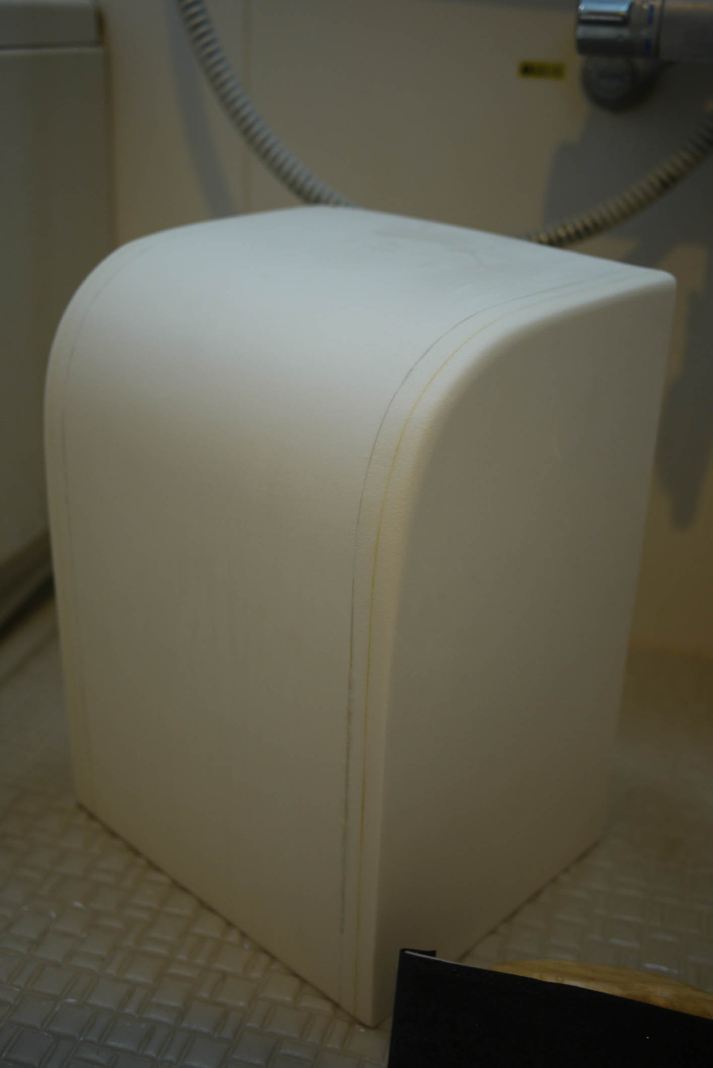

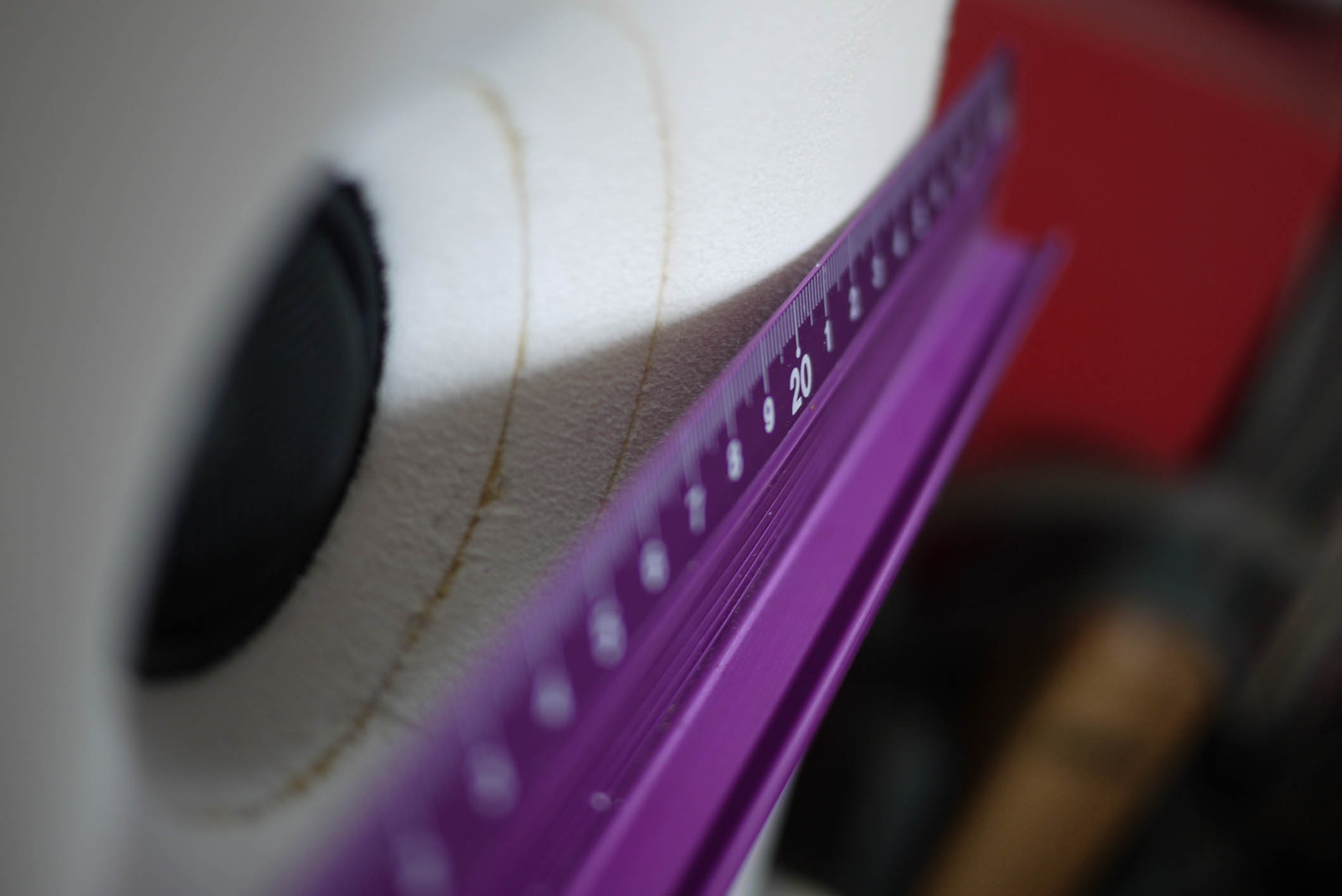

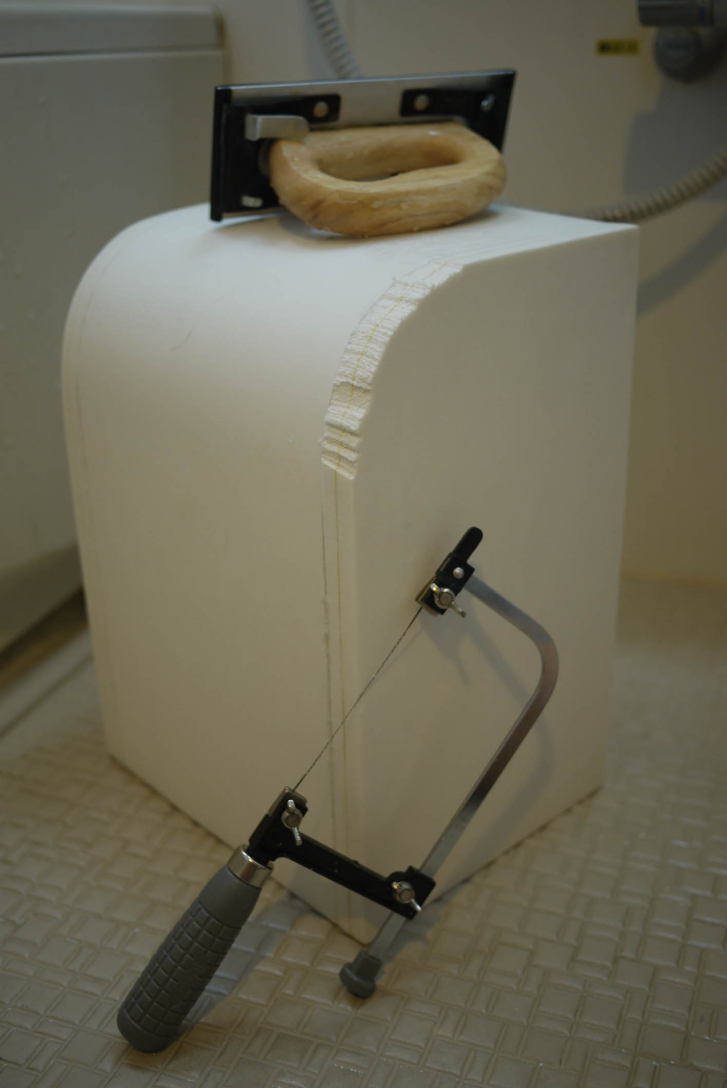

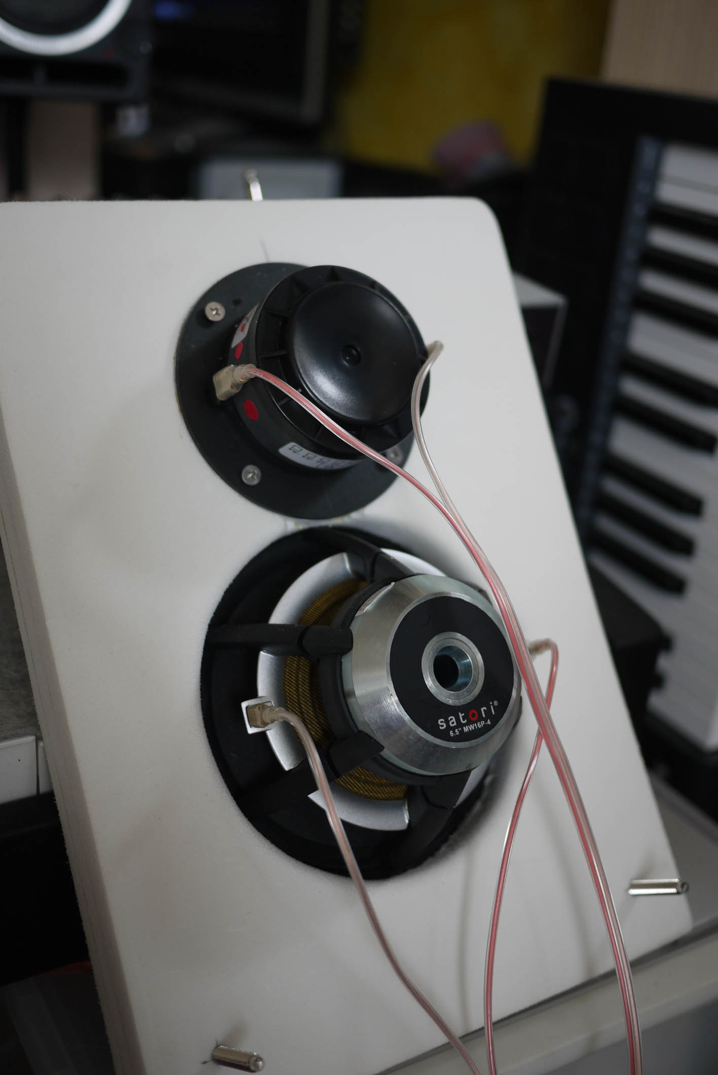

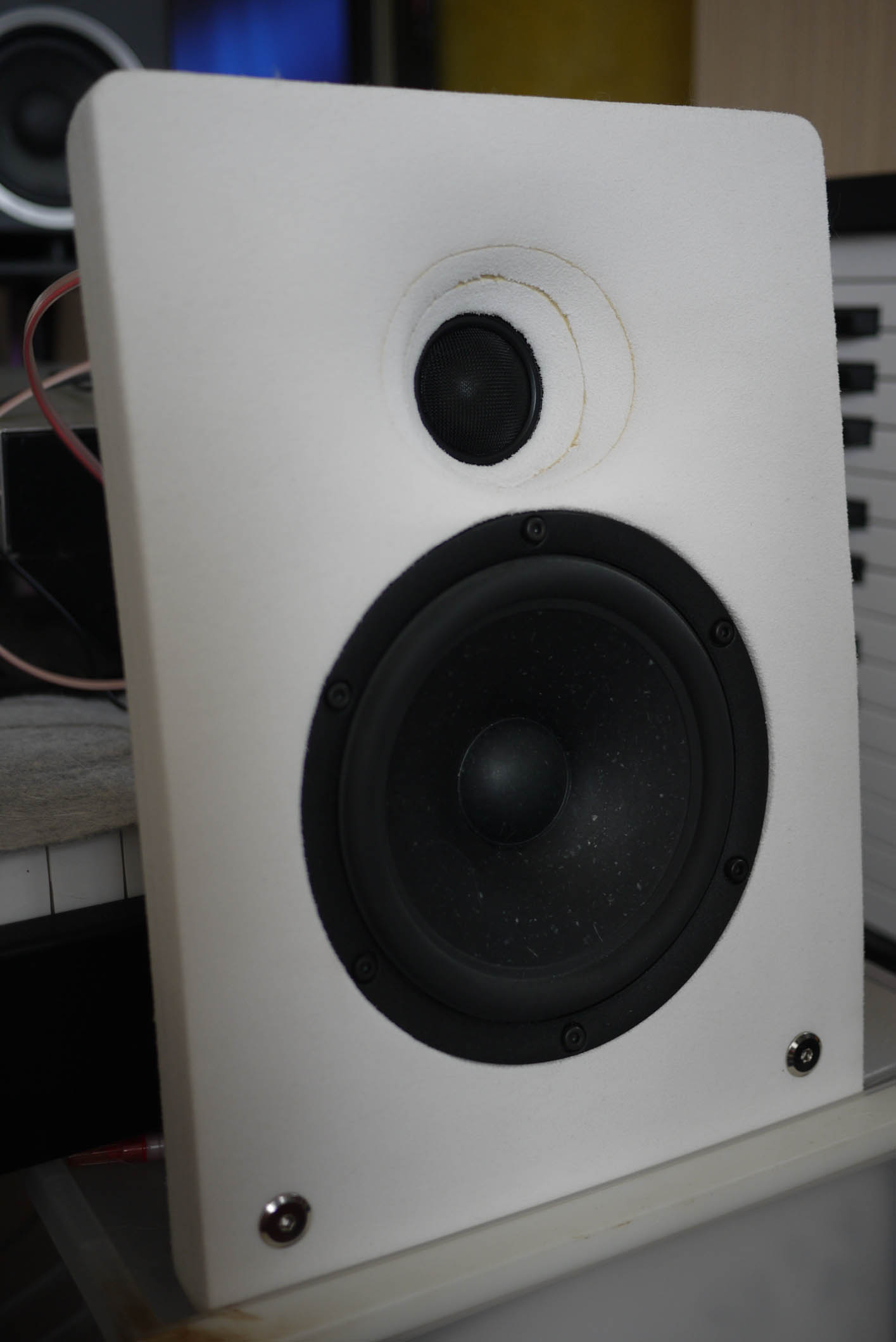

Here are some pictures of the build process. The back and top are a single piece of laminated EVA foam (koyo softboard). I used a jewelers saw to rough shape the sides to the final curve. Then I wet-sanded with 120grit wet/dry paper to smooth the shape.
Here is the current front baffle. 30mm thick built up with 3 laminated layers. RS28f mounted 30mm behind which gives close to the correct time-alignment without needing DSP correction. Waveguide as shaped by hand and adjusted by ear and measurements. Sorry don't have records of this process.
I also tried rear mounting at 20mm which required additional DSP time correction, but I may have preferred the sound of that version. I will probably build another front baffle with the 20mm waveguide shape again.
I will post up measurements later. But I hope these pictures show that an EVA foam build can be made to look good and a high quality of finish.

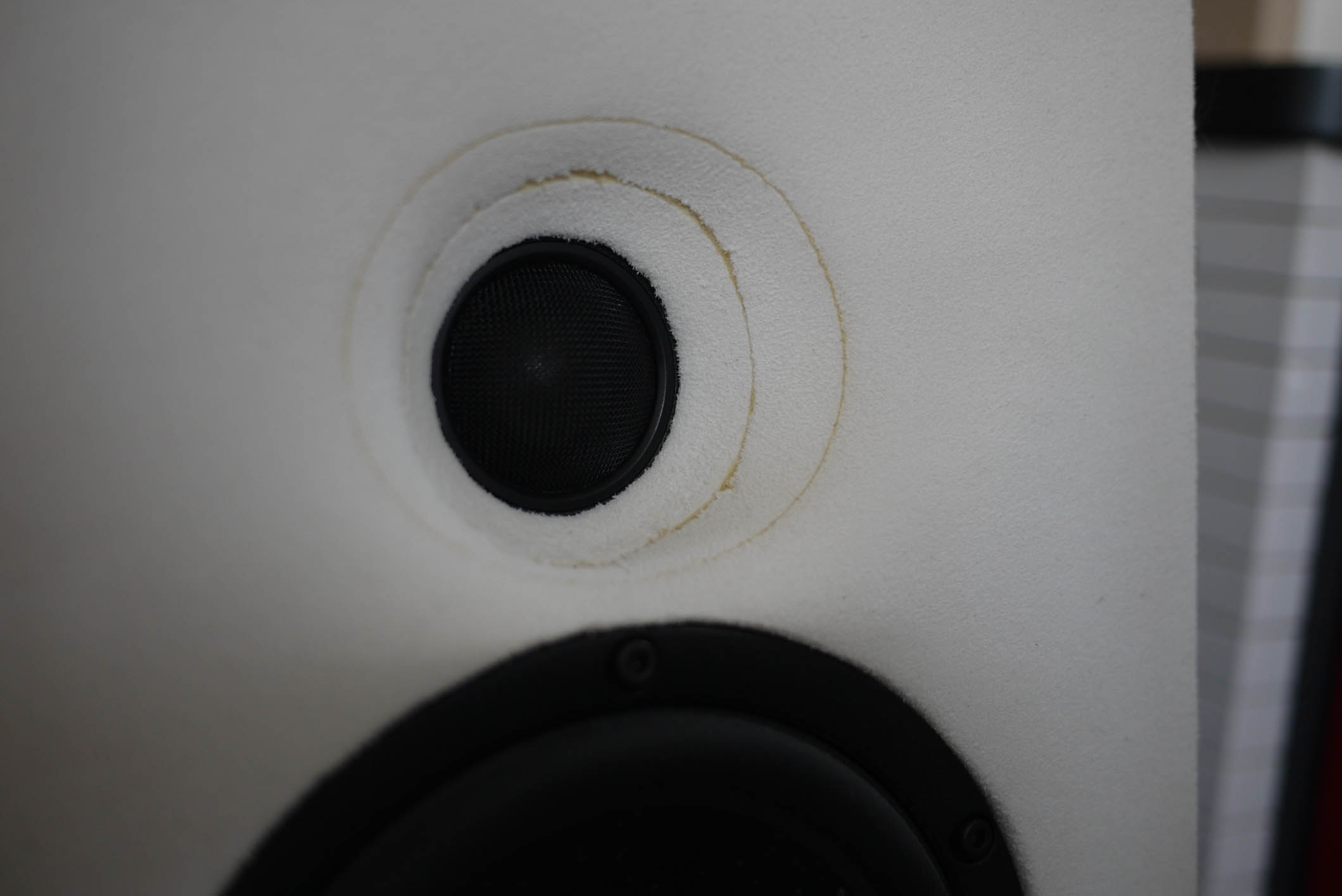

The 2-way Satori MW16/RS28F looks great. The waveguide on the tweeter is very nicely done - did you use something for a template on the profile or is that sort of hand-shaped with eyeball estimate? I like your use of sealed and LT to get 40Hz as I do that too with my 10F/RS225 monitors. You might want to try the new Harsch XO using BW4 for the woofer and BSL2 for the tweeter to get time-aligned, near transient perfect response. I am doing that now on my 10F/RS225 and it sounds so much better than the LR2-LR2 XO.

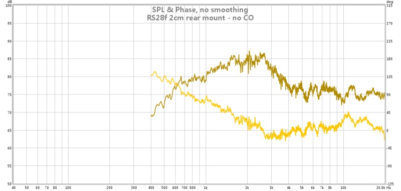

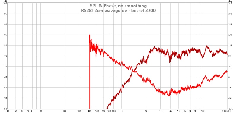

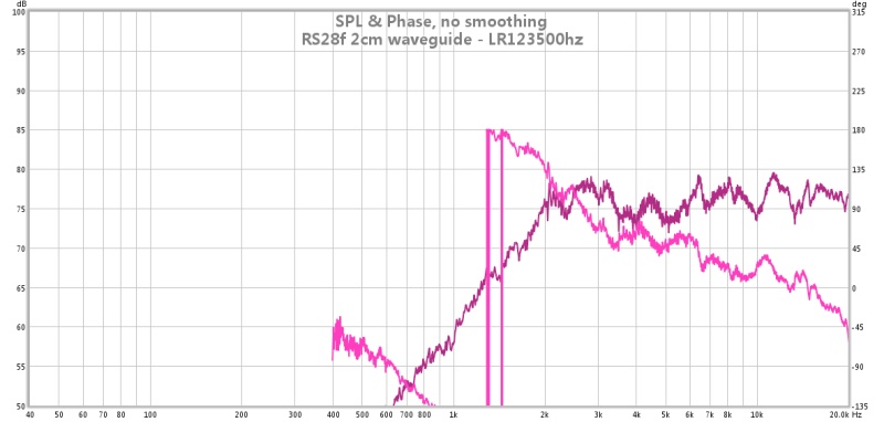

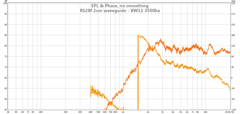

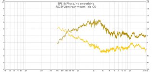

Here are some old measurements of just the RS28f in the waveguide. My notes were not so great, but I think these are from the earlier 2cm deep waveguide version. The current 3cm deep is very similar. I will make some new measurements soon.
And the waveguide is just shaped by hand and "eyeing" it. At some point I want to try a mathematically correct waveguide. But it is fun to hand shape, and the resulting response is pretty good.
As you can see from the response, the waveguide boosts the response and so the crossover must be set high (like around 3500hz) in order to get a final response around the 2300hz cross-over target point
The Bessel response looks very good and is a perfect match for use with the Harsch XO which requires a 2nd order Bessel on the tweeter.
