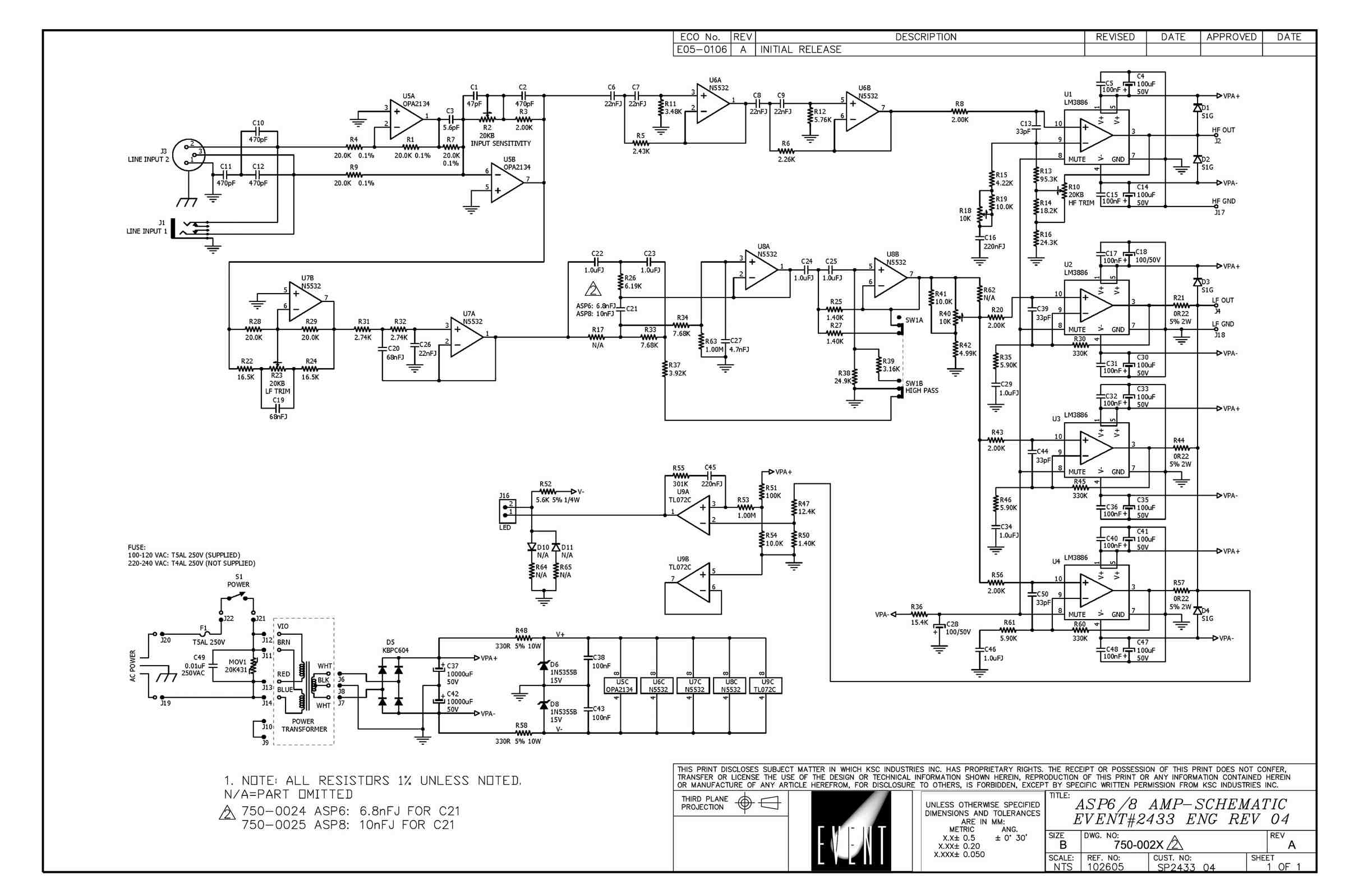

I have uploaded the schematics for the SP6-8 Power amps, these amps are not made well, after the last one blew I may have used them 3 times after, the forth time the second one blew, unbelievable that this company never got sued, well im sure someone here will figure out the week link. My props for anyone who can figure it out.

🙁 Not familiar with these amps but) - looking at the schematic notice that for the low frequency end 3 amps are run in parallel, with a .22 resistor on each one for isolation. If any of the gains (determined by feed back resistors and capacitor) is off, there will be over heating and may be cause of motor boating problem mentioned earlier. Hopefully the service manual would have information for checking this. I would run a low level (around 1 volt out and differentially check the signal across the resistors to make sure all the gains are balanced. As a sidenote - in the LM3886 datasheets national recommends 0.1% resistors for the feed back loops when paralleling outputs. Good luck with these.
hi guys, I have same problem, Pops and cracks on power up and a continously hearbeat on my woofer, (I think on my tweeter too), A electronic friend has replaced 3 woofer chips, but not fix it, anyone can help me? thanks. ASP8
Found the answer today. Check the feedback circuit - on each IC check the resistance between pins 3 & 9. It should be 330k ohms. If if gets higher, like checking a capacitor, the resister is open. The heartbeat is the feedback input (pin 9) floating around trying to find a stable condition - this causes the output (pin 3) thump. These are momentary DC levels, so be careful not to burn a coil.

Look for open 330 surface mount resistors
That's what I found. Steve was also right about the overheating, it was too hot to touch!!
