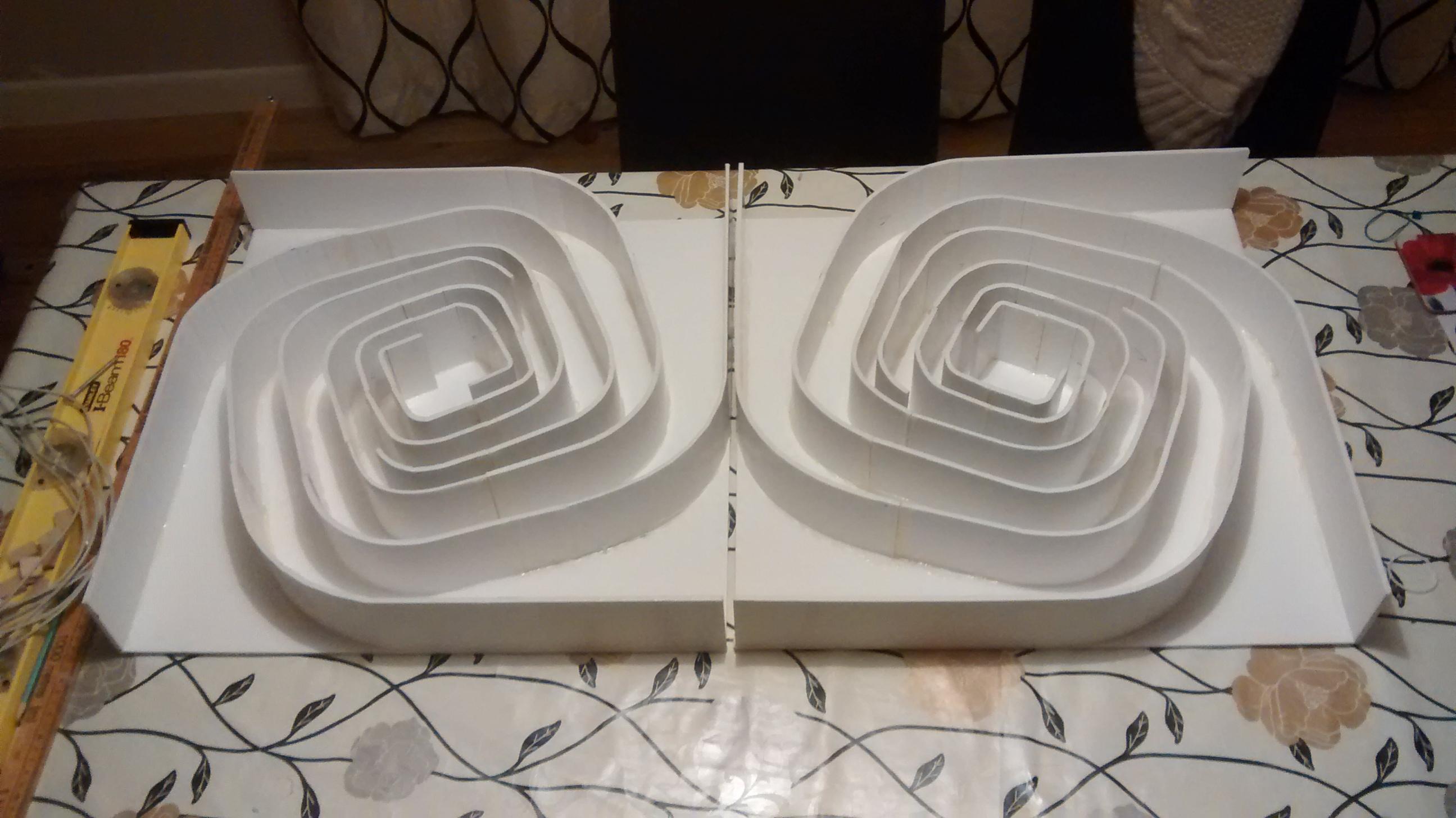

Got the second spiral completed yesterday, went a lot faster than the first thanks to having a completed spiral to take the measurements from for the cutting etc.
Next step is to get the cabling put in place and cut out the driver mounts in the front baffle.

B, thems looking very smart and neat. You will soon be putting sound through them![]()
Thanks, here's hoping I can get them finished soon.

Hi B,
excuse me, what thickness does has the foam?

Hi B,
Hi gmonno, the foam board is 5mm thick.

Guiseppe, The foam most of us are using is 3/16" or close to 5mm
