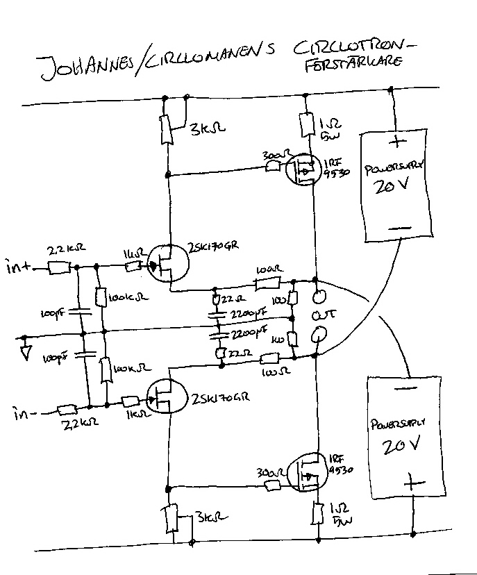

I have designed and built a two stage solidstate circlotron amp without any couplingcaps. It uses 2SK170GR in the input/feedbackstage and IRF 9530 in the outputstage.
Its only giving me about 14 watts a channel but with more heatsink and bigger transformers i could get 50-60 watts.
It souds way better than my zen version 4 i tried prior too this design.
Right now it has current feedback, but it is easely changed too supersymmetry feedback.
circlomanen schematic

Thanx for the help whith the picture!
I would very much like to se yuor schematics. Im very intressted in designing and building circlotrons.
My current design is that on the picture, and it works very good.
Its a klass a/b design and i use 4 IRF9530 /chanel.
ts by far the best sounding amp i ever had. I will some day modify the feedback to susy-feedback and crank up the quisent current in both stages.

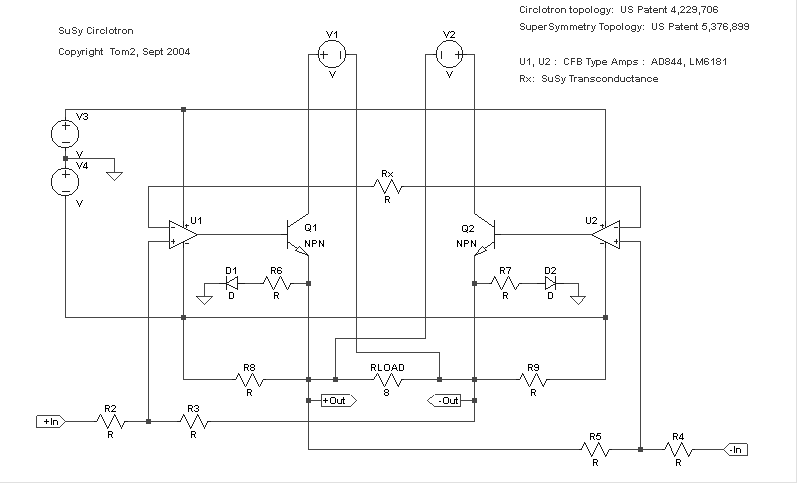

I am trying to figure out your circlotron circuit.
This schematic is just and idea.
It is based on the Borgonio patent.
Please excuse me if my references to intellectual property are incomplete.
Tom2, I think there is a drawing error in your 😎 circuit.
I think the outer ends of R8 and R9 should both go to the earthed junction of V3+V4.
Hmmm... the resistor Rx that connects U1- to U2- can't be left just floating and connecting two inputs; it will have to have some dc connection (even if via a high value resistor) to somewhere.
Also, what is the reason for R6/D1 and it's neighbour? I can sort of see what it is going to do but I can't see the reason yet.
circuit errors
Circlotron thanks for asking.
The circuit is a very idealized representation.
Things like compensation and stabilty are not even addressed.
From what I understand of the circuit, at the quiescent point(no signal input, inputs at zero volts), the outputs across the load sit at zero volts with respect to the ground point of the voltage supplies V3 and V4 for the CFB amps(via feed back action of R2 and R3 or R4 and R5). Thus a potential exists across the resistors R8 or R9 equal to the voltage of V4, thus current flow from the output nodes to the negative supply terminal(V4) through each resistor is equal to V4/R8 or V4/R9. Since the circloton voltage sources (V1 and V2) and output transistors(Q1, Q2) form a closed loop, this current must come from the output of the U1 and U2, thus this is the base current for Q1 and Q2, thus sets the circulating bias current for the circlotron loop. The circulating current is thus equal to beta of Q1 or Q2 times current through R8 or R9.
The negative inputs are low impedance inputs of U1 and U2 because they are CFB amps. You might be right there should be resistors to ground. I was looking at the schematic in
http://www.diyaudio.com/forums/showthread.php?postid=129639#post129639
Post#8 in the Monolithic SuperSymmetry with Current Feedback thread for example.
Also resistors could be added from the positive inputs of U1 and U2 to ground if the inputs are left to float(as seen in other susy circuits).
I think???, the resistor, diode, R6,D1, increases the circlotron circulating current when the corresponding node goes positive with respect to ground. This prevents Q2 from cutting off(since Q1 is conducting more and Q2 is conducting less to force current through the load because of the amplifying action). R7, D2 does the same for Q1 for the "opposite cycle". I thought of leaving them out initially for simplicity. I'm still unclear about their operation

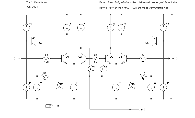

Here are some more SuSy circuits. They use opamps. (I know---girlie chips)
I would call these circuits "inies" as compared to some of the Nelson Pass gain clone supersymmetry design "outies" (e.g. GC-SS-4a).
IMHO the XGC2 circuit also shows a possible way to modify (for example the GC-SS-2a), so the common mode signal input impedance does not look like a negative resistance.
Also something I found recently.
Look at US patents 6,741,129 and 6,717,467. High frequency stuff though.
