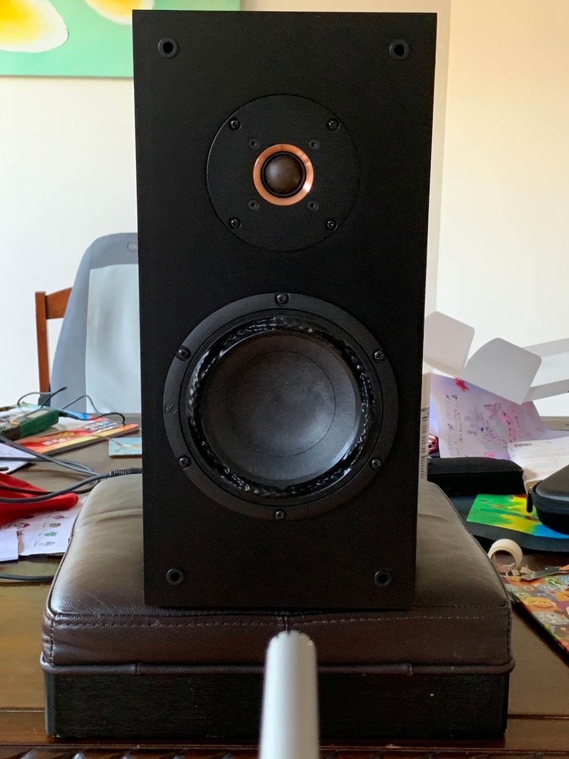

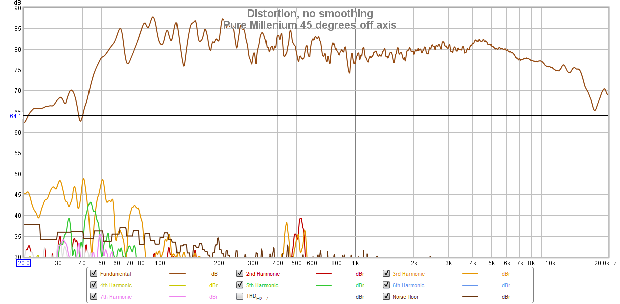

Here’s my build, in a 0.7cu ft (19.5L) box.
Ported, 2.5” x 8.5”
Fb: 39Hz
F3: 38Hz. F10:30Hz
The port is on the longer side, but no longer than what’s needed for the SEAS L18RNX/P, which was previously in this cabinet.
Here’s some measurements- port measurement not included; but the dip around 40Hz indicates the minimum woofer motion; where the rear firing port takes over. One fine sunny windless day I’ll take sound ground plane measurements to validate the anechoic response.
There’s a dip and peak at 2.5Khz and 4Khz due the baffle edge diffraction effect on the tweeter, but it’s not audible as it disappears off axis. If I take a 19-25mm rounding over bit to the cabinet, it will be gone, but it looks ugly IMHO.

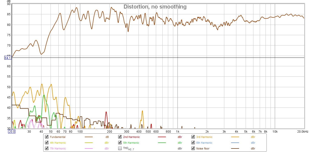

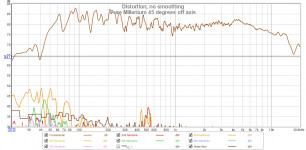

Wow! Distortion is about 55 dB down from 100 Hz, maybe more. Was the mic calibrated for absolute SPL? how far was it from the speaker? or what was the drive level?
- 55 dB is about 0.05% distortion. It's curious that it should be like this across the band. Maybe you can turn up the level so we can actually see the components?

which tweeter is that?

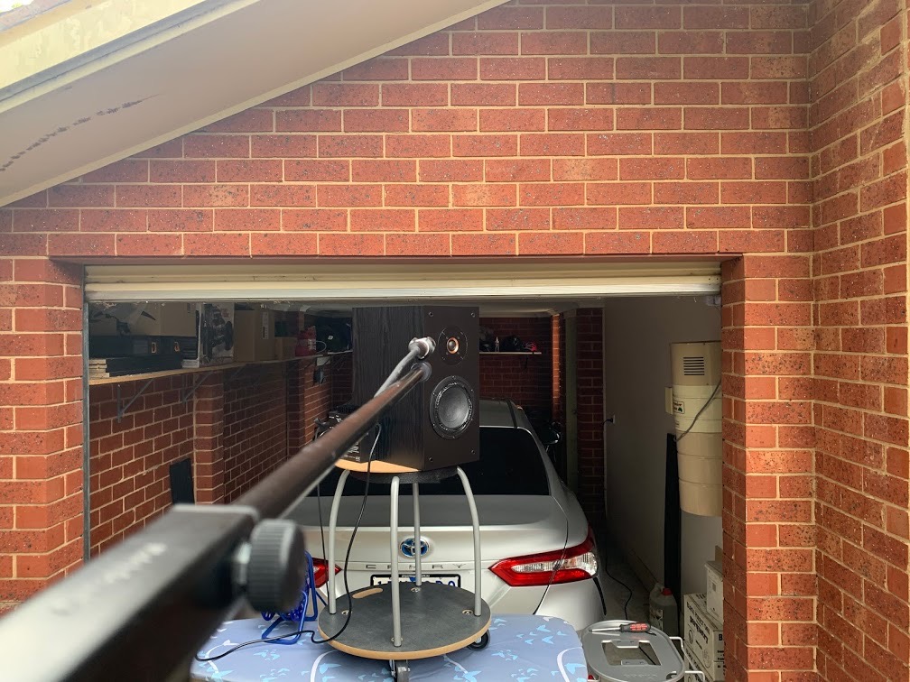

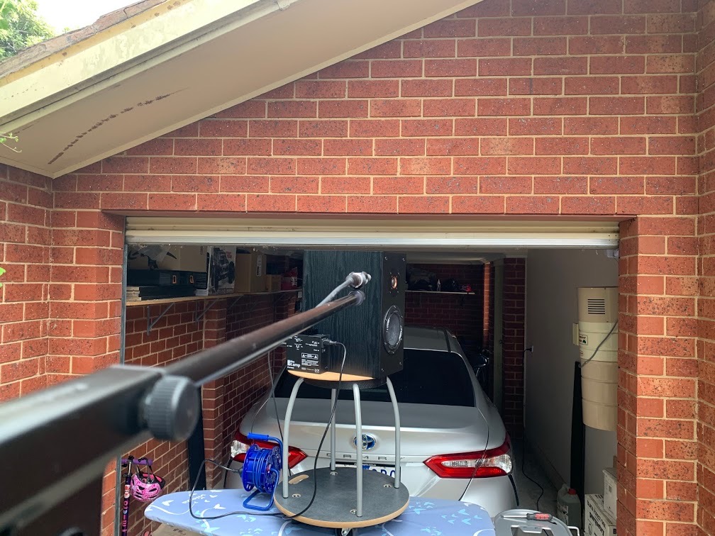

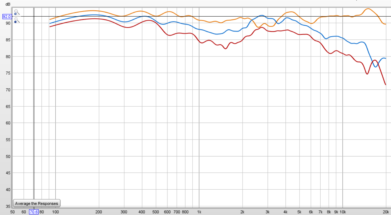

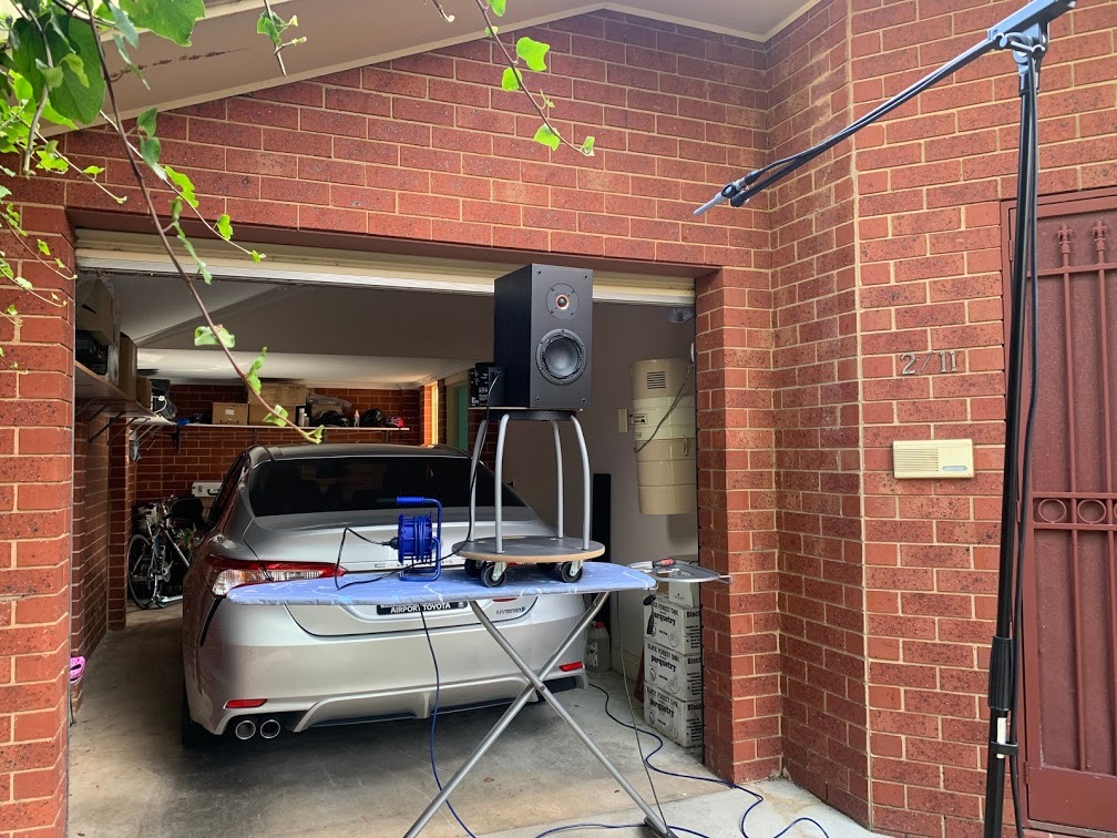

Here is the speaker crossover version 3.
As modelled: 0/40/80 degrees
As measured: ~0/40/80 degrees (eye balled)
Conditions:
Drive level: for SPL 90dB @1m using pink noise
Measurement height 2.00m (laser +/- 2mm)
Measurement distance was taken at slight less than 1m (0.80m) to maximise the window length to 9ms, giving accuracy down to 120Hz
Tweeter is the original SEAS Millennium, T25CF002, something I had on hand.
This tweeter has HIGHER distortion between 2-3KHz than the Purifi.
So I will need to change tweeters to something that can cross low AND have equally low distortion as the Purifi.

Hello Capslock,
Sorry I didn’t save the drive level. The measurement distance was 50cm so it’s fairly low stress for the driver (79dB @1m) because it was an indoor measurement and I try not to bother the family.
So i wouldn’t take it as final representative of 1m or 2.5-3m; which is what I design for.

I agree. The PTT6.5 has lower distortion than any other driver I have measured in this range. Those numbers are all real - it can be used as a low distortion midrange up to 5.5kHz.
