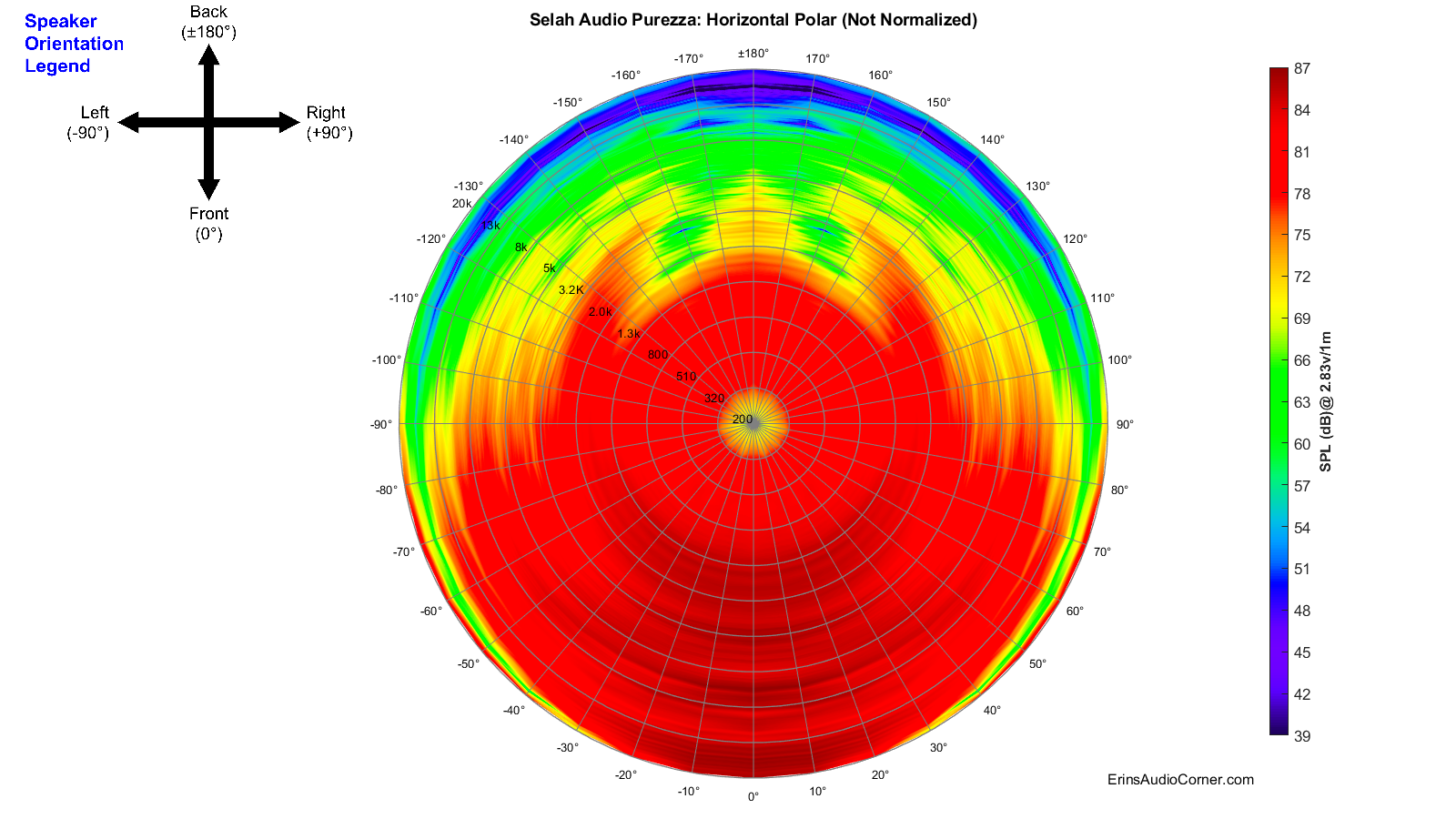

Erin Hardison took excellent measurements- compare and contrast the top two octaves (5-20Khz) of the globe plots of the
Sointuva (Purifi 6.5TT + waveguided dome)
vs Selah Audio Purezza (Purifi 6.5TT + ribbon tweeter)
https://www.erinsaudiocorner.com/images/Reviews/Loudspeakers/Selah_Audio_Purezza/Selah Audio Purezza_360_Horizontal_Polar.png
vs Philharmonic BMR (Scan 18W/8545 + BMR widebander +ribbon tweeter) https://www.erinsaudiocorner.com/images/Reviews/Loudspeakers/Philharmonic_BMR/Philharmonic BMR_360_Horizontal_Polar.png
I don't think the jury is still out on the wide dispersion vs narrowed dispersion "controlled directivity" thing.
As Erin said, it's "reference vs preference" and really depends on your room.
