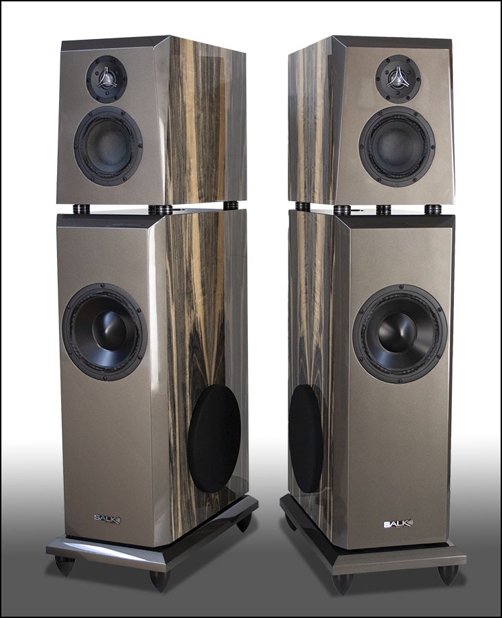

I am considering an active 3-way application with a 6.5 purifi driver and a waveguide tweeter. The 6.5 would operate from 200 to 2k, more or less... I am trying to understand the pros and cons of using the midrange driver with fiber diaphragm versus the midwoofer with aluminum diaphragm. Both look really good. I am just gathering information at this point.
I faced the same question myself and opted for the 6.5 Aluminium, a few reasons whether they help you or not. When notched the Aluminium has the most consistent overall response across all axes and the lowest distortion levels. It is more flexible if I decide to use it in a two way, and it just looks way better to me, I really can't get on with the look of the paper cone. I didn't like what happened to the Mid version higher in frequency, it gets quite a bit wilder higher up. I see consistently in peoples impressions that drivers with extra output beyond the useable bandwidth, particularly that aren't well controlled aren't preferred as much.
The mid does have the higher sensitivity and if that can be used in the overall design that is something to consider. My view was that the Aluminium was so linear that I could just pump more power into it as a mid in an active system and not really lose anything. There are some hints in Troels Purifi Tower build that there is something better about the mid version for pure midrange, but the datasheet from the Aluminium lists uncompromised midrange too
It's always nice to hear peoples impressions of the sound but the implementation matters so much in the overall result I can only imagine that the comparisons would be more apple to orange.

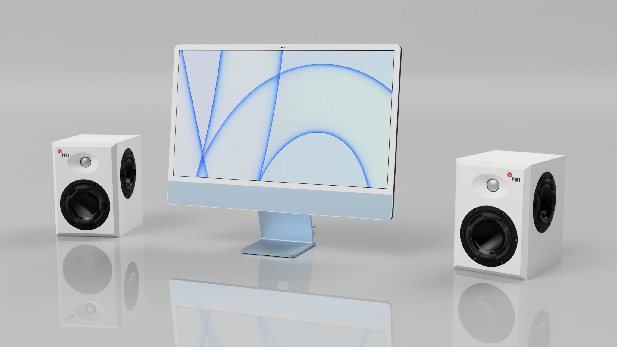

look nice nano speakers with a 19 or something planar, perfect for my pc with a ACAmini!Hi Lars,
