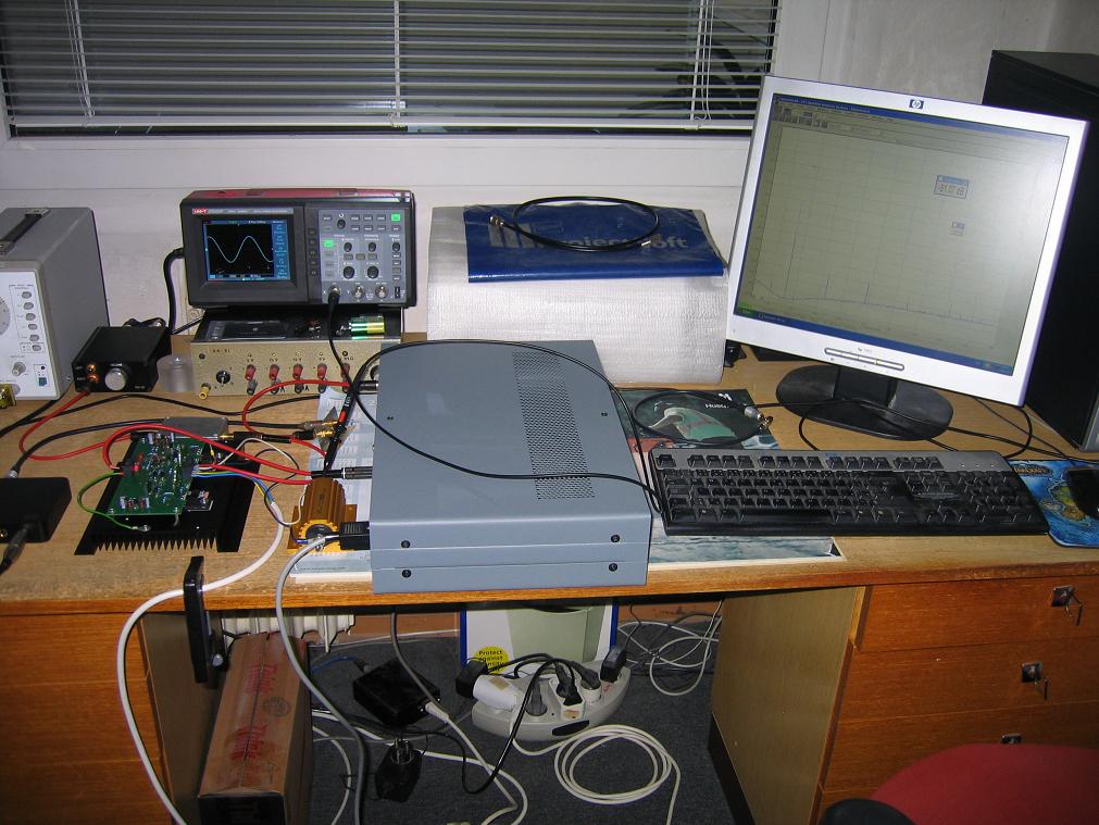

here is the story. One of the great classical music lovers here had decided to use the ExtremA for a tweeter section of his BIG 3-way active speakers. He bought the modules and another guy assembled them for him. However, they did not reach as good measured parameters as you did and they also had some power supply line mess in their measurements. I suspected a possible measurement issue – you know it is not that easy to measure a piece of audio like this – and possibly sub-optimal wiring. I started to play with the circuit in the simulator and became very curious. My curiosity was concentrated to the output stage, as I have never achieved better results from any other output stage even in simulation.
So I have decided to build your output stage, with current limiting parts (2 transistors and 2 diodes) omitted. I have decided to build a single ended version only, and to check it both outside feedback loop and inside feedback loop, an opamp (OPA627) was added for this purpose. But I was mostly interested in the behavior of the output stage outside the feedback loop, to understand how the output stage behaves in isolation and in reality, not only in simulation.
The next step was to develop a measurement method. My current measurement has ended just a bit below 0.001% THD, which was insufficient to measure ExtremA. So, I have build a measuring system with 2T notch filters (tuned at 1628Hz and 6760Hz, not intentionally exactly these numbers, but part tolerances just resulted in this) and a measuring amplifier with volume regulated by input Alps potentiometer to set appropriate measuring level for soundcard input. With this setup, I was able to get clear measurement spectrum with sensitivity of -130dBr of the individual spectral components. Then I added a correction on 2T filter amplitude response and created a protocol template in Excel.

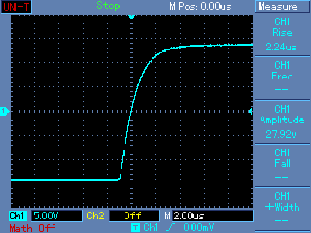

With ExtremA output stage in FB loop of the OPA627 (overall gain 26.18dB), I got these results:
1628Hz, Vout = 3.536Vrms, Rload = 6.8ohm, THD = 0.00014%
6760Hz, Vout = 3.536Vrms, Rload = 6.8ohm, THD = 0.00038%
Then I measured the output stage in isolation, outside feedback loop, with auxiliary preamplifier (40dB) inserted in front of the ExtremA output stage. The output stage has so low distortion, that it was almost impossible to distinguish its distortion from the distortion of the auxiliary preamplifier.
Results:
1628Hz, Vout = 7.42Vrms, auxiliary preamplifier only, THD = 0.00048%
1628Hz, Vout = 7.42Vrms, Rload = 6.8ohm, preamp + ExA output stage, THD = 0.0006%
The only added distortion with the ExA output stage was at 3rd harmonic line.
Attached is a measurement protocol with OPA627+ExA (in FB loop) and a step response, and a photo of outside-loop measurement setup.
