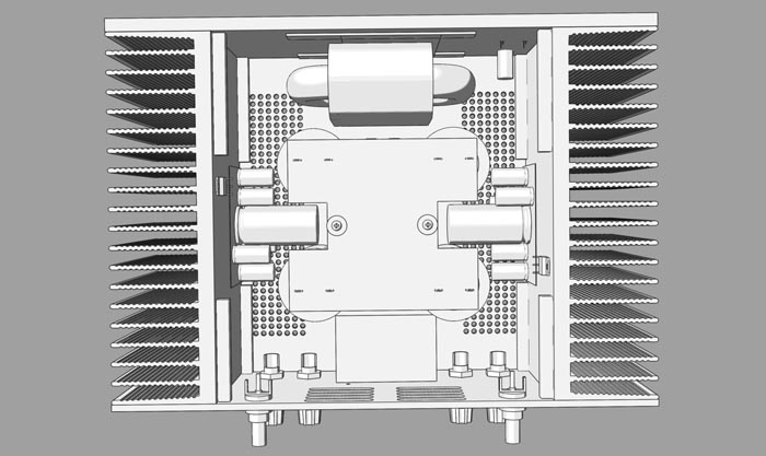

Hi guys,
I'm collecting parts to build my F3, but after reading umpteen posts on the Power supply i'm more confused then ever.
Is 300VA 18+18 V toroid or Rcore ok for powering both channels ?
Here is a rendering of my proposed layout, to scale!
Heatsinks are from Mali Elektronika, HR-245 rated at 0,25ºC/W
( 300x150x83 ).
The big PS Caps are 15000uF/63v superthrus.
The output cap is a 15000uF/63V 4pole Jensen.
The diode bridges are MURs bolted to the bottom of case between the PS Caps.
Apart from clearing up my doubts on the transformer any other coments are more than welcome.

power consumption is 200W for stereo ;
for that - you need at least 400VA xformer .... ( one xformer for both channels)
heatsinks - 0,25C/W - seems enough

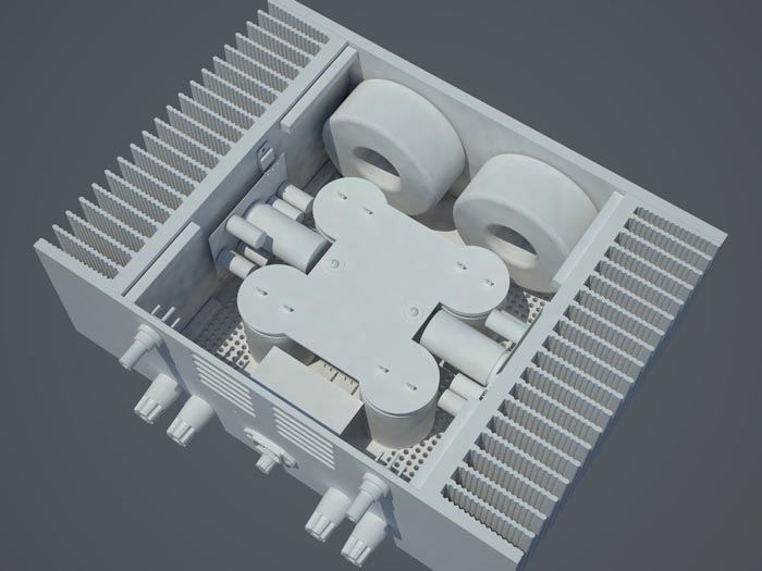

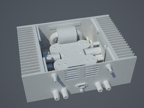

Here is a pic of 2x 225VA i found at Selectronic.....they fit nicely.
Luis...it seems we will have 2 F3 here in Lisboa.
